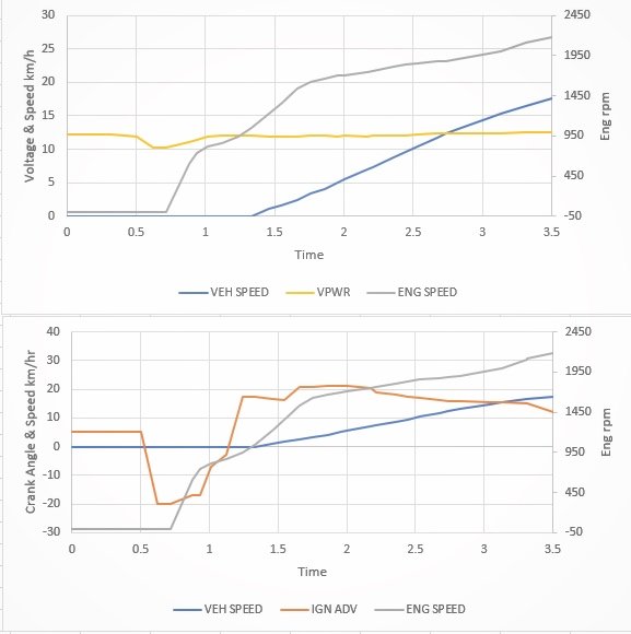

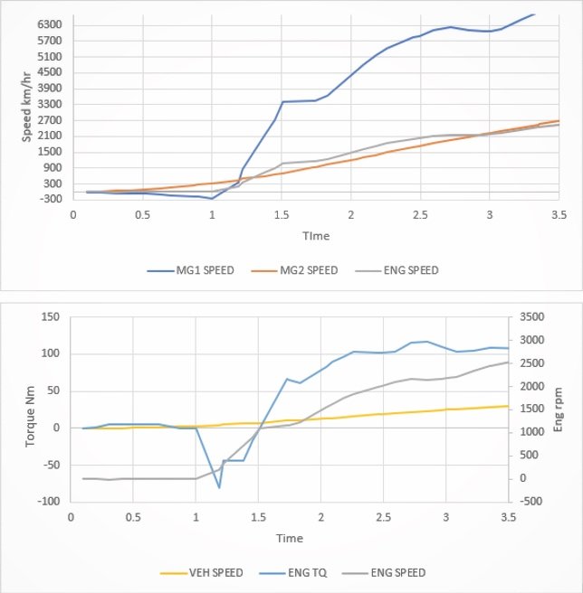

    Cool plots.
    Prius has 0 engine torque at 1000 rpm after 1.5 sec with a total elapsed time of 0.5 seconds until engine is making torque. The MG1 speed is driving the engine with no load on it providing oil flow.
    The tundra engine looks to take 1 second to start. This is interpreted as the time between the 0 engine speed and when engine speed hits 950-ish and vehicle speed goes above 0. The moment there is engine speed indicates starter engagement and then at some point spark ignition. Engine timing isn't the parameter that determines engine firing. When there is cylinder firing the loads on bearings increases substantially vs freewheeling with mg1 as in prius.
    The engine torque in case of tundra has a larger total gap to overcome to move vehicle. So the engine load is increased higher than the Prius (which can move under MG2 in many circumstances). The timing curve also shows an increase in advance indicating the system is quickly trying to increase engine torque. This reaches a peak right near the point when vehicle speed takes off.

    You’re right, spark timing isn’t a really good measure to gauge starting but voltage is. Tundra battery voltage goes to 12V at 1.0 sec when starter shuts off, so engine is firing. Start time is from when the starter engages until it disengages. Prius engine is also firing since torque is becoming positive at 1.5 sec mark. Both are trying to fire for that half second.

    on a second and third look at the tundra, that cranking cycle is super short actually. If you line up the voltage, to where the timing actually starts to increase, it is very short. It looks like about .25 seconds. I'm measuring from zero engine speed to about half way up the engine speed curve (apprx 0.75 mark.).
    Basically the ignition timing is retarded heavily during engine cranking (fr various reasons). Then you see timing increase as the system is trying to increase engine rpm past the engine stall speed (typically that is around 400-500 rpm)
    So the cranking portion, where loads are smallest, is very small batch of time.
    The rest of the upswing in rpm is from the engine reaching state of firing on all cylinders.
    What is beneficial here and maybe "the magic" is the timing curve seems to be very muted until full engine idle rpm is reached.
