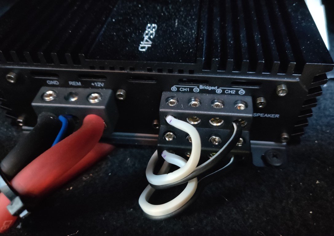

    I wrote this whole long thing and lost it because I’m doing this on my phone and I suck. If there are 4 wires coming off your amp, I’m confused. Your crossovers don’t accept two inputs, only one set. So... where are the other two wires hooked up?
    Text me and we can get together to look at it again and figure out what’s what. I’m sorry if I steered you wrong with Rick. He has always steered me 100% right and has a stellar reputation. Don’t know what’s going on there. But we will get you right.

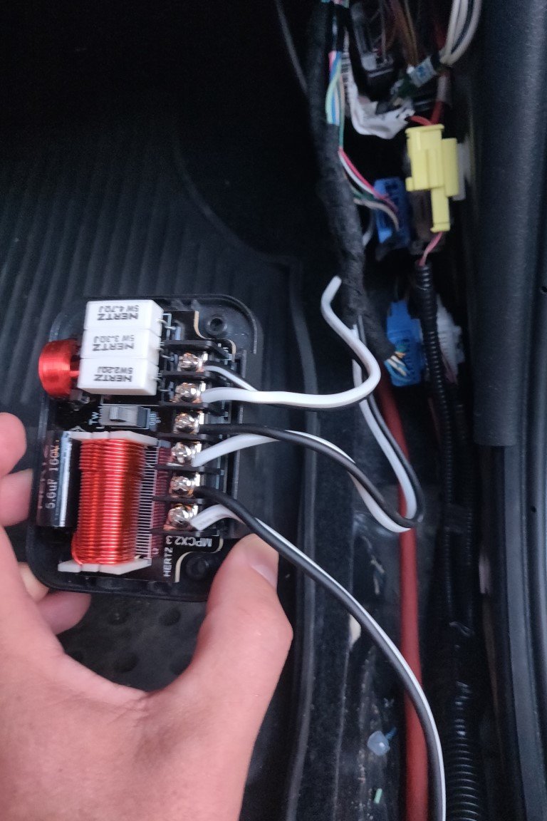

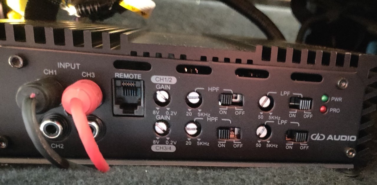

    You need to not listen to anything this shop is telling you. There has been some very accurate advise given here and you problems are with that shop! It is very easy to foul things up if you don't have a clue, and they seem to have been fouling up at every turn while making you pay for their experiment. Our trucks do have natural phase issues given the layout and their locations. Also the megal-pastic grilles cover 75% of the output of the speaker. You have to resolve this 1 issue at a time in order to be sure you actually address the problems.
    1 All wires to speakers need to be polarity confirmed.
    2. All wires to crossover (you definitely need to use the Hertz passive x-overs) must be confirmed.
    3. All settings set to off. Then 1 by 1 confirm that you are not redundantly crossing over channels. (You should not have the HU and the amp x-overs being used... 1 or the other. I usually set the amp to full range if the HU has all the processing in it and accessable.
    4. THERE IS NO NEED TO BRIDGE YOUR AMP!
    5. Start with the suggestions above for set points and just set gains first. Shut the sub and rears off and just start with the fronts. Get just those to sound right, then add the sub, then the rears. In a properly installed system, fronts and a sub will blow you away. I find the rear speakers are half out of phase with the sub and will be very difficult to resolve without time-delay. Shut them off to get the right levels up front.
    6. Most important... You must have a reference source/track/cd that you absolutely know what it is supposed to sound like. (Use headphones for a layman's reference). This will actually allow you to tune in the right direction!!!!
    7. Make small adjustments, and be patient. I have about 100 hours of tuning into my truck. Many of those hours I'm just listening to certain aspects of the system. For me, I'm cursed with hearing every little anomaly from track to track... and I want to fix it. But sometimes fixing 1 issue will create another... the truck is a horrible audio environment and you get it as good as you can but almost never is it perfect.
    8. All of the tuning is dependent on a verified and professional install. (Professional meaning everything is hooked up correctly and installed as desired). You can verify everything and simplify it to make sure you are listening to as pure and minimally processed music as you can. This will hopefully help you get closer to enjoying your system.

    I would by everyone a round of drinks if I could, thanks for all the input! It appears I am in 2-way mode, when I looked last night, it was greyed out, but realized this morning that's b/c it is set to that. I checked all the wires I could, polarity/phase should all be fine.
    @Rubberdown - I did not state correctly, there are just 2 sets of wires coming off the amp (I meant 4 individual) so we should all be good there. And don't sweat it, Rick was super awesome, the shop owner, not so sure about. The fact that they tore every piece of crap wire out from the other shops and wired it right was 'almost' priceless. I am just upset that I got upsold on this $700 amp I didn't need, then was replaced with a more powerful model, but not worth $700.
    @Toyotoholic - Thanks! After checking everything, I turned the HP filter off on the amp and set all HU to 80hz - it didn't really sound great, but I could barely notice a difference. I switched the amp HP back on for now. And dang, 100 hours of tuning!! I don't have that in me, I am a total amateur. I just need to get this thing set right and move on..

    If you're using the passive crossovers for your mids and tweets then the only crossover setting you should have active is a high pass (HP) for your mids. I'd use the head unit's at 80 hz as a starting point.
    Some other tuning suggestions would be to
    -set your eq to flat
    -bass boost off
    Basically turn off all setting or set them to zero.
    -set each speaker level to 0 for now except the sub level.
    Your Kenwood should been clean all the way to max volume, but I'd recommend not going passed 80%. When its time to adjust gains do it at that volume. That is now your max volume. This could help with any unwanted noise and it leaves you some head room for eq adjustments later on.
    For your sub channel. While nothing is playing see what the max and min volumes are on the head unit. Many head units will have something like +7, and -10. Basically you want to figure out the neutral level. The true zero. In the above example the true zero is actually -1.5. This will give you a better idea of how much you're boosting that channel and it gives you the proper volume level to start adjusting from.
    Your gains can be set by ear. There are some really good vids on YouTube that will get you pretty close.

    You could actually unbridge your channels and then you would have two channels for your rear mids. That amp is a damn fine amp and its powerful. 250 per channel at 4 ohms. Bridged that about 500 watts per channel.
    Double edit:
    Correction, its 700 watts x 2 bridged.... Hot damn thats a monster amp.
