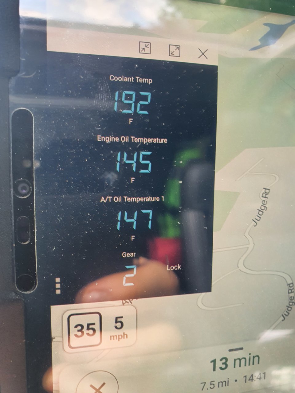

    An OBD reader makes it a much easier process, I have the OBDLink MX+.
    pursuit2550 likes this.
  8. Jul 7, 2022 at 7:38 AM
    #98
    Part_time
    Part_time Not a new member
    Dec 24, 2017
    #11717
    1,447
    Oregon
    2017 MICA BRONZE SR5
    Will it give you transmission temp?
  9. Jul 7, 2022 at 7:44 AM
    #99
    pursuit2550
    pursuit2550 New Member
    Jul 29, 2020
    #50029
    2,277
    Florida
    If your talking about the MX+, yes. Trans temp and converter temp.

    Yup amongst many other things torque converter lockup

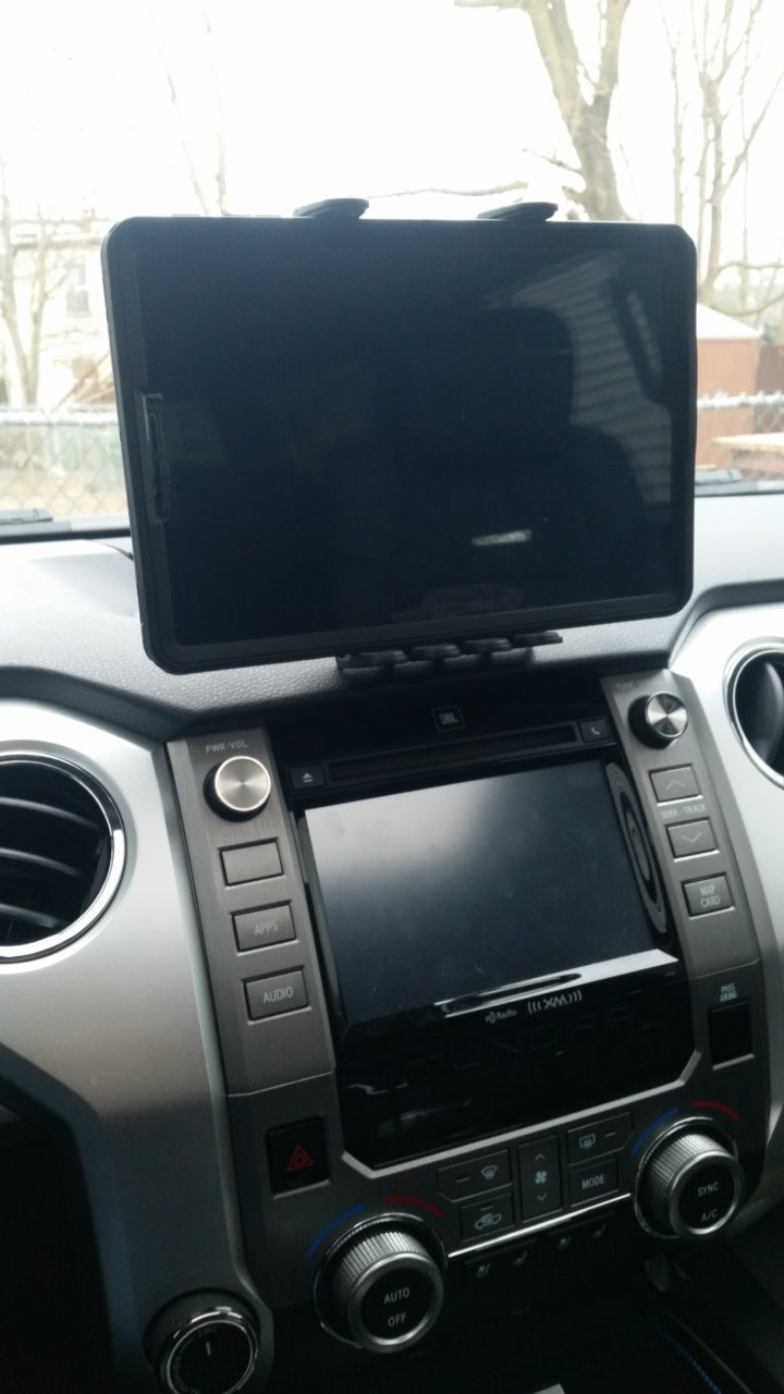

    What is that? The radio, a tablet? Zoom out pic.
  16. Jul 7, 2022 at 3:43 PM
    #106
    Joe333x
    Joe333x Member
    Apr 4, 2019
    #28632
    1,897
    Boston
    2019 Tundra CrewMax Platinum
    Tablet
    pursuit2550[QUOTED] likes this.

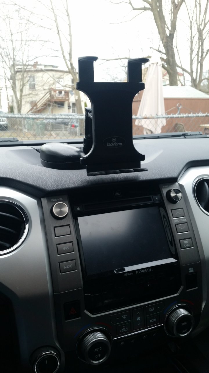

    How does that tablet work?
  24. Nov 26, 2024 at 2:36 PM
    #114
    Joe333x
    Joe333x Member
    Apr 4, 2019
    #28632
    1,897
    Boston
    I don't understand your question
  25. Nov 26, 2024 at 2:39 PM
    #115
    parkerbows
    parkerbows New Member
    Apr 7, 2019
    #28783
    730
    Jack
    2017 crew max sr5 trd off road
    Firestone air ride air bags
    Sorry how is it attached to radio? Bluetooth?
  26. Nov 26, 2024 at 6:23 PM
    #116
    Joe333x
    Joe333x Member
    Apr 4, 2019
    #28632
    1,897
    Boston
    Oh yes, Bluetooth usually but I also have a 3.5 jack I can use on it as well.
