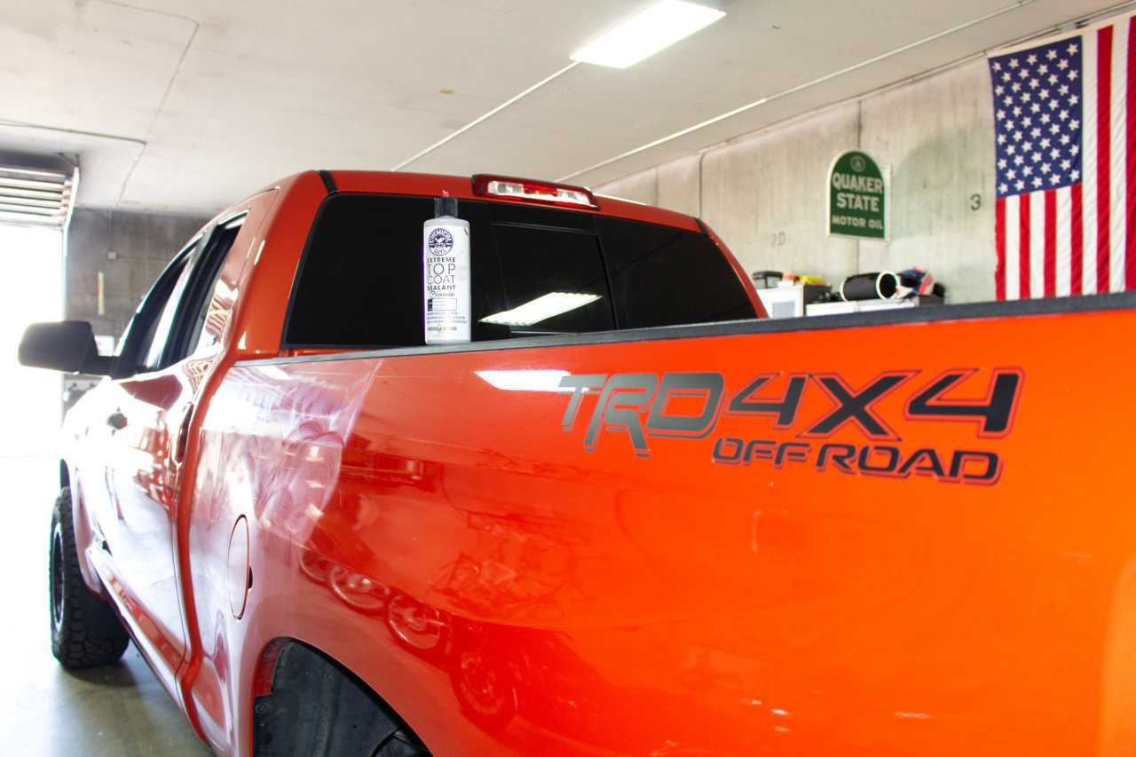

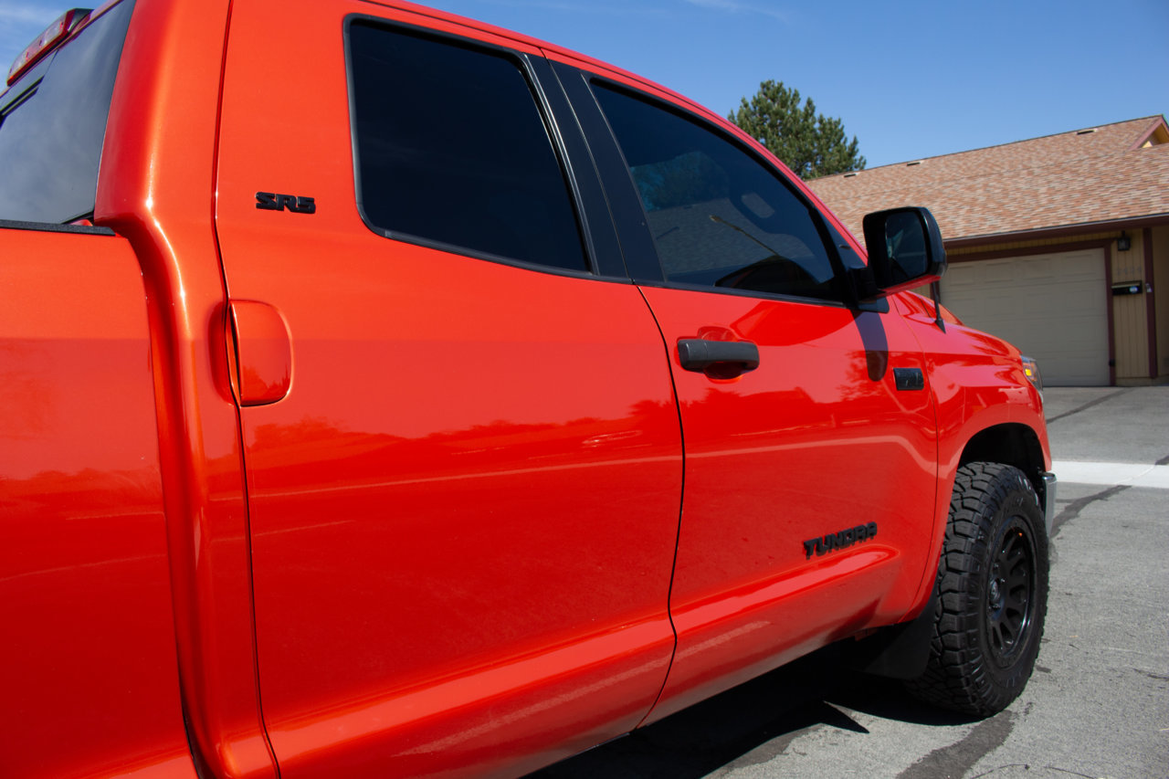

    First time doing a wax on the inferno,
    Stripped the truck with dawn, clay bar from CC and I used their synthetic quick detailer for lube because summit was out of their actual clay luber.
    I applied CC Extreme Top Coat with microfiber applicators in circles, shown in pic 2.
    Let it sit for 15 minutes than buffed away. The truck was left with more swirls and minor scratches than I expected to see after the coat, making me think I may have missed something.
    Can someone provide insight as to if I did something wrong or if I should add extra step next go around?
    Overall, I am extremely happy with the color it brought out of the paint and it gave me that burnt orange look I was looking for.

    You would need to compound and/or polish to remove swirls and scratches. Clay can add micro scratches sometimes too.

    X2 with pudge but don’t use cg products to do it. There are much better products at pep boys or autozone. After corrections I would recommend a sealer that you could spray on and wipe off with some good mf towels. If you chose to go this route hit up the thread and we can get more specific.

    Do you think a aio would do the trick in this situation?

    I would have to see the paint but its certainly possible

    That was my thought. It’s a little unclear if the scratches already were on the paint already or if the posted process was the culprit.

    Microswirls from claying? I’d imagine an aio will take those out no problem.
