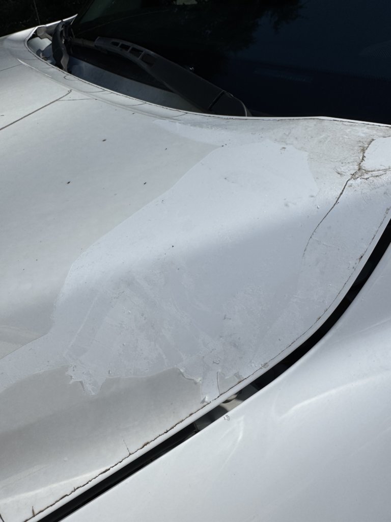

    Take it to a shop that does wraps and ppf. They will provide the best feedback, but your paint may already be affected even if they can remove the film without affecting the paint more.
    This is on my current worries of getting the ppf replaced before it gets to this stage. I really wish you luck, let us know the results and share pics if you are willing of before removal, post removal, and if they add new film back.

    One quote I’ve gotten was a sliding scale between $300-500. I’ve watched some YouTube vids on it and may try a couple of those ideas. We rotate onto saturdays next weekend so I can work on it at the station if we have a slow day. I’ve also given thought to just having my body shop guy look for a used hood and paint it and swap them out. I will post up whatever I decide.

    That's good advice. To answer your question....there is no 'best' way I'm aware of for removing PPF that is in that condition. Situations like this are just one of the reasons I dislike PPF.

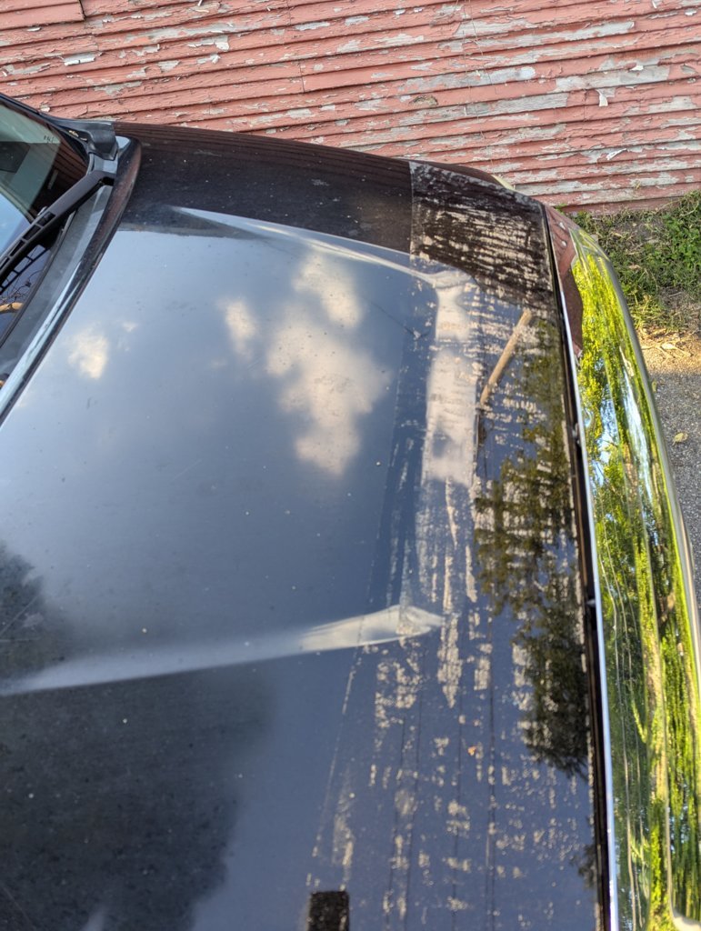

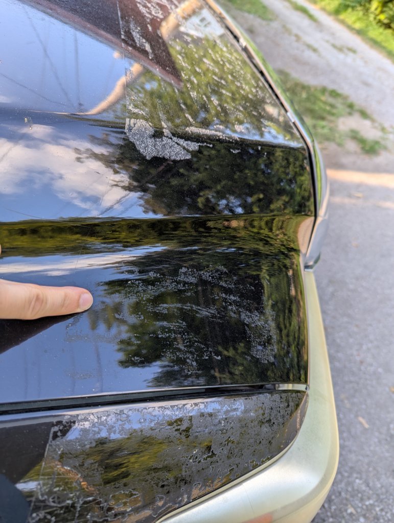

    I am in the same situation with peeling hood PPF. I tried GooGone in a small spot and that took a fair amount of it off. I left the GooGone on for a few minutes in the sun, scraped it off with a old credit card, and washed it all off with dish soap & water. TBD if that messed up the paint or not. I'm not going to try more until I see what happens, nor am I recommending this right now.

    A few weeks ago I used a towel and hot water on a 90+ day to try and soften it up, then peel it slowly using a soft putty knife to start it then peel it by hand. GooGone for the adhesive residue. This spot took about an hour. We went through a move and I haven’t time since. Not sure what I’m gonna try next.

    Oh man, you've got quite a bit more than me. Mine is just near the front. A lot of it has peeled/chipped off already but some of it's still there and other parts are just the adhesive residue. My finger is pointing to where I tried the GooGone, but I was conservative with the scraping and didn't get all the residue.
    Well done getting that much off though. It's time consuming for sure.
