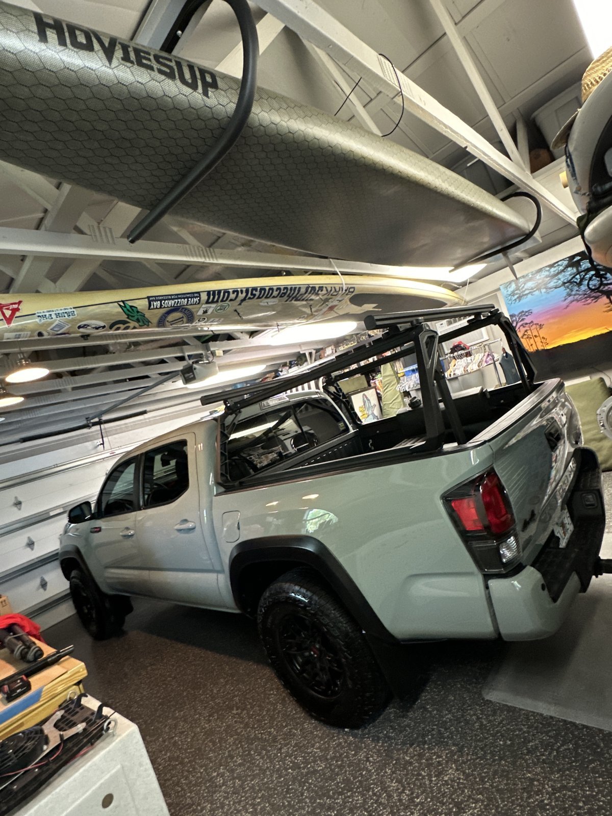

    TheHutchTTU
    TheHutchTTU Wreck 'Em
    Jan 11, 2020
    #41072
    55
    North Texas
    2020 Midnight Black Metallic TRD Pro
    Are those from sunscreen?
    Sundog likes this.
  2. Jul 22, 2024 at 8:44 AM
    #5342
    ToyotaTundraMike
    ToyotaTundraMike Not A New Member
    Dec 14, 2015
    #2256
    2,156
    2015 Tundra
    Not sure what it is to be honest. Whenever I picked up my truck a few weeks ago they detailed it and filled it up with gas before I left and these fingerprints were left behind. By the time I noticed I was back home nearly 100 miles away.
  3. Jul 22, 2024 at 8:46 AM
    #5343
    eddiefromcali
    eddiefromcali New Member
    Mar 14, 2022
    #75818
    3,254
    Eddie
    2022 Tundra Platinum
    100% Stock
    might be polishing product. Have you tried un/diluted all purpose cleaner?
    ToyotaTundraMike likes this.
  4. Jul 22, 2024 at 9:50 AM
    #5344
    T-Rex266 [OP] Fuck Cancer Staff Member
    164,664
    You can try IPA, or just a quick polish that I bet would take it off, whatever it is.
  5. Jul 22, 2024 at 11:54 AM
    #5345
    Bama
    Bama Member
    Sep 25, 2018
    #19820
    161
    2016 MGM Tundra 2015 MGM Sequoia 2014 LX
    ...or remove the vinyl wrap.
  6. Jul 22, 2024 at 1:10 PM
    #5346
    briarpatch
    briarpatch New Member
    Nov 23, 2016
    #5310
    2,016
    Do not polish it....its a vinyl wrap....but not a good one. There are vinyl cleaners out there....try one of them
    cartage1, ToyoMafia and T-Rex266[OP] like this.
  7. Jul 22, 2024 at 1:54 PM
    #5347
    164,664
    Shit. I didn’t know that was a wrap!

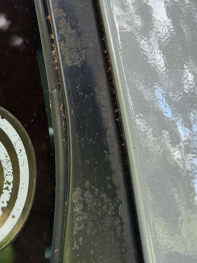

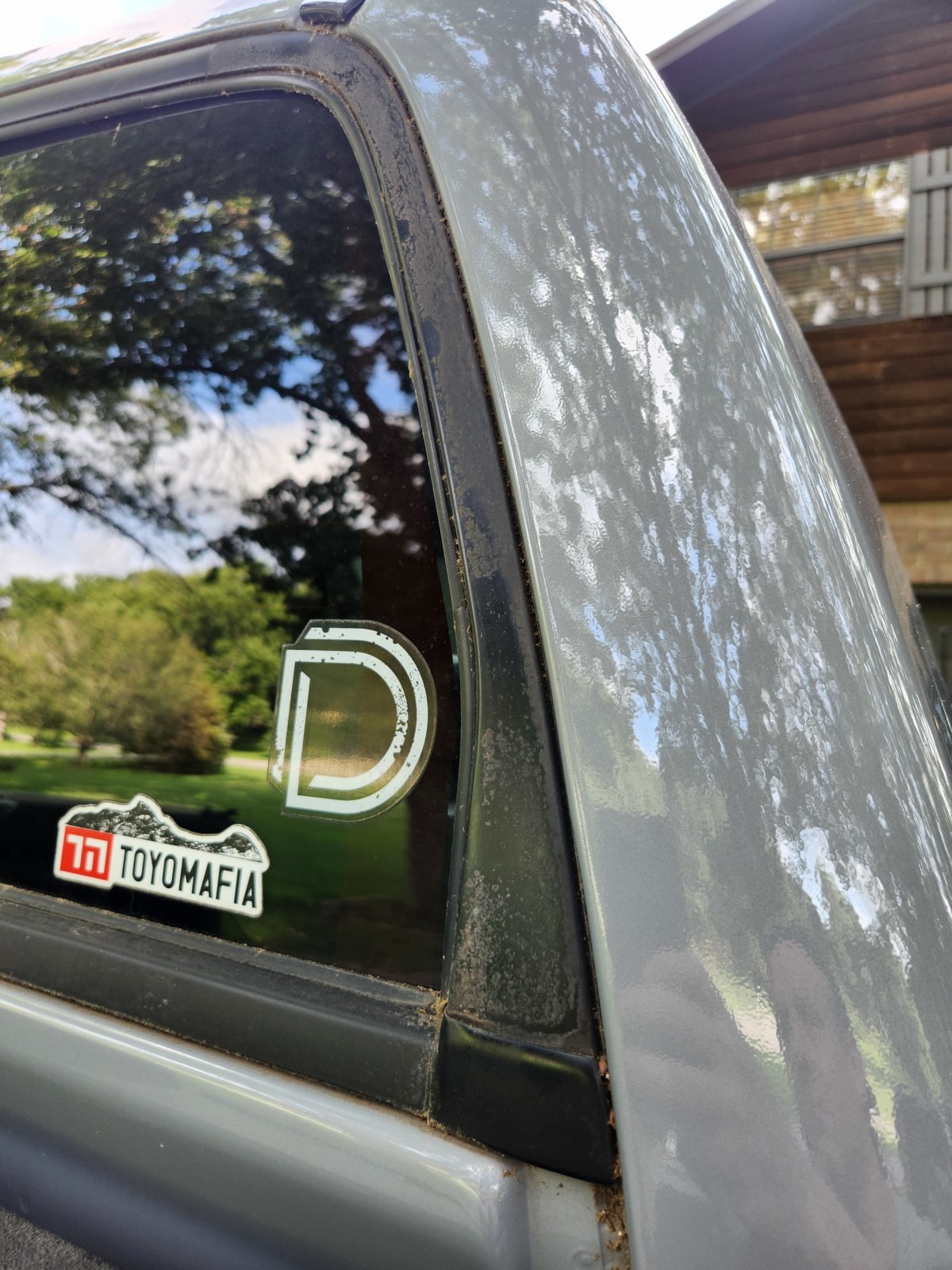

    Took my softopper off and discovered this occurring around my rear window.
    What do you guys think? Any good product suggestions to clean this up?
    Edit: yes, this was taken before a good bath to get the dirt/pollen crap off.

    Maybe an APC to start

    Tray an APC....but dilute it...start with 10:1 and see how it does. A little work with a detail brush and those edges should clean right out

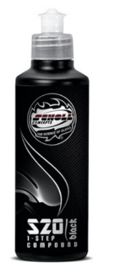

    Thinking about picking up some Scholl's S20, but not sure which pad to pair with it. I'm stuck between the navy one-step and the yellow finishing pads. Most of my correction needs are just swirls (and some paint overspray). My fear is the yellow isn't enough correction, but that the navy is too aggressive.

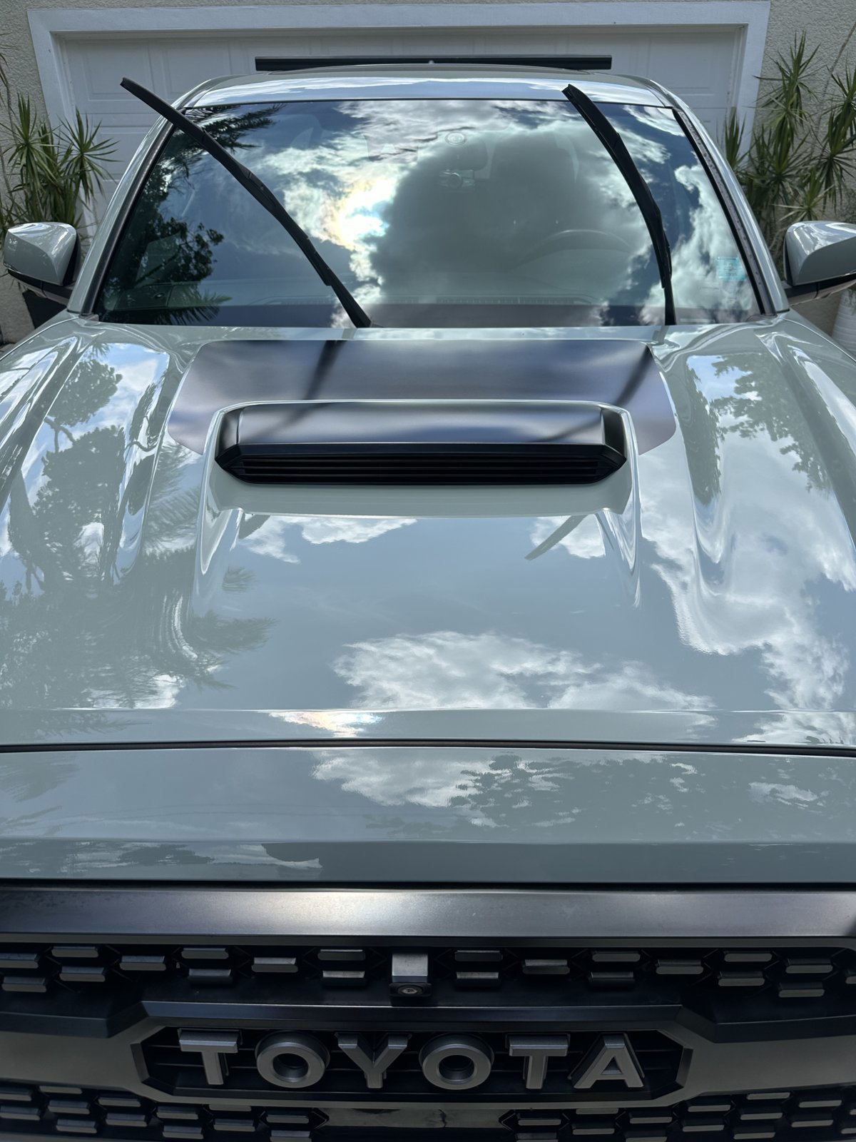

    Full detail with correction and Undrdog pro coating. IMG_8399.jpg IMG_8396.jpg IMG_8394.jpg IMG_8392.jpg IMG_8388.jpg IMG_8379.jpg

    Looks fantastic. Do you do this work on the side, main job or is that your truck?

    Thank ya.
    I do it for stress relief lol. Very close friends truck. It’s a hobby of mine. When I was much younger I detailed at a dealership for a couple years.

    What about this flaking/discoloration of the rubber/plastics around the window. You guys think an APC there too? That's where I'm lost.

    Yes. Make sure you dilute it.

    There are products you can use to protect it.....once you get it clean. One such product is Nextzett Gummi Pflege

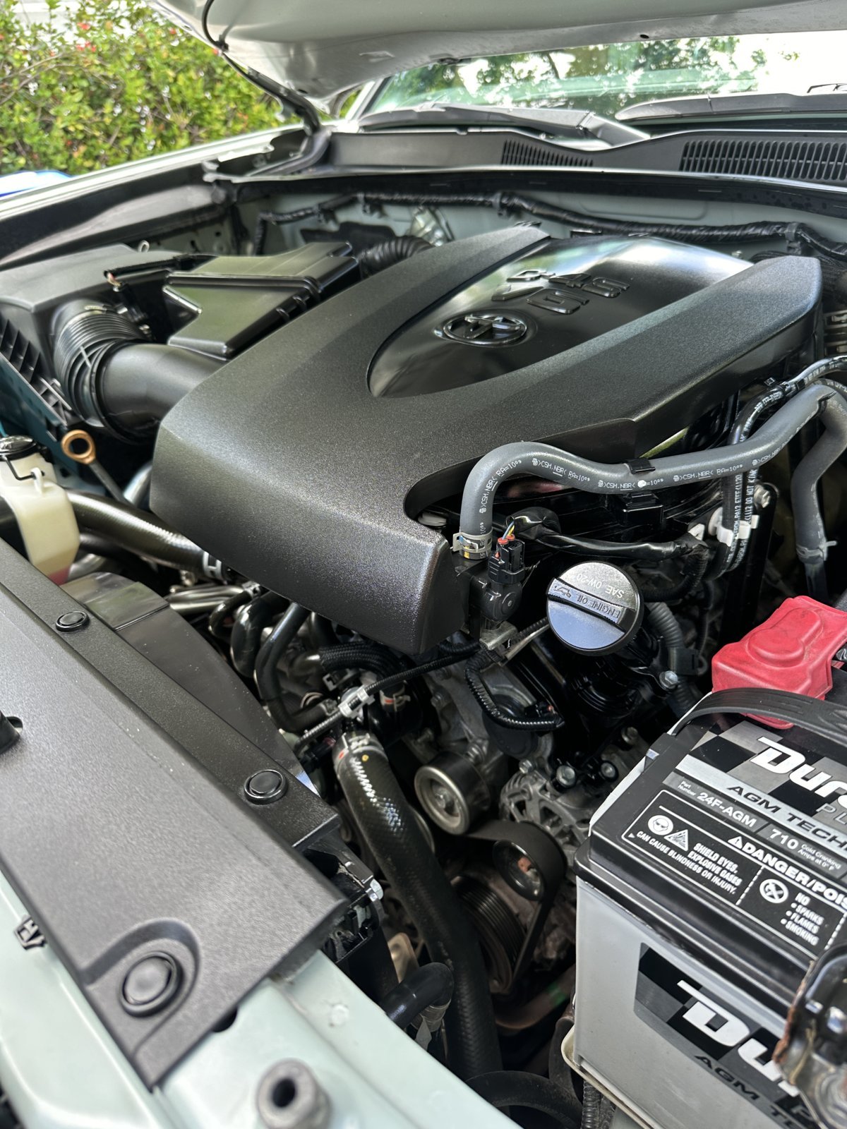

    Getting a little dusty under the hood. What would be the best/safest way to clean the engine bay? On the 14 I've simply rinsed it off with low pressure water w/o any issue. Any concern doing this with the 3rd gens?

    Personally, I would just cover anything with electrical and then very light rinse and spray some degreaser, light brush scrub, light rinse, dry

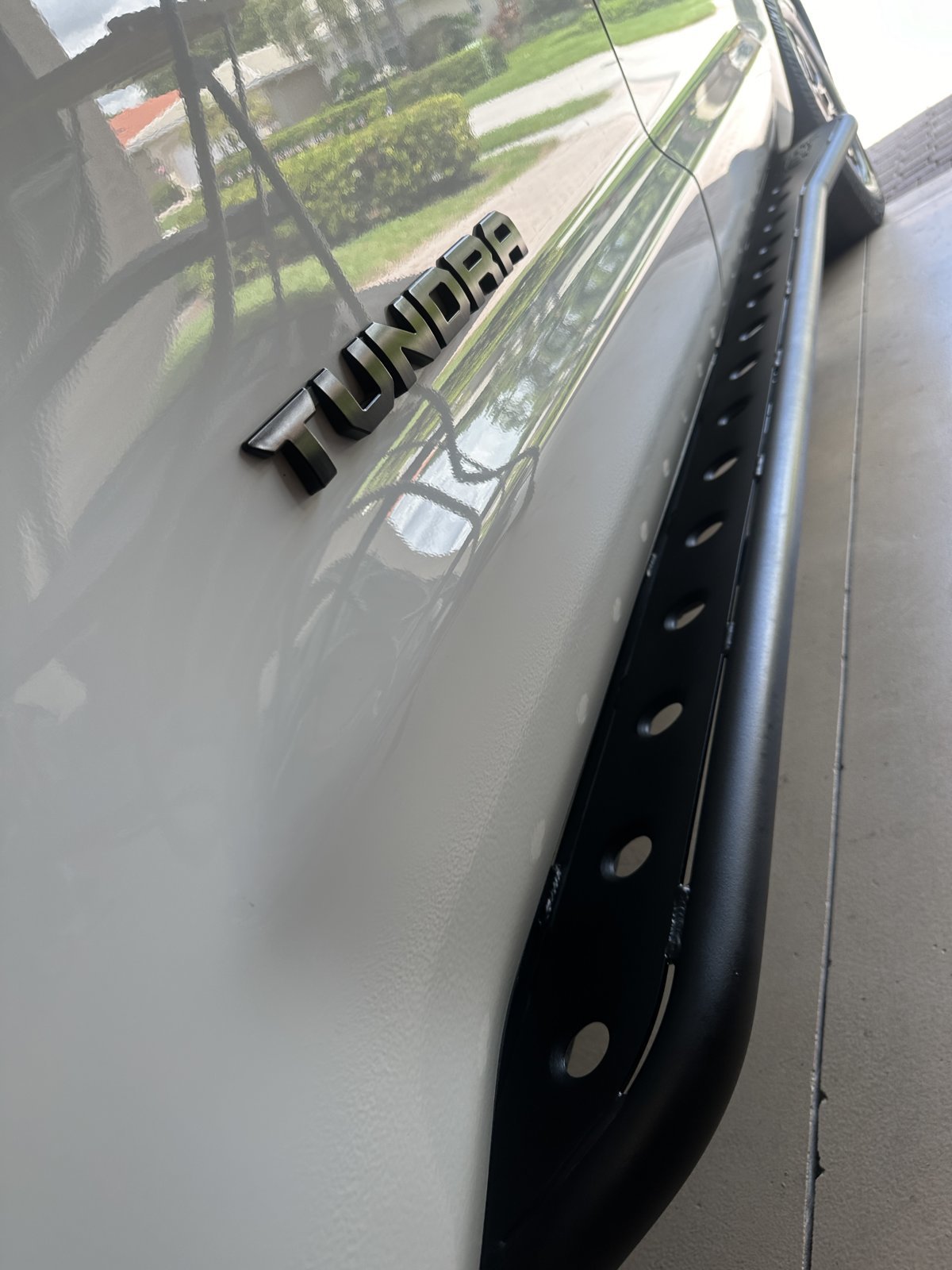

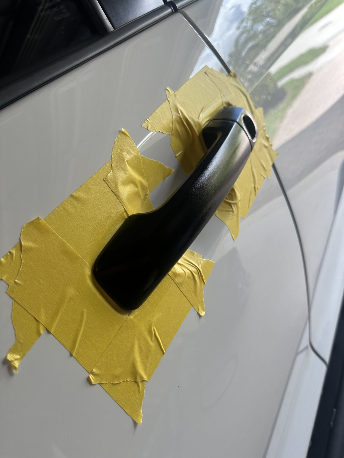

  30. Aug 16, 2024 at 4:17 AM
    #5370
    ToyoMafia
    Nov 8, 2019
    #38453
    13,415
    Magic carpet.
    Cool slaps and plastiDip

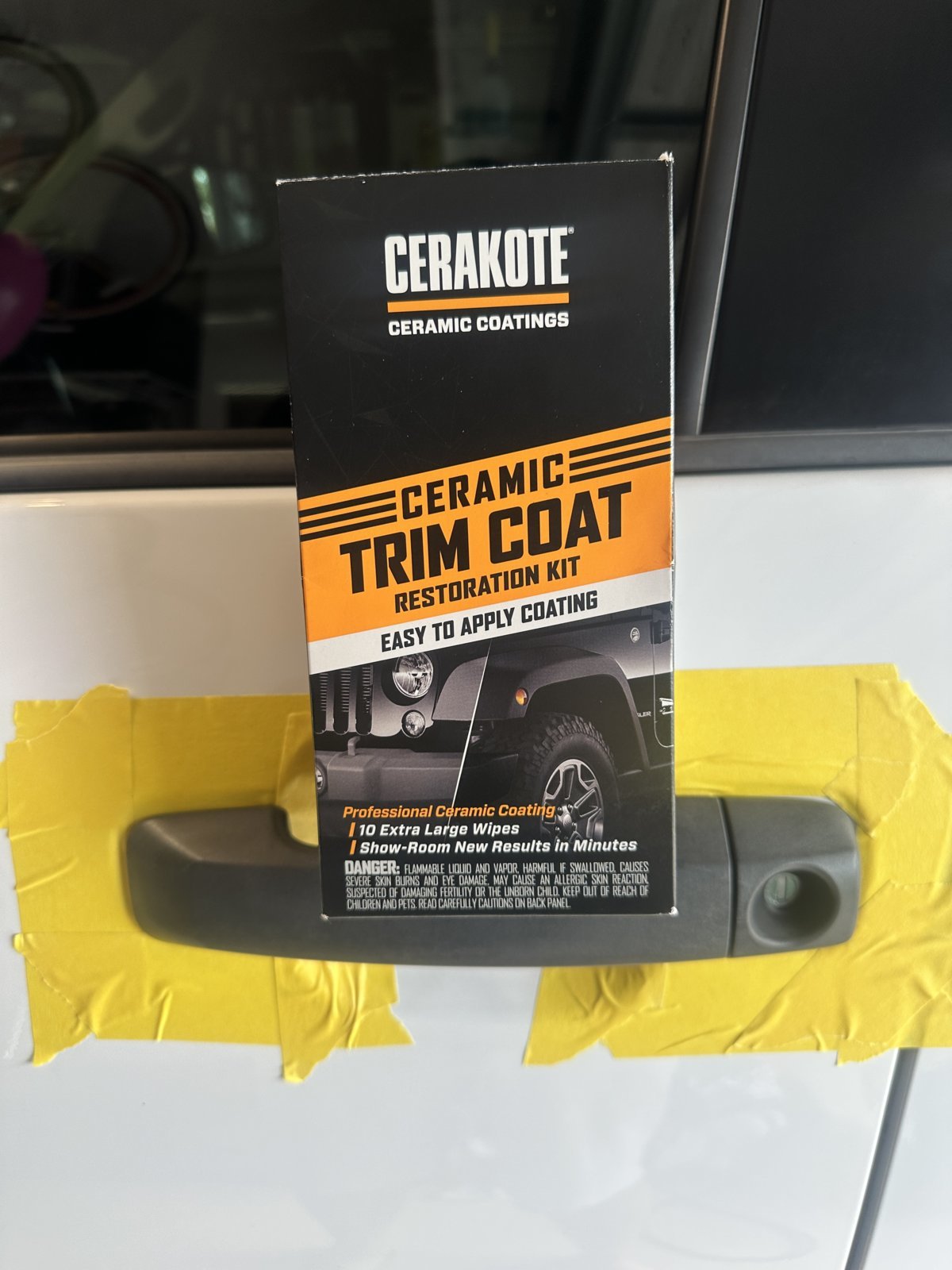

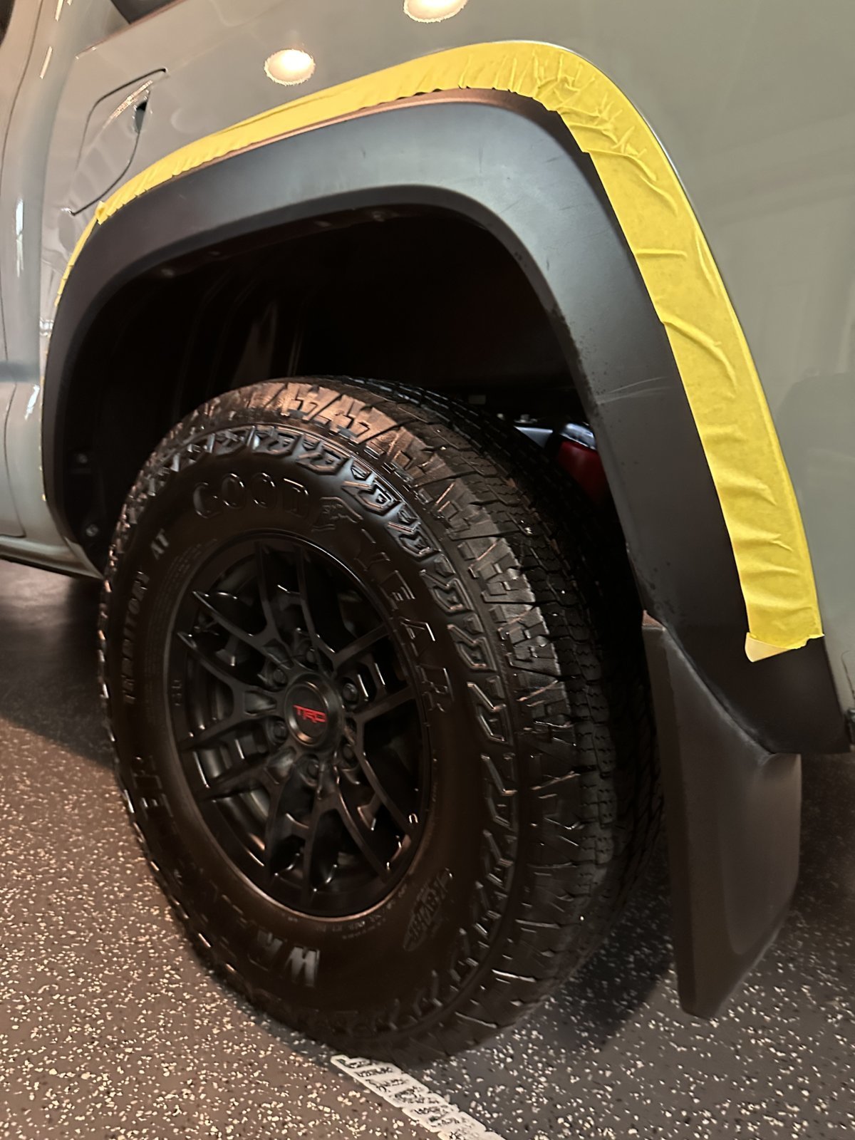

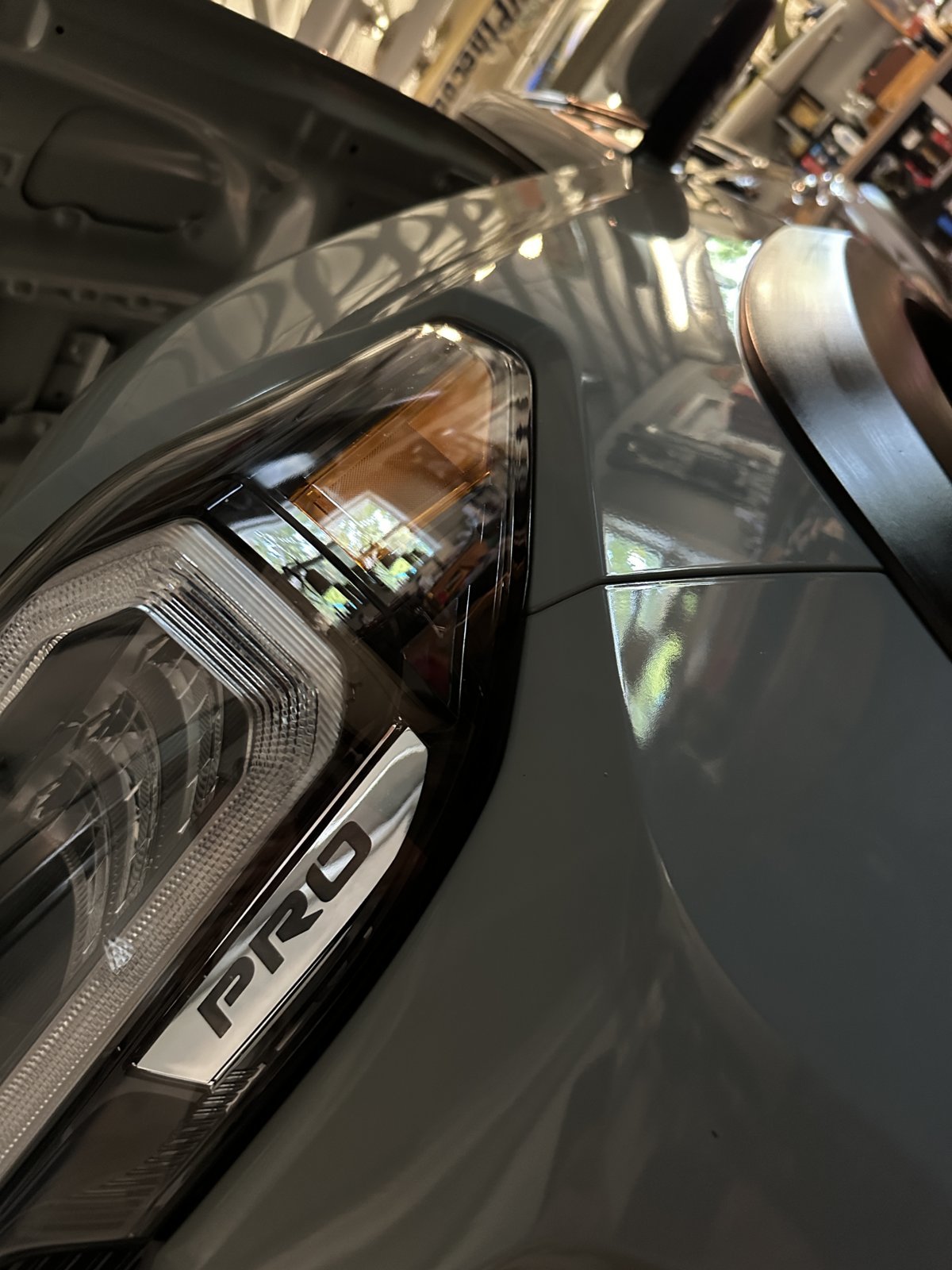

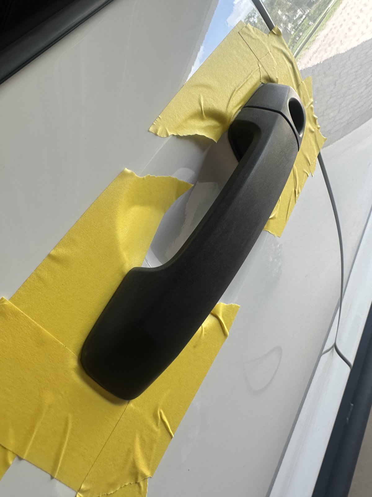

    IMG_8715.jpg IMG_8712.jpg IMG_8720.jpg IMG_8718.jpg IMG_8726.jpg IMG_8710.jpg Trim coat done on the Tundy
