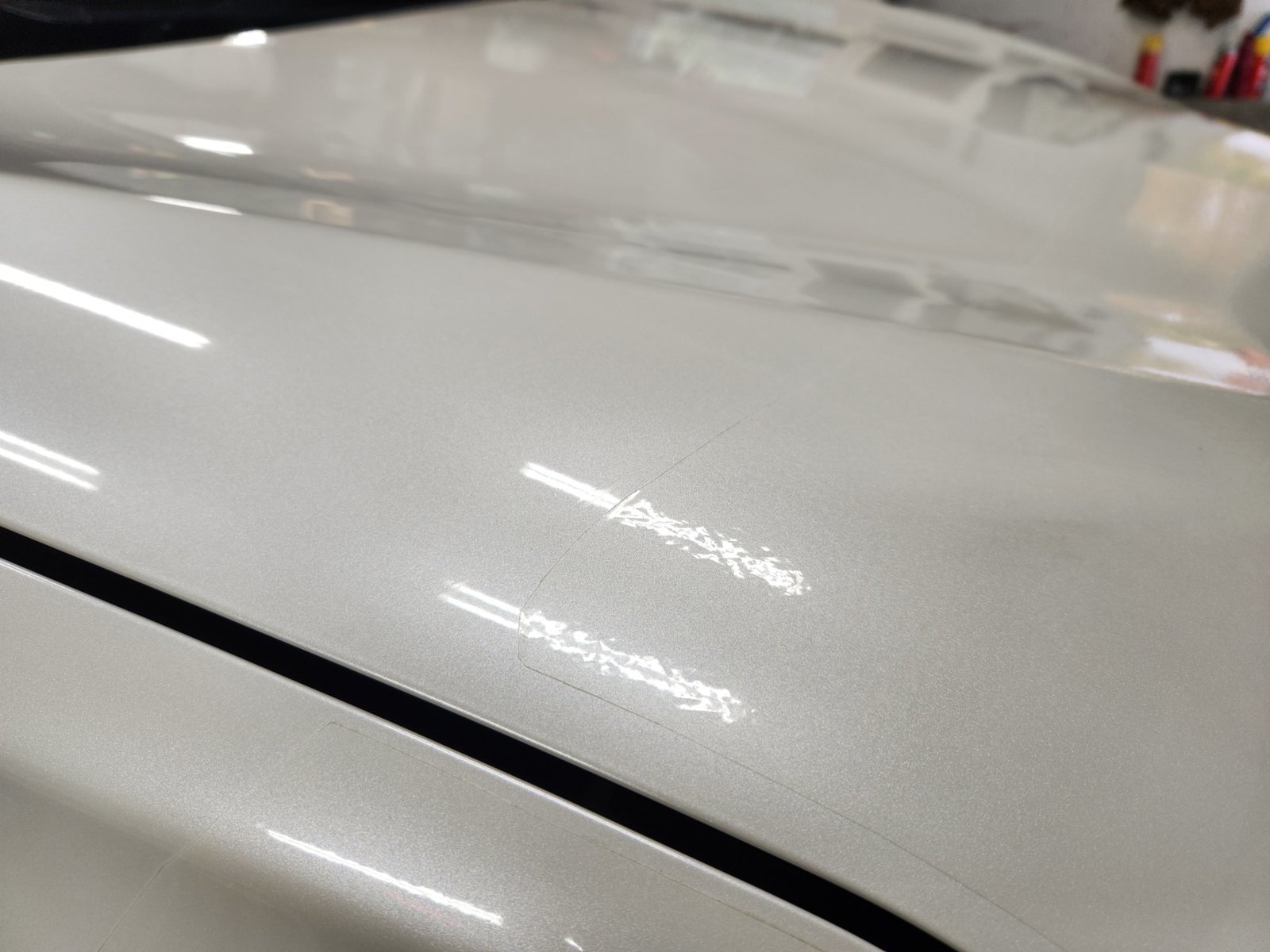

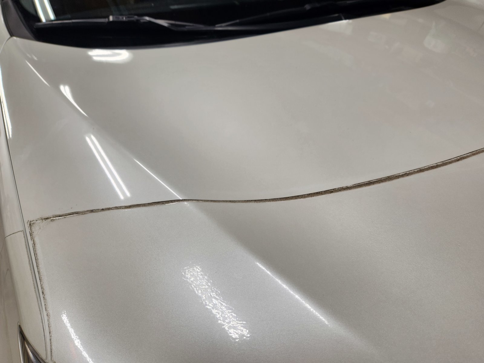

    Saving PPF....corners of this Rav4s PPF was peeling and dirt was being trapped in the adhesive. If this happens to you, you can save it so at least the majority of the ppf remains to protect.
    I have all types of vinyl tools so a sharp edge vinyl specific razor was used to lightly score (think you're touching a knife to a balloon...very gently glide) along the edge of the lifted portions. Peeled the garbage vinyl off. Used some Rapid Tac adhesive remover (new to me, unreal product 10/10 recommend) to get the grimey adhesive off. Then a light polish to blend the line as best as possible. It won't be perfect because there will be a visible ppf UV protection line if the PPF is old, however the goal here wasn't perfection...just save the majority of the PPF and make it look better.
    Close up at the end to prove it's still there.

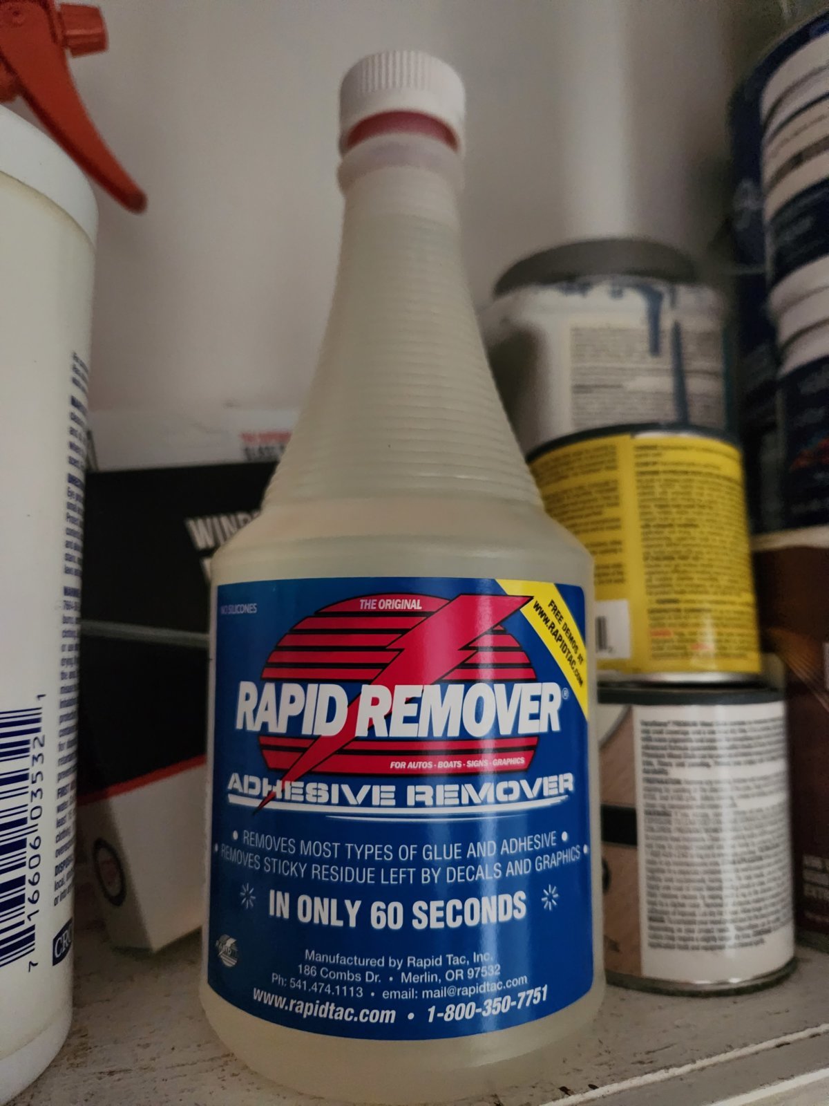

    Here's a pic of Rapid Tac if you want to pick some up off Amazon. Sort of expensive but it beats everything I have used (and I've used a lot, to include mineral spirits and paint thinners).

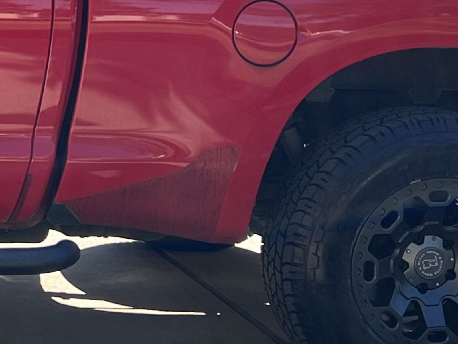

    I’m going to have to try this out. The red Tundra has PPF on the sides that looks like absolute garbage after 12 years. I’ve been hesitant to try and remove it as I’m worried it could take some paint with it after so long.

    Likely won't. If it's that far degraded it'll just come off in tiny pieces but should be fine on the paint. Just pickup some of that adhesive remover....came off like butter with a plastic razor.

    I ordered the adhesive remover and already have the razor blades. Thanks for the recommendation!

    Let me know how it works out for you. 100% follow directions. 60 seconds, no longer than 120. And use a paper towel. A yellow microfiber I was using started bleeding onto the PPF and stain...luckily a quick polish removed it but I freaked for a second.

    Yup. Wasn't a big deal after a light machine polish but it happened quick and any longer I think the staining would have been more permanent. White paper towel for sure.

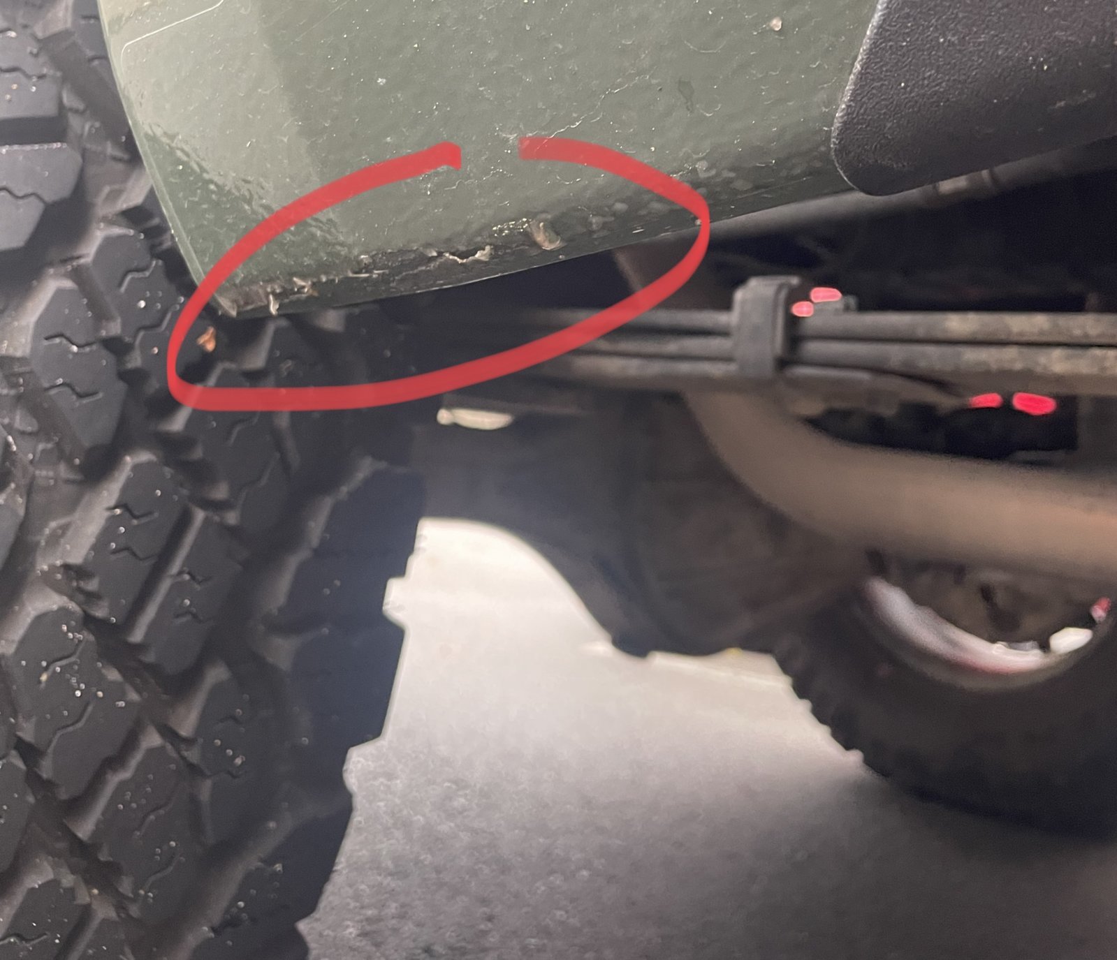

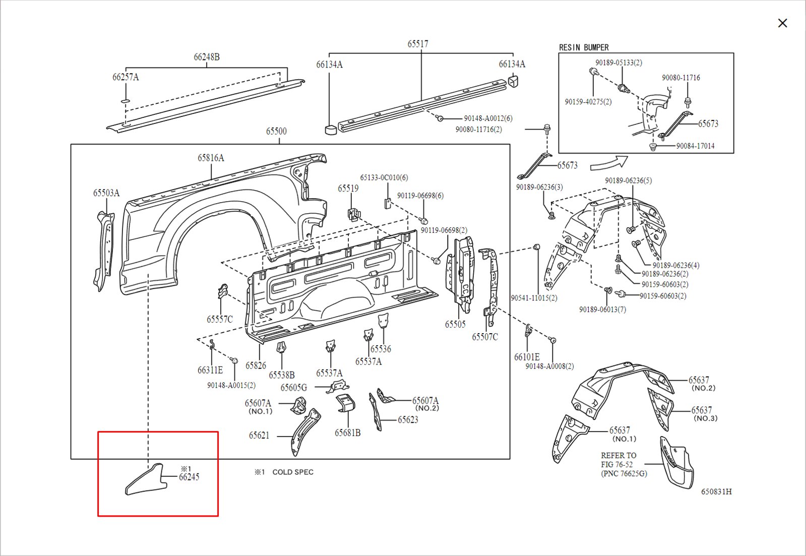

    Figured you guys might be able to answer this. I haven't been able to find the part number. I want to replace this PPF on my truck:

    This is the best I can find. Part #66245-0C030
    https://www.ebay.com/itm/234812591554
