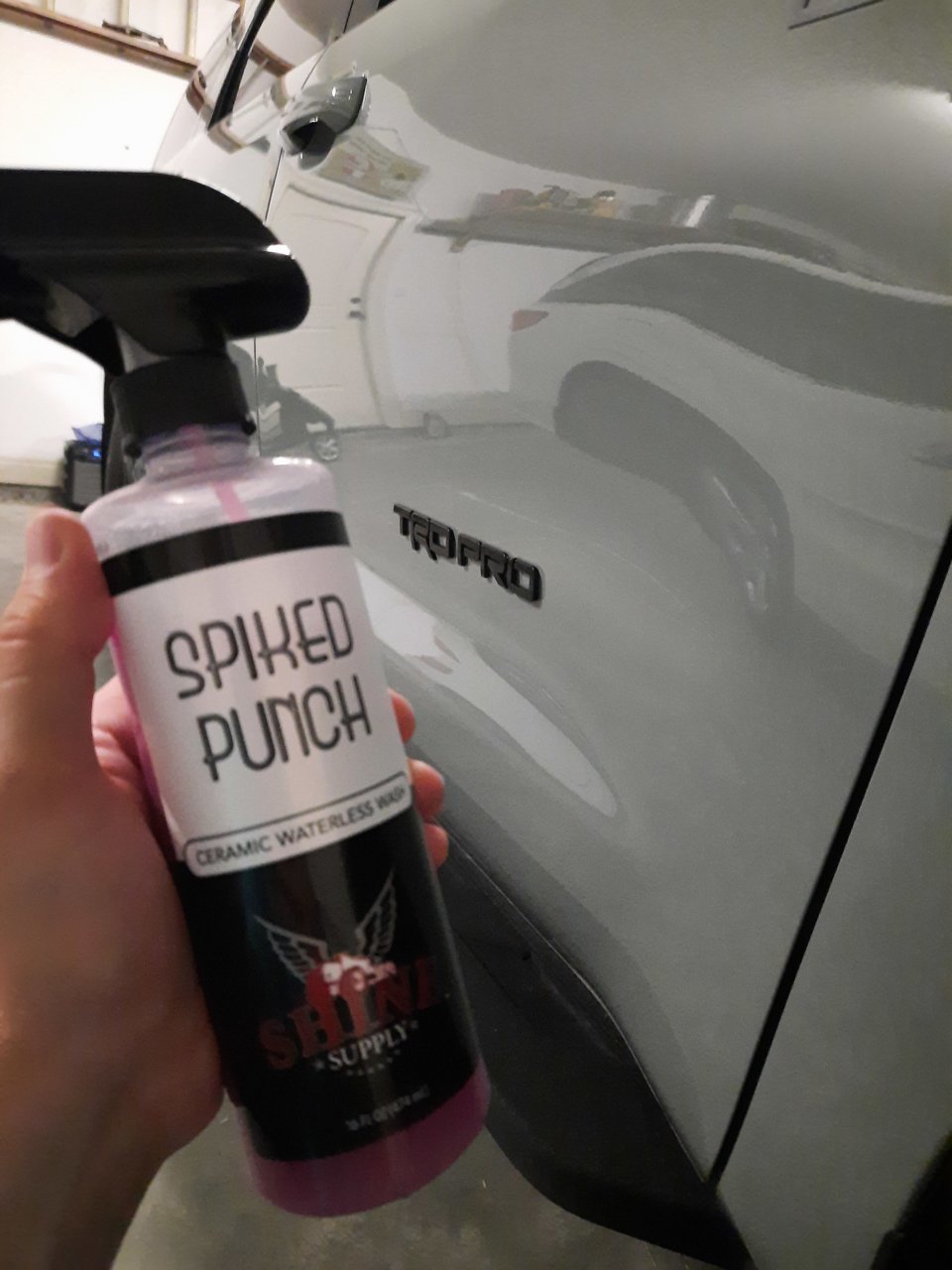

    Stuff works great, but that bottle won't last long. I bought a gal last black Friday and it's almost gone

    I can tell. Thr vehicle was fairly clean, but wanted to give a lil pop since I'll be driving around town tomorrow. When I saw how much I used I could tell I could use it quickly on a regular basis.

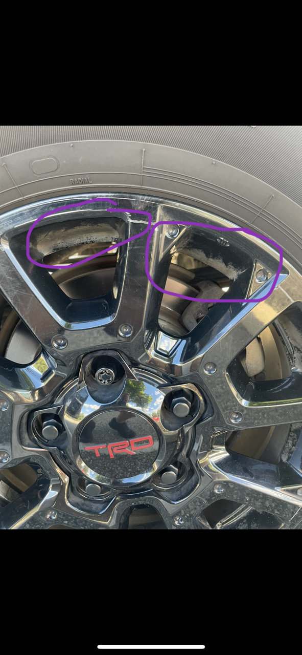

    Hey Guys! had my tundra for over a year and these spots have appeared on multiple ties. I've washed them a few times, scrubbed with a brush, and then just tried sonax on it as well. Nothing has really worked. Just wondering if there's anything else I could try. If not it's all good I'll probably get them redone or replace with new wheels. Thank you!

    Seems like Sonax and scrubbing should be able to take that off. Maybe try Optimum Power Clean. If that doesn’t get it off, I don’t know what will.

    Is it smooth or rough to the touch? Are the wheels the TRD OR wheels that were powdercoated (since you said redone) or Pro BBS wheels? Have you tried a dedicated iron remover?

    hey, it’s rough to the touch. And as far as I know they are the real trd pro rims that came with the truck in 2016. I was only saying that if I couldn’t get this off then I would redo the wheels. Sorry for making it unclear they have not been redone to my knowledge. I’ve tried sonax and just snagged some ironx earlier this week (I didn’t try it yet) and then was going to order optimum power clean as well

    No all good I just misunderstood. I would spray Ironx on and let it dwell. Lightly agitate then wash off. Rinse and repeat a few times. Make sure the wheels are cool, you're out of sunlight, and you don't let it dry. I've reconditioned wheels with similar looking issues. After doing that, try the Sonax again. In theory the Ironx should break up what looks to me like caked on brake dust and allow the Sonax to be more effective. I know Sonax has Iron remover in it, but it's not as good as straight iron remover. After that, last resort is clay bar but that will marr up the soft black inlays pretty good.
    Sometimes brake dust (very caustic and corrosive) gets so caked on that it will just deteriorate everything it's on. At that point, a refinish is the only thing to do because you'll cause more damage trying to aggressively remove it. I go months without washing my vehicles most of the time, but I clean the wheels once a month and apply a sealant after just to prevent that scenario. Poor Boys is pretty good. Doesn't last long (6 weeks or so) but it's really good at preventing the buildup.

    thank you! After about 3 tries with the ironx it’s starting to come off. I only did one part of a wheel so far but it’s about 90% removed. Definitely is working and hopefully this weekend I can knock out the rest of them. Appreciate the help!!
