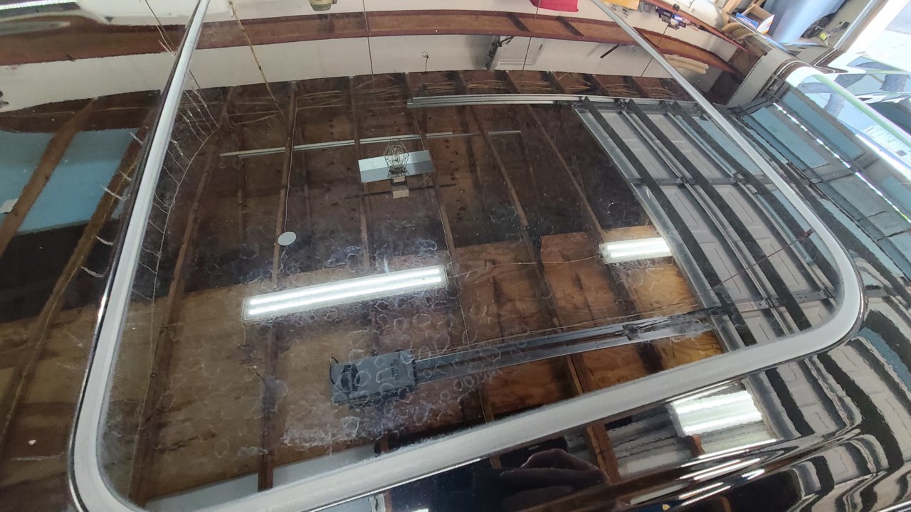

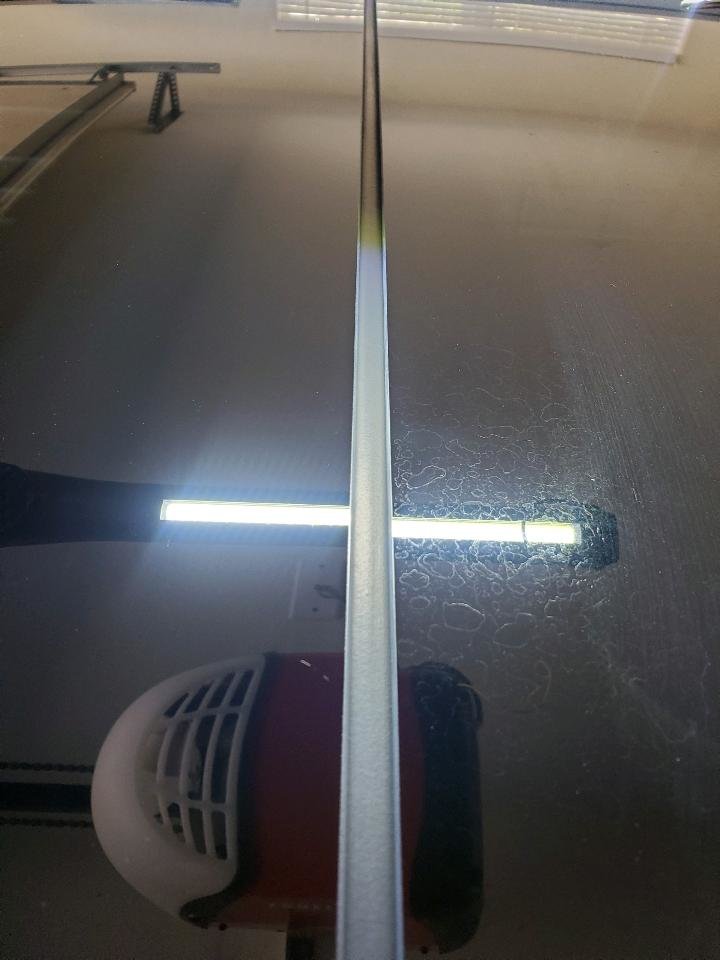

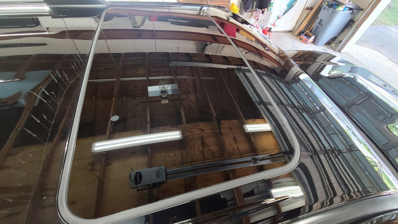

    FYI 95% of hard water etching and spots can be removed with a wheel acid. I use Meg's wheel brightener. Spray into a microfiber sponge, carefully spread on the glass (keep it off the seals), and I use a circular overlapping motion to scrub the etchings. Once it dries (it flashes and you'll notice), quickly spray with an alcohol based window cleaner (Ex. Stoners or 3D window) and wipe until all the residue is off. Spray again to make sure all residual is gone and wipe then apply your final glass cleaner (Ex. Rain-X). Should only be done in the shade on cool windows. Getting the "flash" time down is just practice. You won't hurt anything by wiping too soon while you're learning. I did this 4Runner's glass and mirrors (11 sections total) in about 30 minutes. They were all spotted as bad as this sunroof.

    THANK YOU!!! I've been trying to find an easier solution being here in Hawaii... I will definitely give that a shot, I have a good personal vehicle test subject!!

    No problem. Harder spots give it a second round. It won't always get all of them (some need to be Rayon polished with Ceriglass), but this works the majority of the time.

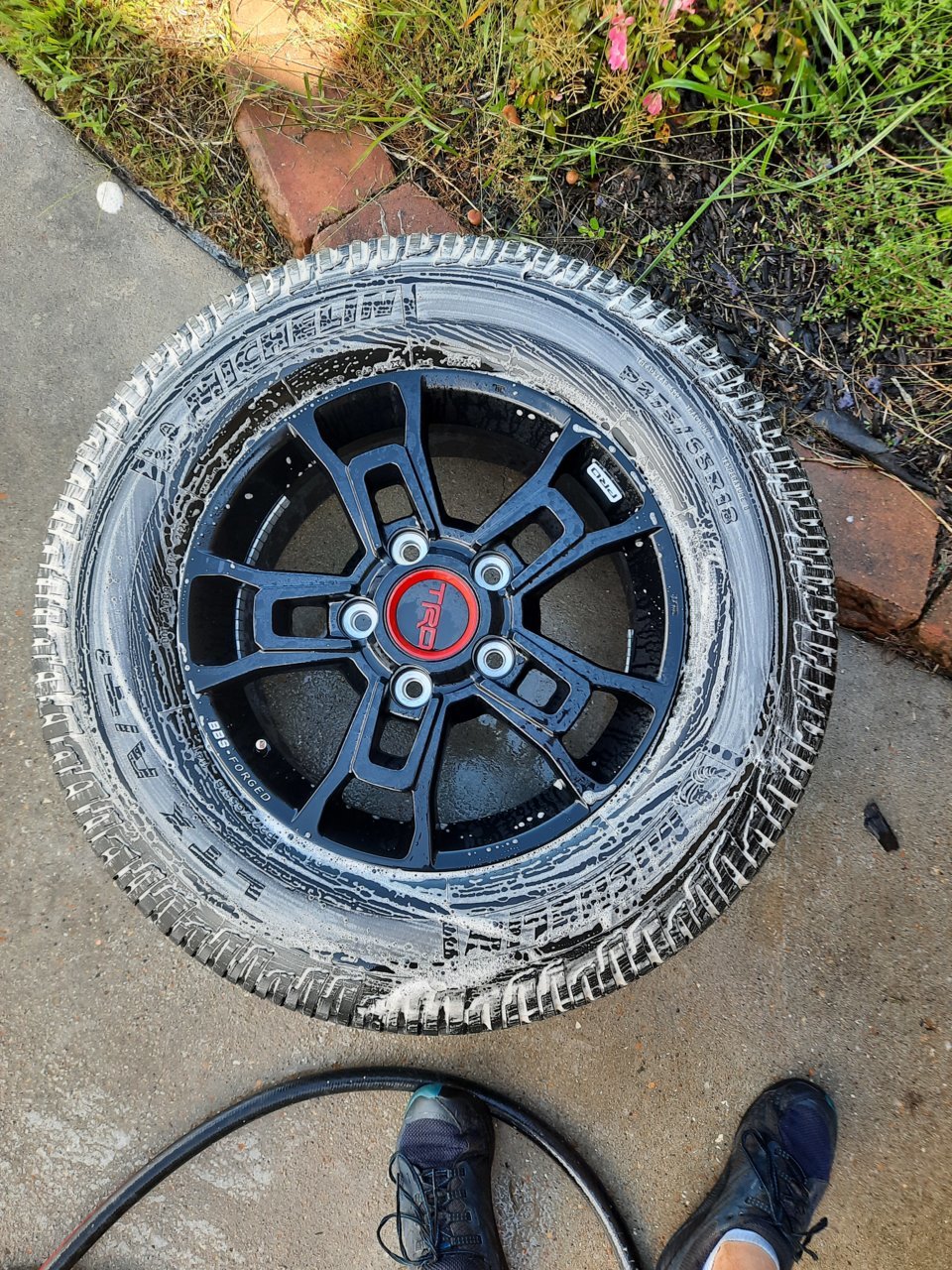

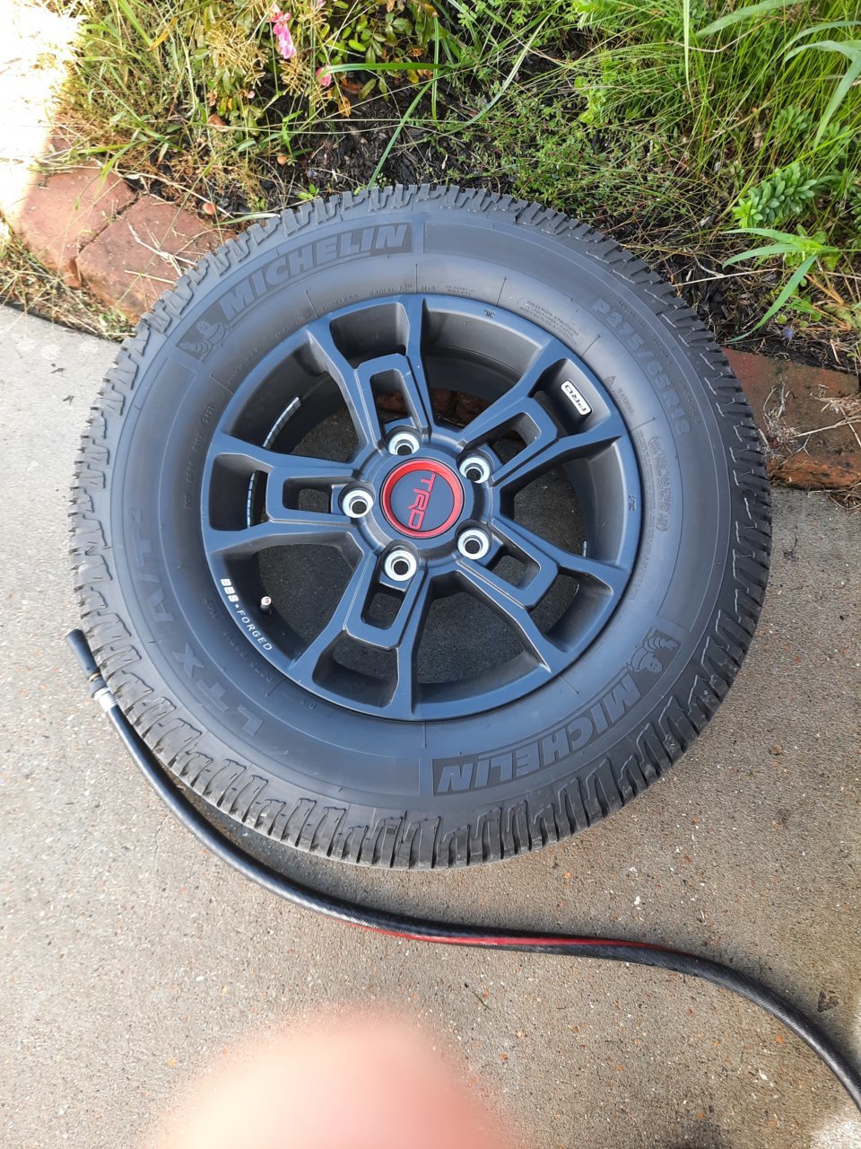

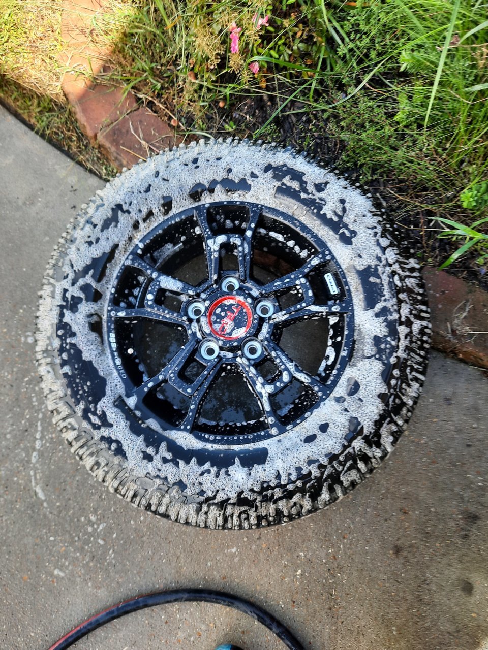

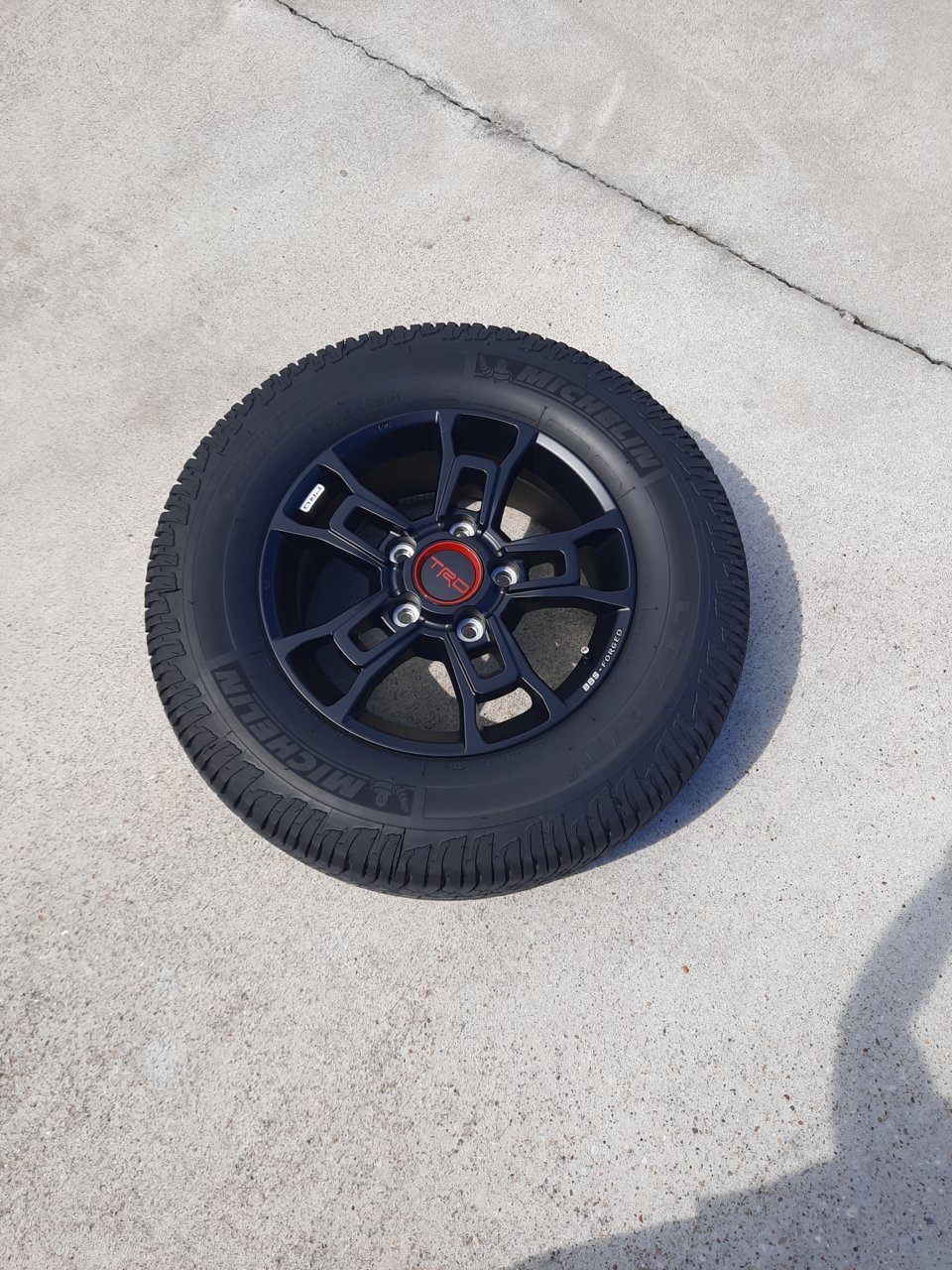

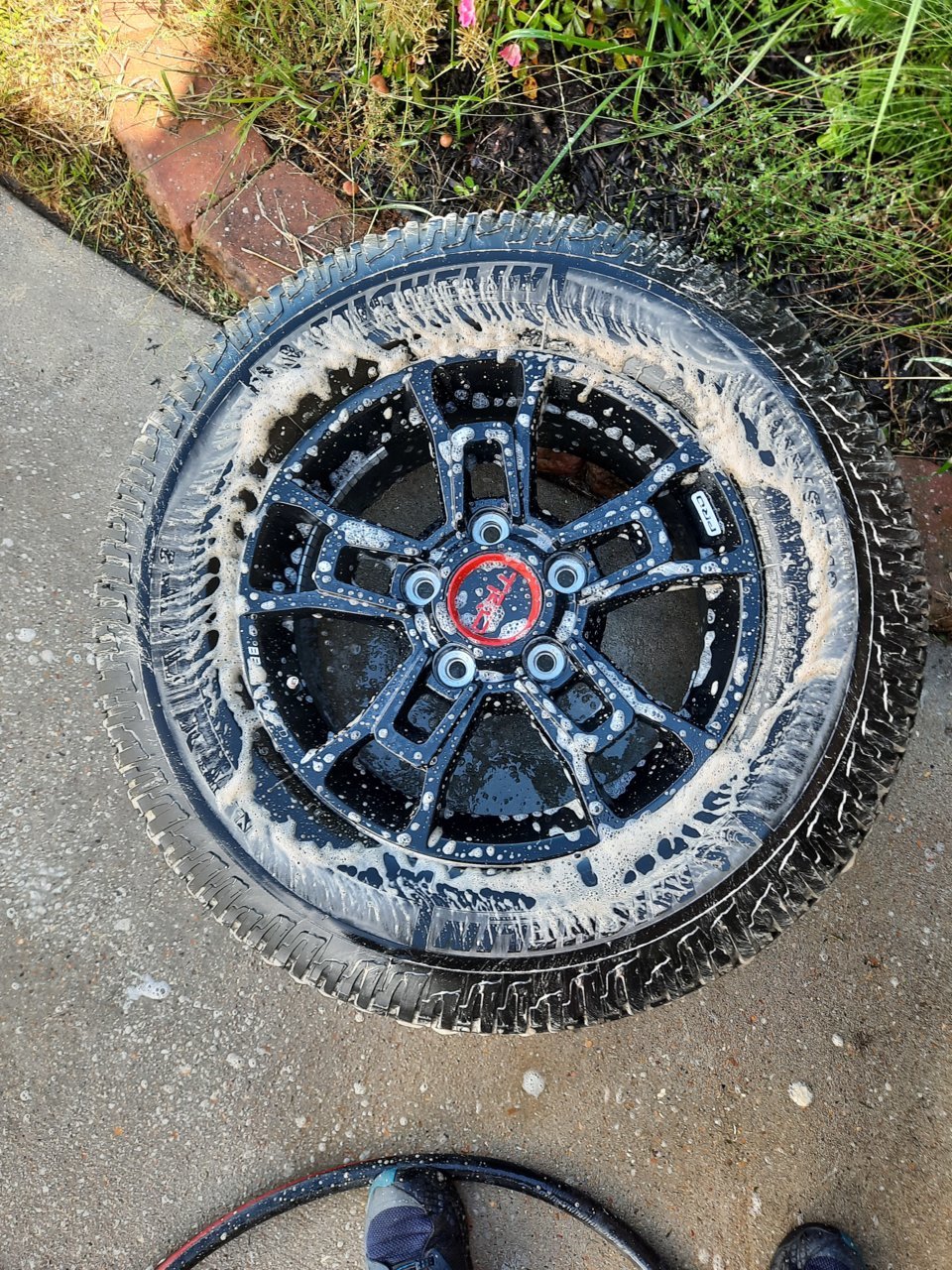

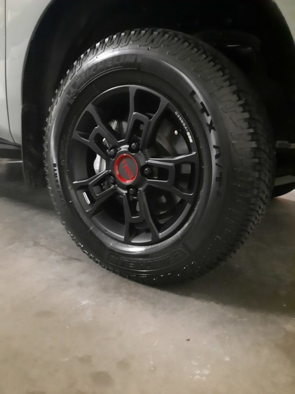

    Decided to coat the tires in optimum tire coating. Prepped with Shine Supply wise guy. Let it dwell for about 40 seconds to a minute then took my drill and drill brush to it. It seemed to get it all, but went behind it with optimum power clean (4:1 ratio) and did same process but used a tire brush to scrub it. Foamed up white and no browning in the foaming. Let sit in sun after drying off with blower and towel. Mounted back up and applied a coat. Came back an hour later and applied one more coat. Happy with results like I was before on previous vehicles. 2nd coat was to ensure even coverage, but to also give a slight bit more gloss to it.
    20210919_135453.jpg 20210919_135607.jpg 20210919_135639.jpg 20210919_135955.jpg 20210919_141702.jpg 20210919_150239.jpg 20210919_180709.jpg

    Beautiful. Any idea what kind of durability you can expect?

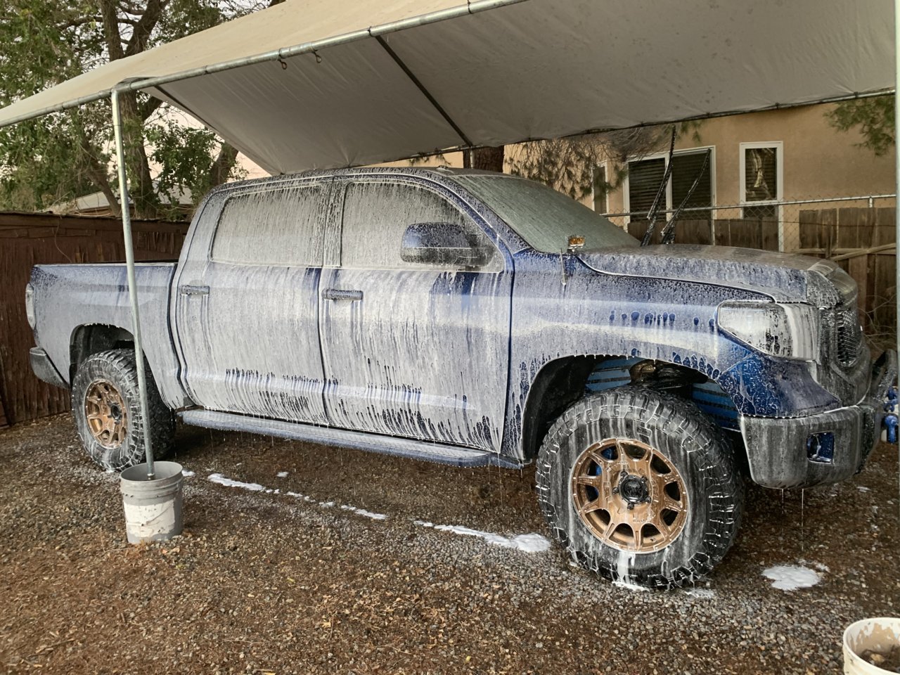

    Whazzup pros! I recently acquired a Kaarcher pressure washer and Trinova foam cannon. I used Watermelon Chemical Guys Snow Foam, and noticed a significant difference in the gloss in the finish from using my normal Meguiars Wash & Wax. The Meguiars leaves a much deeper gloss behind. My question is what soap do you folks use in your foam cannons for darker color vehicles?86413840-99FF-4607-9E55-6A32B861D0AB.jpg

    Last time on my wife's van it lasted about 6-9 months. When I did the truck it seemed closer to 5 or 6 months. We'll see how this one does

    I looked at the clock in my garage when i started and it was 1:10. When I finished all 4 tires and went inside it was about 2:45. all I did was dismount the wheels and tires and cleaned them. the vehicle is still dirty:(

    only reason i did was to get better access to barrels of wheel to clean them. 18s are a bit harder to get to. usually i just do it while rotating them...but wanted to be a bit bougie about it

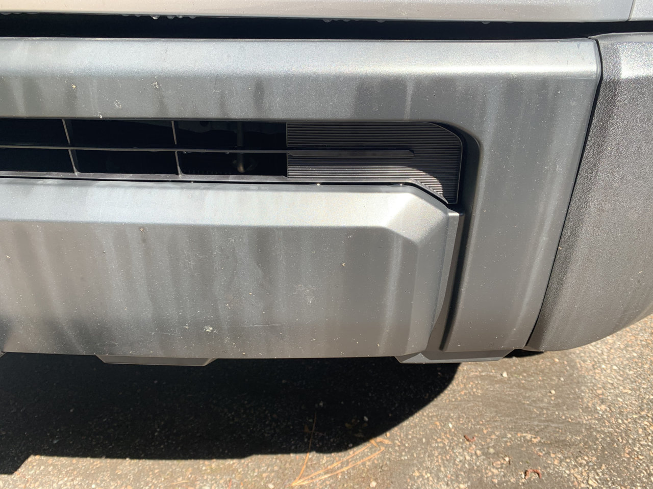

    Need some help. Washed the truck the other day and used some Trim Shine for the first time on the front and rear bumpers. Well of course it rained the next day and now it’s streaky on my bumpers. Is this because of the rain or did I apply this wrong?

    I've learned most trim stuff doesn't do well in rain so I've quit using it and switched to Cerakote. Lasts longer, restores look, and looks great.

    You don’t mention what product you used, but I’m assuming it was low quality. Unless you just put it on without washing it first, I can’t think of anything you’d have done wrong.
    Good products to use are:
    Solution Finish: Restores very well (better than anything), but it’s really just ink. It doesn’t really provide any protection from heat / sun, etc.
    Shine Suppy Trim Shield: Restores as well or better than most (not as well as Solution Finish), but provides great protection and outlasts most comparable products by a good bit.
    Cerakote: As @Fotnot said, it’s an outstanding product. Restores well, protects great, and lasts a hell of a lot longer than anything else. Easiest to apply as long as you follow instructions perfectly. If you screw it up, you’ll be staring at your mistake for at least a year.
