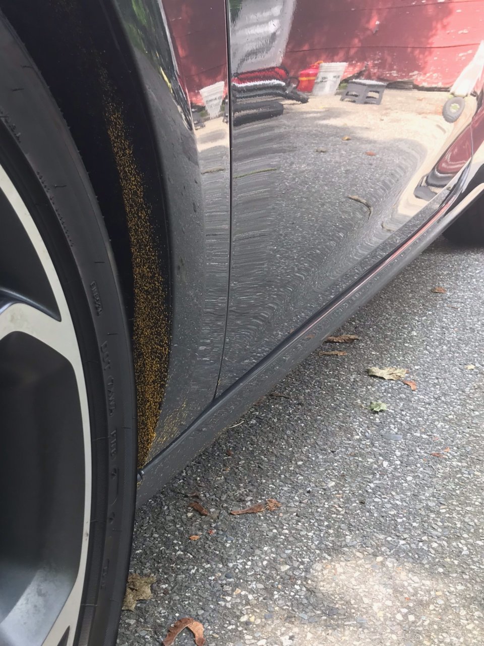

    So this happened to the wife’s new car yesterday
    Not to worried about getting it off the paint but not sure how I’m going to get it off the wheel well liner

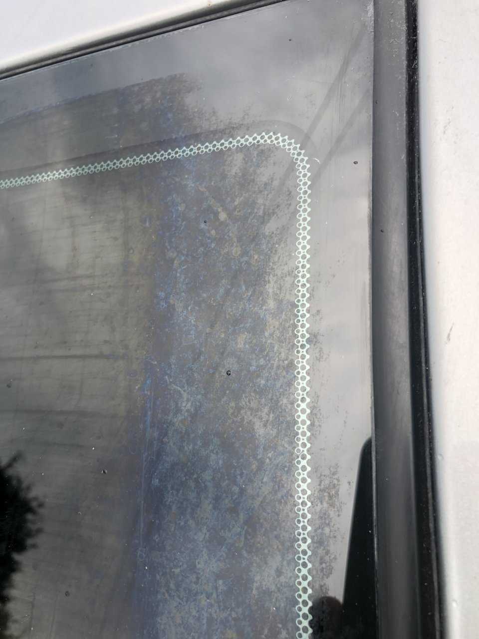

    I need a little help. I’m having the hardest time getting rid of these water marks. I’ve used white vinegar and water mix, I’ve used ultimate compound, I’ve used Steel wool #0000, I’ve used a mr clean eraser. These marks just won’t come off. Anything you guys would try to use that I haven’t.

    I've known people in here have used bar keepers friend cleaner...but make sure not to let get on paint. I've used meguiars glass kit that comes with a compound then a sealant to put on after. Get at local store and was only about 15 bucks I think. Just my $.03

    Is that on an RV?

    No it’s my tundra just can’t see inside due to my tint.

    If that's on window glass......your only alternative might be ceriglass on a rayon pad with a DA.....CarPro sells a kit using ceriglass by hand if you do not have one

    I will try bar keepers friend tomorrow and if that doesn’t work I’ll give this a try.

    Barkeepers Friend in liquid form works great on glass. Just keep it off the paint. May work on chrome also, but I haven’t tried it. @briarpatch recommended P21s polishing soap a while back. I got some, but I haven’t tried it yet.

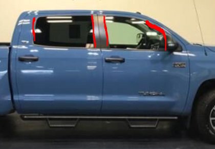

    Clean the window and side channels really well, and hit the side channels with some pure silicone spray lube.

    When you say "side channels" are you referring to the vertical channels the window rides up in the doors? (red lines in pic) I'm asking because one of my windows is getting noisy.

    Yep, those are them.
    The clean and silicone spray lube worked on fixing my commuter cars noisy windows.
