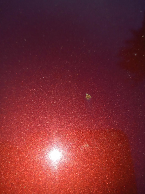

    I think I ve neglected these rock chips long enough. I got them all over the hood. (From the previous owner). Is this something a detail shop can fix? If so I m wondering how they would address it so I can be ready when I do take it in.

    Touch up paint will be the cheapest approach otherwise a respray is in order.

    The pic on top is concerning....looks like surface rust is starting.

    I have fixed a few rust spots on my Tacoma and it worked good. Obviously still visible, but it stopped rust from growing under the paint. I used a Dremel to grind through the rust and clean it up, then applied the paint in thin layers until it was just above the surrounding surface, and then sanded it down very carefully with 1000 and 3000 grit sand paper.
