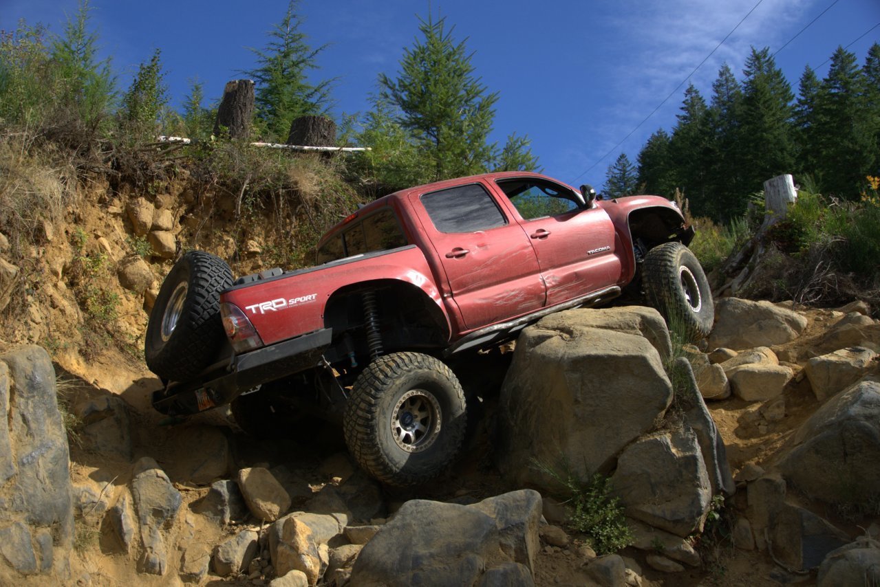

    I couldn’t find the pics of the shop full of parts.
    Did find this though.
    Cruzer likes this.
