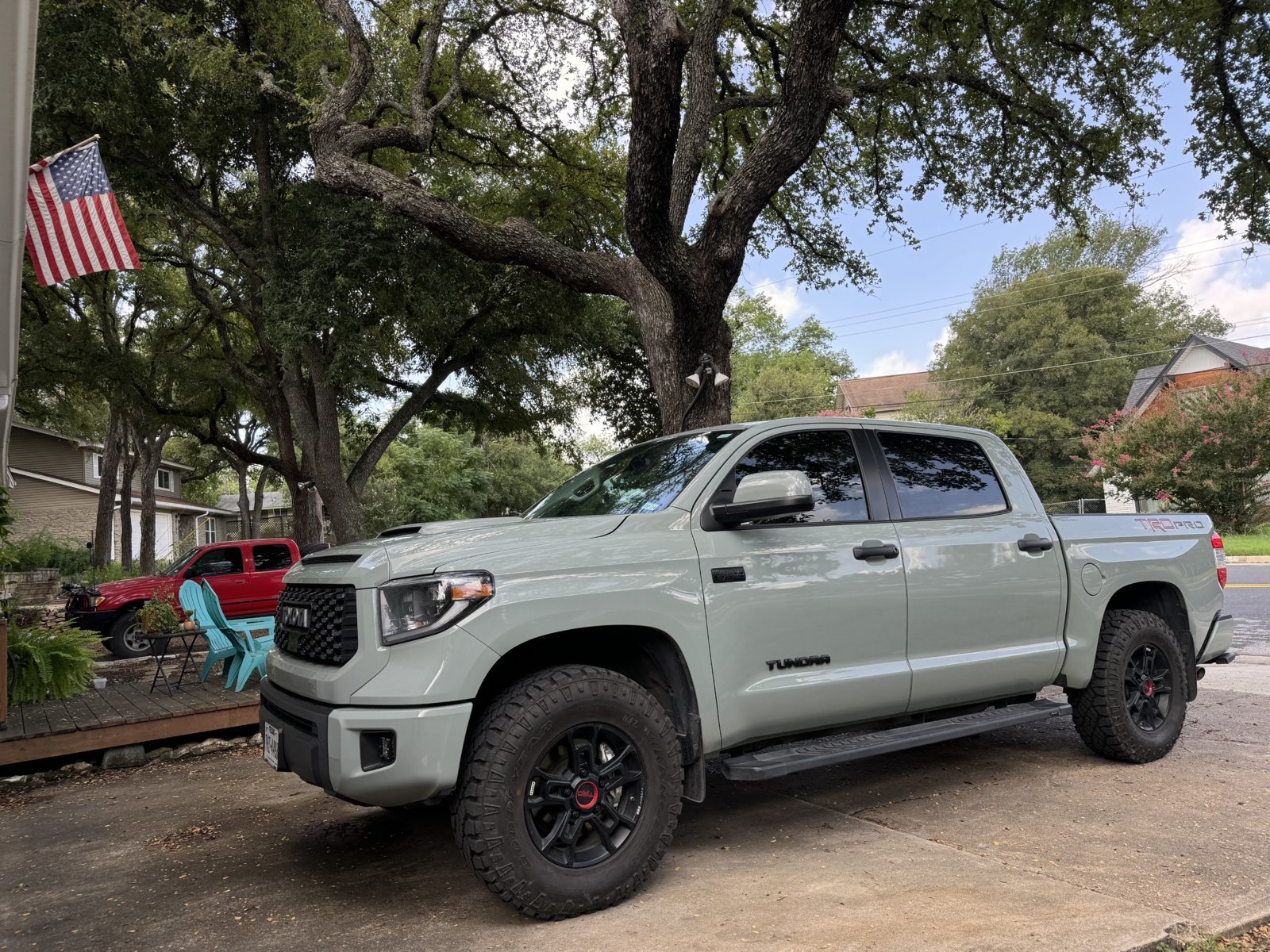

    I had 285/75/85 Goodyear Duratraks installed today. They were takeoffs from a Tremor, $1120 out the door mounted and balanced. I removed the little front mud flap before I had them put on. They fit like they were meant to be there from the beginning. There is small piece of plastic next to the bumper mud flap that was mangled or hit by a rock and protrudes into the tire from being deformed, but a pair of snip will fix that. Stock 21 TRD Pro. The ride is stiffer, but feels improved to me. I’ll do some more testing to see if there is any rub that was missed before leaving the tire shop, but it was spot on. Even my wife likes how they look! Bonus.IMG_6800.jpg
    jmladdy, TundraJedi, ZPhilip and 4 others like this.

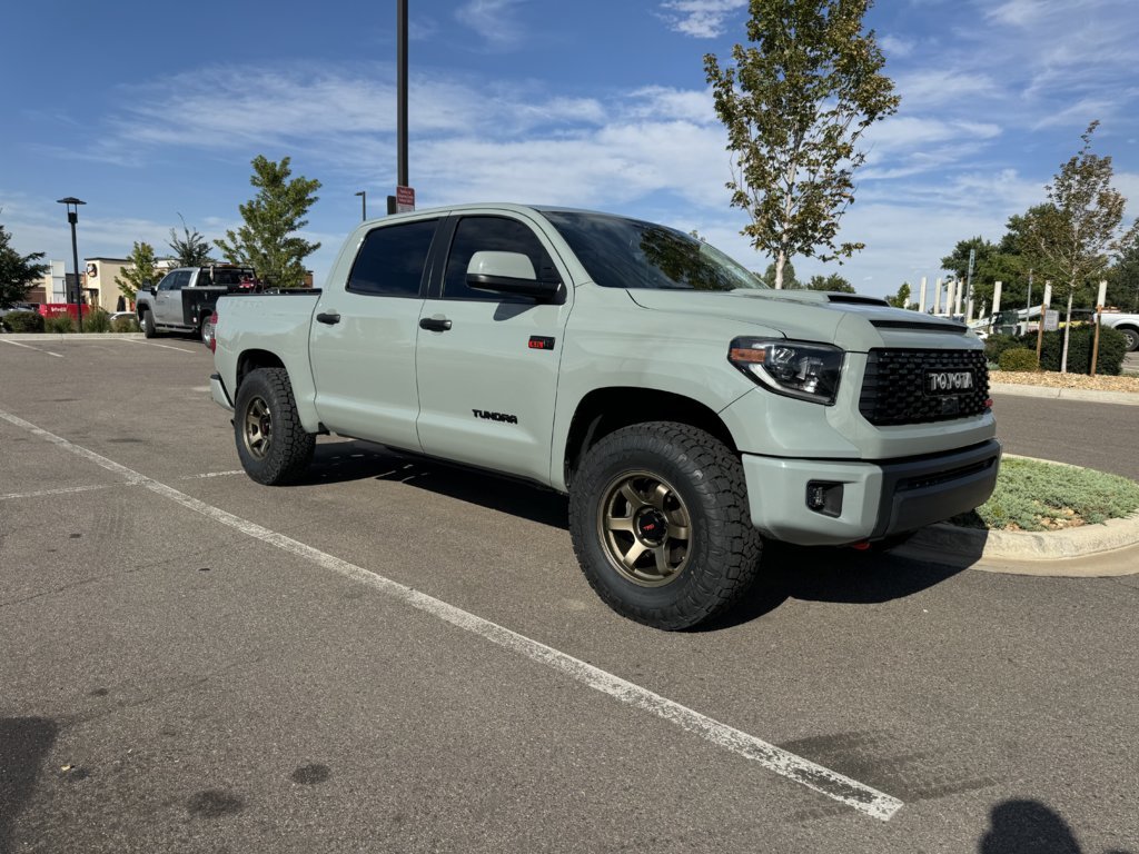

    I finally got mine installed. So happy with the results. No rubbing.
    I took the plastic liner in the front out and mud flaps off.
    FN BFG +18 offset 18x9
    285/75/18

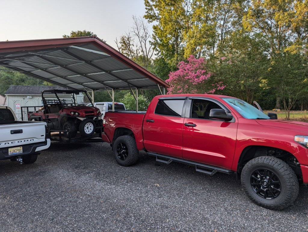

    PXL_20240811_114527385.jpg I have 295/70 18 w/ Nitto Graps on my 2020 SR5
    6112's up front
    5100's in back
    1.25 shims and CB shackles
    I purchased the truck this way and after being on this forum discovered all my goodies
    I tow a side x side and my tractor occasionally
