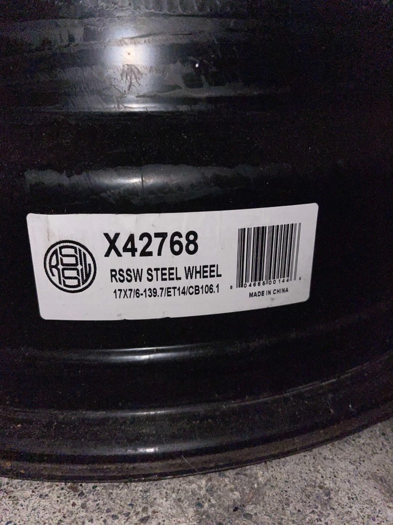

    I’m on the fence about buying these tires as I’m unsure if they’ll rub or not. I’ve got Bilstein 5100 w/ OME 84 up front and 5100’s in the rear. Will I require spacers?
    They’ll be mounted on these steelies:

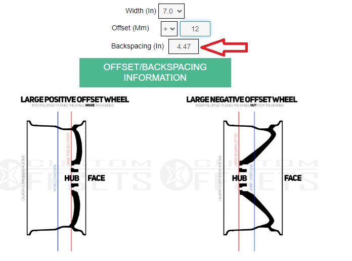

    It's the correct center bore, and ET = offset, so offset is +12.
    Running those numbers thru an offset calculator so I don't need to bend my brain before this 2nd cup of coffee kicks in, and comparing it to the 'known working specs' in the wheel/tire section of the megathread which I'm pasting the bullets for below, it looks like that'll put you at 4.5" backspace, which should be great for avoiding suspension rub and give a nice bit of poke, especially if you don't have fender flares. With flares, it should put your wheel and tire just inside the edge of the flare. From the wheel/tire of Megathread:

    Whether you rub frame and/or eat fender well is going to be a factor of your tire choice more than anything. Awfully skinny wheel, even skinnier than the factory alloys. What tires are you planning to run on those?
