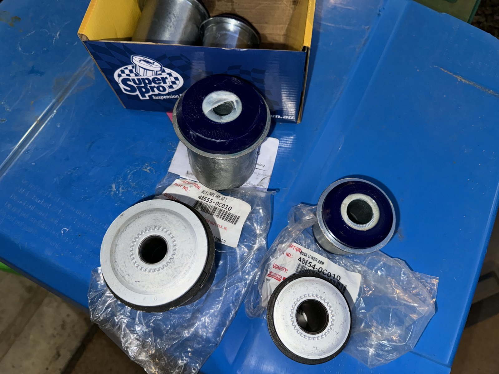

    That’s strange, why would they be oval shaped? The energy urethane bushings were all the same shape. All the more reason to upgrade, I guess.
    Part numbers for the SuperPro or the OEM bushings? Actually I think I have pictures of both.

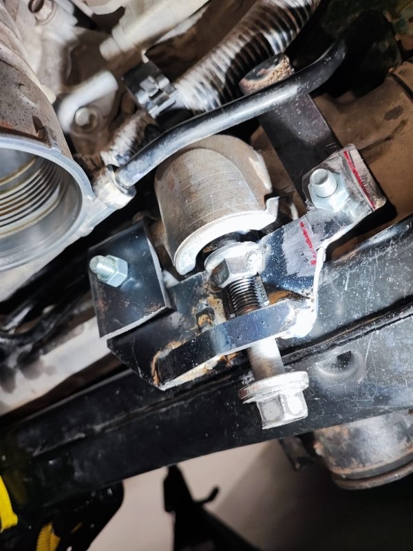

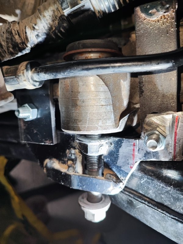

    Well, it's done.
    Had to create a tool to get the upper driver bushing out, it was simply not coming out with hammer hits, took a while to get the right setup, luckily there was plenty of steel laying around and it served as fab practice.
    Tool made it much less stressful and well, didn't want to bang something up. Removing the oil filter housing (was about time anyway) opened up a lot more angles to work around it too.
    Gonna use the chance to change outer tie rods with Coachbuilder's and also the ECGS bushing.
    Thread was a godsend. Thanks everyone :cheers:
    (no, its not pretty fabwork, flux core is messy and had to freehand a lot.)
    e6758c58-a35b-409d-a0ee-5c65d1960f36.jpg c0bc4811-ad9d-436c-ac62-f5298b478156.jpg
