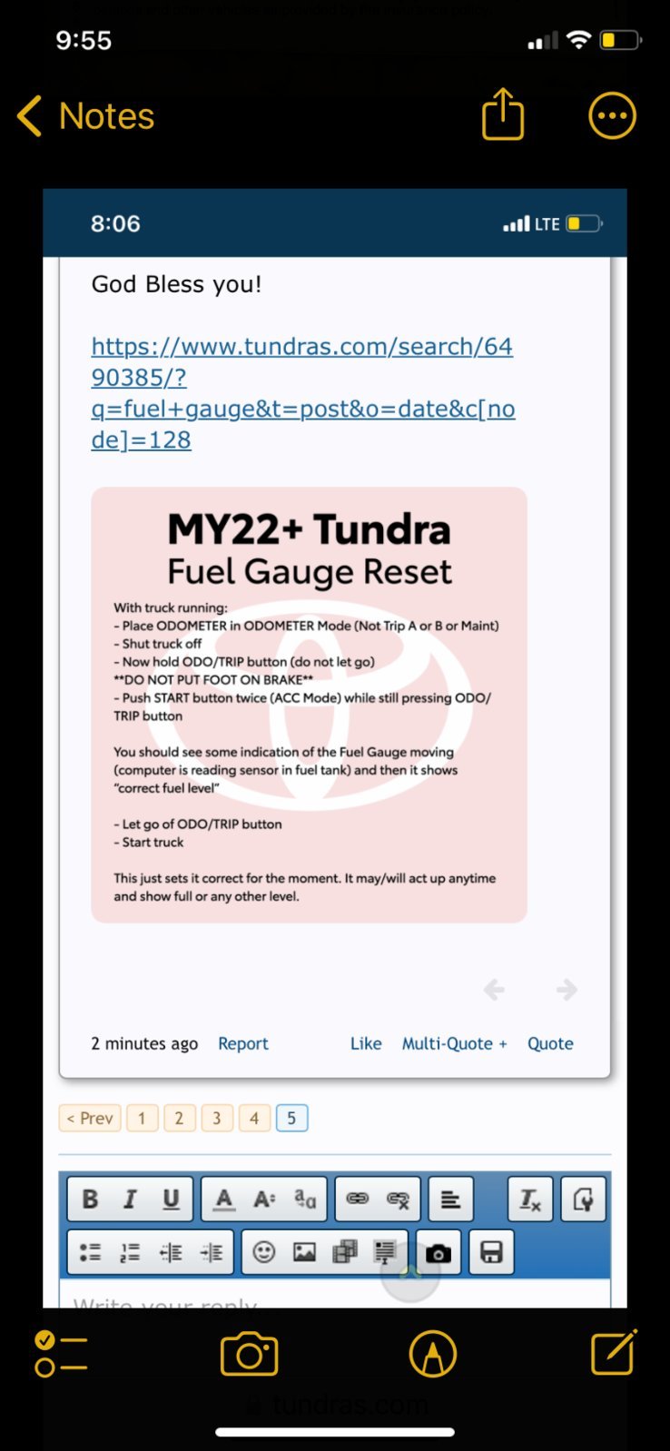

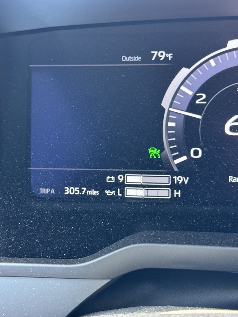

  6. Aug 2, 2024 at 6:58 AM
    #246
    AWPReefkeeper
    AWPReefkeeper New Member
    Jul 25, 2024
    #120327
    30
    Brent
    2024 TRD
    We just got our 2024 Tundra SR5 TRD, wife parked it in our drive way and went out next morning to find the gas gauge was full she text me and said "Thanks for filling my truck up last night." As I did not... we just learned about this problem...less than 1000k miles... HELP
    $50+K OFF road truck that can't park on a Hill! FN lame!
    Tundraman479 likes this.

  8. Aug 2, 2024 at 7:07 AM
    #248
    24TundraTRD
    24TundraTRD New Member
    Jun 16, 2024
    #118491
    40
    '24 CrewMax Limited TRD
    Unfortunately it's a common problem. If you can take it to the dealer while it's showing the issue, that's best. If not, take a picture showing the gauge and mileage. Do the reset and take another showing the same mileage with the updated gauge reading. Hopefully Toyota will issue a fix soon. Hopefully...

  10. Aug 2, 2024 at 7:39 AM
    #250
    AWPReefkeeper
    Jul 25, 2024
    #120327
    30
    Brent
    2024 TRD
    So if the wife drives it out of gas cause of faulty gauge I assume Toyota will replace the engine after it takes a shit!
    Thanks for the info on the reset, but should not have to do that constantly! So frustrating!
