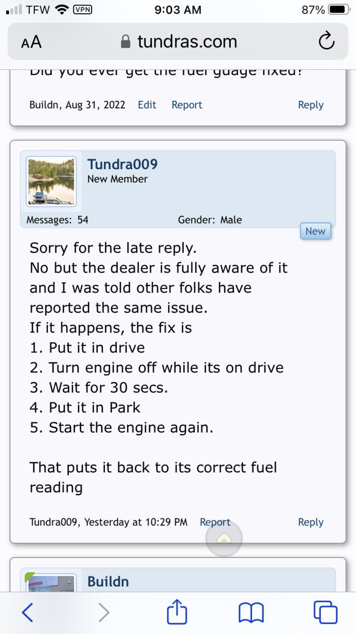

    It helps if you know the reset procedure. The fuel gauge issue happens to me occasionally when I park at a steep angle. Doing the reset helps as a temporary fix to get my fuel reading correct again. Otherwise, I have to fill up again in order to correct the reading.

    I do the other method, come to a stop and turn off the truck in D, wait 3 seconds and shift to P, 3-4 seconds later the gauge wakes up and displays the correct level.
    Seems easier to me :)
    This method is great too if you want to park but keep the radio playing without having to shut down and hit accessory and reboot everything for the radio.

    does this procedure work on the digital fuel gauge or only the analog one?
    the posted procedure does work on the digital gauge, just went out and did it on the tundra and it reset back to 1/2 tank from full.

    I did this procedure last year and it’s been working normal ever since.
    Thanks to Tundra009
