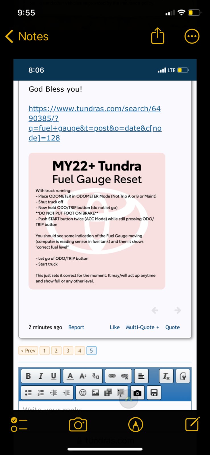

    Try this for the reset. Make sure u get paperwork or emails from dealer or it will hurt you w lemon laws.
    I took picture of my dashboard showing full, then did reset n it showed only 1/4 which was correct. Sent those to dealer. Now next Thursday a Toyota tech coming through and wants my truck overnight to download data. Pretty dumb distraction if u ask me. They know I’ll lemon law this one too. They don’t need r trucks to troubleshoot this 3 year ongoing fuel gauges that don’t work. Your dashboard pictures will show 4 important points —time n ODO n fuel gauge n DTE between the pics only taken minutes apart.

    It’s shut off in Drive (one push leaving ignition On), wait 10 secs til you see the gauge reset, restart and drive away.

    Thank you. I tried this 4 or 5 times with different wait times, but probably not 10 seconds. I also saw something about an odometer reset method. Hopefully I won't need to try it again.

    eddiefromcali
    eddiefromcali New Member
    Mar 14, 2022
    #75818
    3,104
    Eddie
    2022 Tundra Platinum
    100% Stock
    Doesnt work on digital clusters

    See my earlier post. Worked on my 2024. Odometer trickery.

    Very Interesting. First I’ve heard that. To clarify, The shut off in Drive method doesn’t reset the fuel gauge on digitals?

    I was able to get the shut-off-in-drive method to work on my 24. What worked was the odometer hack: get into odometer mode, shut off, hold ODE button, power button twice with foot off brake to go into accessory mode, keep holding ODE till gauge resets to accurate. I find myself doing this once or twice a week now.
