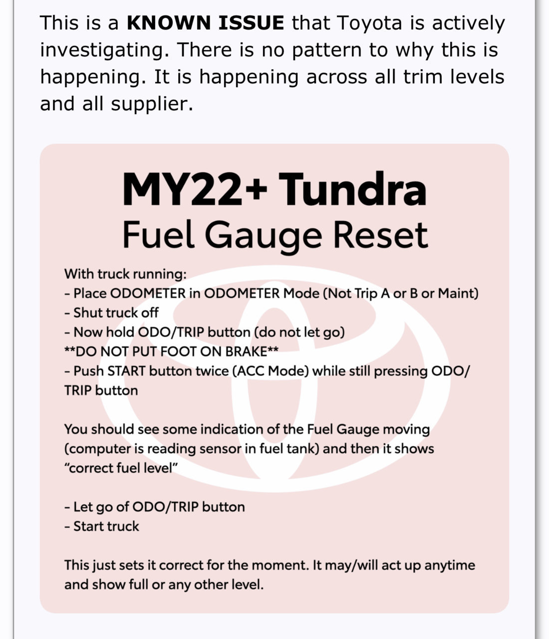

    What reset procedure did you use successfully on your 24? The 2 methods I've found in this thread (ODE botton and powering off in drive) don't work for me on my 24 platinum
    Second tank of gas and second time it's happened to me. First tank reset from 75% to full after parking in my inclined driveway. Second tank reset from 50% to full after powering on/off at the bottom of the boat ramp

    So I must not have been waiting long enough in accessories mode after holding down the ODE botton.
    Tried again just now, nothing happened so came here just now to check this thread while the truck was in accessory mode. Spend a few minutes reading, look down and the gauge is accurate again . Victory?

    Don’t bother with that method. This is simpler. Engine running, Hold your brake while parked on a level surface, put it in Drive, push the start button once to kill the motor. Stare at your dash, still all lit up, and you’ll see the oil pressure reset and then the fuel gauge will fall and reset to its correct level. Shift to P or N, restart the motor and drive away. I have to do it once to twice a month if I park overnight with 3/4 of a tank on our inclined driveway.

    My '24 just did this. How do you do the 10 sec reset?

    Nah. Just turn off the truck while still in drive and wait 5-10 seconds. You will see the gauge drop to the correct level. Way faster and more simple. Has worked for me every time.

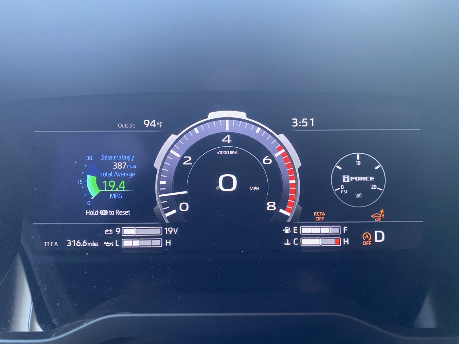

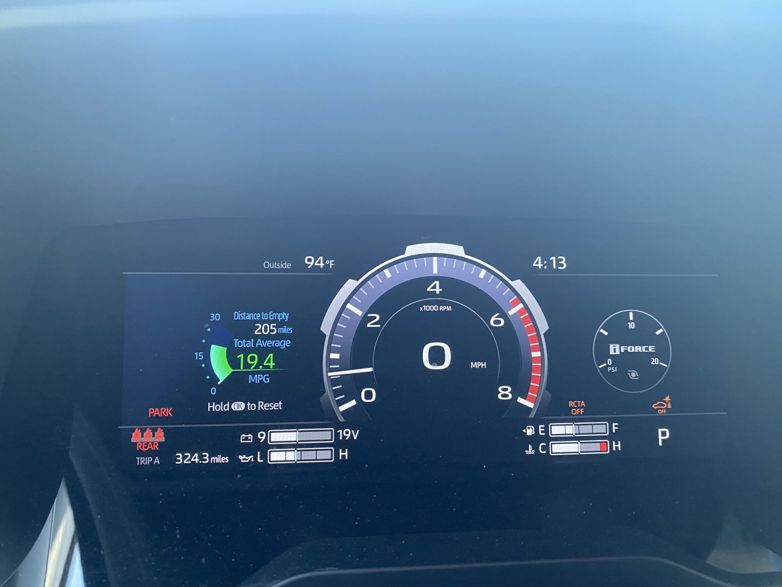

    Just waiting for a tundra to run out of gas on hwy n major crash. NHTSB might wake up then. Then since Toyota has known this problem for OVER 3 years they may be liable.
    My 2022 tundra was lemon law at 100%. Today my 2024 did it a 2nd time. Maybe lemon law up to a 2025 coming.
    Check out my dashboard. Look at 4 items.
    Dist to empty
    ODO readings
    Time
    Fuel gauge presentation
    Did the button sequence reset to get it back to normal.
    On a $70k truck we have no fuel gauge and to be safe out fuel tank is the ODO.
    first pic is when I started on level surface
    2nd pic is after the reset and is correct
