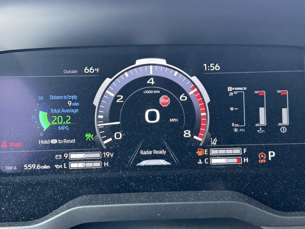

  14. Nov 17, 2024 at 3:48 PM
    #284
    TundraDan723
    TundraDan723 Not as new as I used to be...
    Mar 18, 2017
    #6838
    554
    2023 Celestial Silver Tundra 1794 TRD CM
    I could have easily gone 600 miles on a tank. My best was 559.6 miles and I only put 27.722 gallons in it when I filled up. If it's a 35 gallon tank, I'm pretty sure I could have hit 600 miles!!

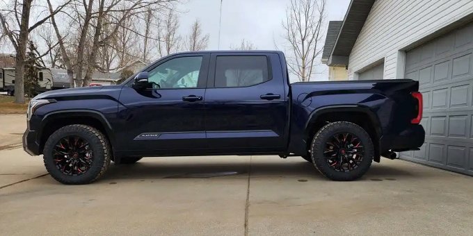

    at least every few weeks the fuel gauge would reset back to full parking nose first into the driveway. since our build date didnt fall into the tsb we just park nose down.
