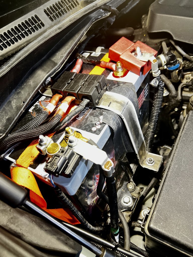

    No issues with my AGM. Less things hooked to mine than the guy above but probably just as much draw given my system I have
