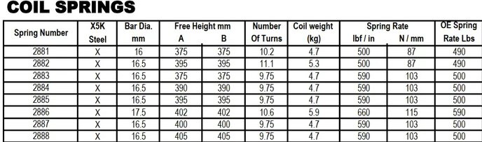

    Here it is, IIRC this was pulled out of a PDF they used to release regularly for their parts and stuff, and also gives the spring rates, #of coil turns, etc. This actually matches the numbers Montana posted above.

    Good info on these seems hard to find. Especially when our application is "off-label". Can't ask OME 1st gen Tundra-specific questions, because they don't make shocks or coils for first gen Tundras. But I guess the pound rating should be a question they can answer regardless of vehicle. Just checked the ARB site and yes, they all have a 590lb spring rate.
