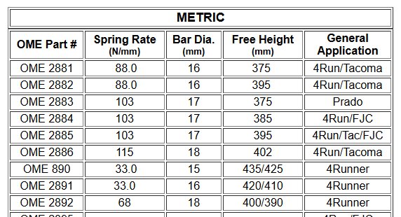

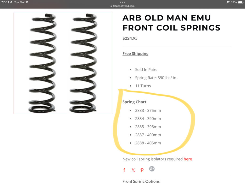

    This was my recollection from previous conversations, overall lengh was a little over ¼" diff between the two. Granted, I'm not sure if the spring seat is at the same height with 5100 at bottom notch, which is why I was hesitant to say whether or not the 4600 would work with, say, the 2884 or 2885. I know we have people on here who've used the 2883 with the 4600s. I want to say there's only like a 5-10mm height difference between each step up (2883>28884>2885) but ...

    #28

    Cool chart. So spring rate is the same across the board, only length changes to increase the preload it seems. I was under the impression the 2883 were 650# coils and 2884 were 700# coils.

    I've posted a chart in the past which shows # of turns, and includes the 2887, but this should get you the info you need. I'm not sure where the info above came from, this confirms my recollection of ~10mm height difference. I'll try to find the other chart in a sec.
