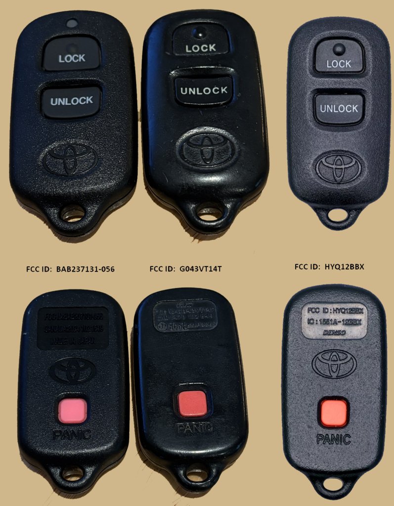

    This is another good thread with internals and fob troubleshooting instructions: https://www.tundras.com/threads/keyless-entry-issues-solved.148105/
    Here's a picture of both styles, with the FCC ID on rear, I should probably edit that thread I just linked with this pic.
    With LED (ending -056) worked for me, and I was able to program the middle one (starting G043) to mine as well. And the last one, ending in "BBX", we have confirmation from another 2005 AC owner it supposedly worked for his truck, and also a 2006 DC owner, and another DC owner, and even another DC owner, but the part number traces back to a RAV4 I think? And it comes in some interesting variations like so.

    08191-00922 was the ticket, it's the one with the LED. Works great

    Curious, what's the FCC ID on the rear?

    BAB237131-056

    Wild. So the OEM part with that FCC ID worked, but scAmazon-purchased aftermarket ones wouldn't?

    Yup. Same FCC ID on both, Amazon one didn't have the LED is all

    Bizarre. Technicall with same FCCID, should be the same internals. I did notice while tearing down mine, the one w/o LED on the plastic shell actually did have LED on the circuit board. But ... yeah, time to return to scAmazon :rofl:
