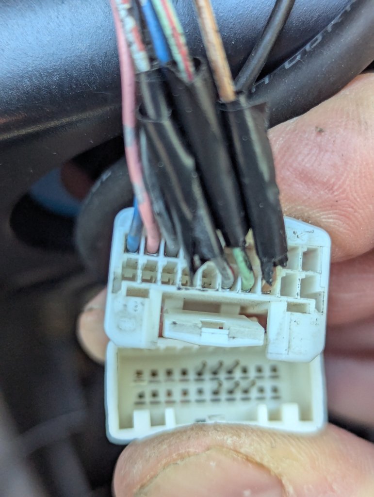

    When connecting the harness on the dash side, I believe this is the ASCW connector on the bottom of the photo and the pins do not match the factory pins at the top of the photo.
    I vaguely recall reading on here that this might be a Metra error and their connector needs to be repinned?
    And I'm going to wrap that electrical tape with Tessa tape. I was repairing the wires when I found the insulation stripped but the wires not cut.

    Metra issue was with another harness entirely, non-JBL amp bypass IIRC.
    In this case, I think Metra did correctly. Note the pins are in alignment. The wires they're not including, I believe are going to be the TX -/+ wires and the IVO +/- wires which are controls for the JBL amp operations internally.
    EDIT: Here's a pic, compare the wire colors, I deffo see the pink/blue in the top-left of the OEM connector at positions 12 and 11, I presume:

    Wait, you just mentioned "dash side" and "ASWC", so it's possible I missed something.
    The pieces you're holding in your picture don't match what I'm expecting. The top connector in your hand looks like it's for the radio, to go to the Metra radio harness, not the ASWC.
    G_unit3000[OP] likes this.

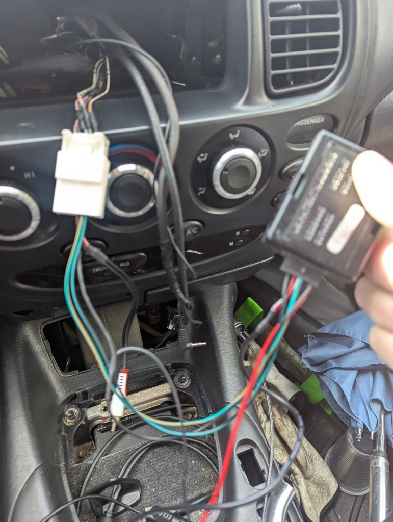

    I snapped another photo for orientation. I believe it is the ASWC.

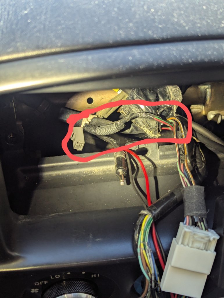

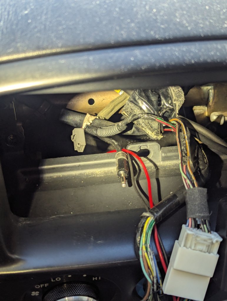

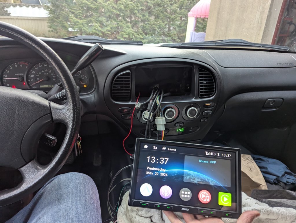

    When I connected the headunit to test it, no power. Nothing turned on. When looking through the connections, I see this below which looks like a bit more hackery?
    There is a small connector inside the dash that is taped to the larger wire harness and also appears to have wires originating form the larger wire harness.
    Any idea about how to proceed?

    "You *MUST* plug in the dash bezel harness (that powers the clock etc.) for the radio to get power in most (if not all) our models."

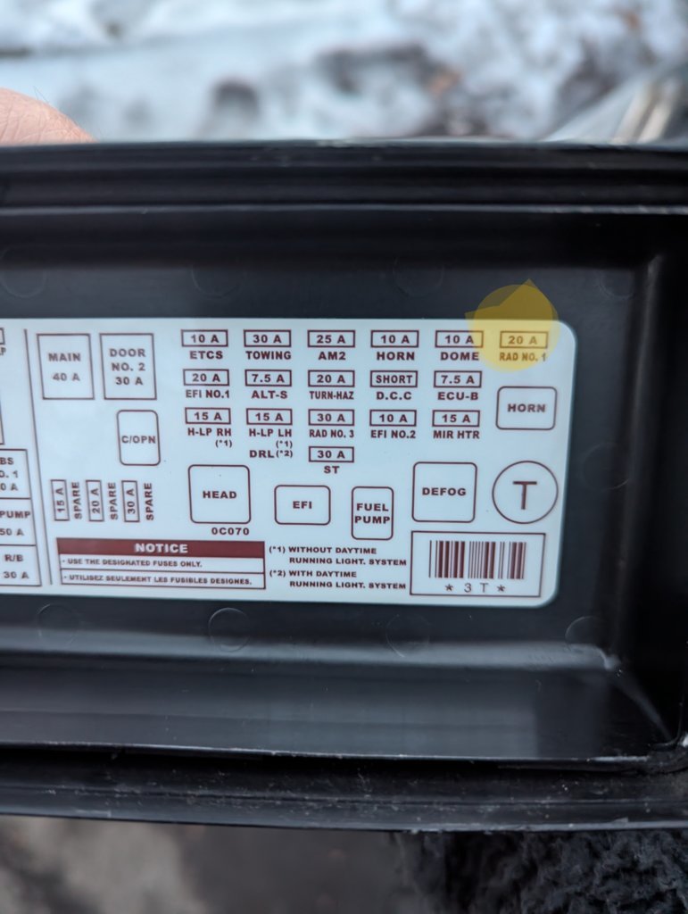

    In case it's a fuse issue, there are 2.....7.5A RAD NO. 2 and 25A RAD NO. 1.
    If you wish to check for voltage at the R14 connector, it's pin 1(L-Y) and pin 11(GRey with key in ACC).
    That small grey connector is R30 for those that had OEM Navigation radios.
    For your 05 DC, it should have at least 2 conductors at that connector....one for speed(SPD) from VSS and reverse(REV). Colors should match pic below.

    This vehicle has a single din radio that functioned when I bought it so hopefully I can get this sorted.
    Dash bezel harness is connected and clock functions.
    I will check the fuses again. I had previously tested all of the fuses when trying to figure out why one of the cig lighters ( by my right knee) didn't function. I still don't know why.
    Thanks for info on R30 connector. This apparently is not part of the problem.

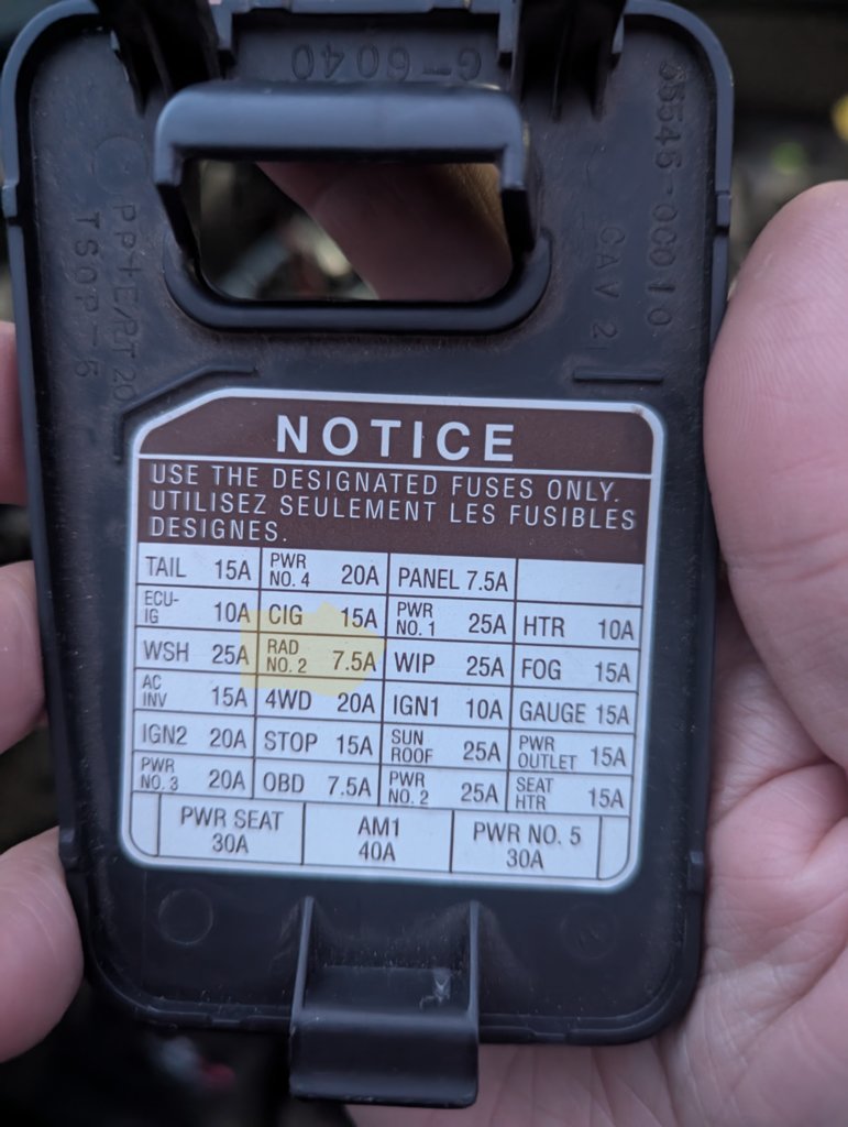

    Thanks guys, finally got back around to figuring out my headunit and I've got power! Two blown fuses.
    7.5A RAD NO. 2 - blown in the interior fuse pane.
    25A RAD NO. 1. - blown in the larger engine bay fuse panel.
    Finally got it powered and sound going to all 4 doors.
    Last little hitch that I'm having is that the SWC harness (metra 70-8114) female white connector doesn't fit properly with the factory side male white connector (R15). I've been filing down the female side but connectors will only go about half way together. I've read about this same complaint on Crutchfield's site and elsewhere. I've taken quite a bit of material off the connector but not enough yet.

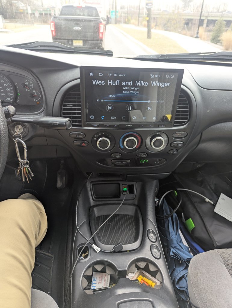

    I mounted the headunit yesterday and I feel like I am back in the 2020s again. The vents arent too covered by this 10.1inch floating screen. I still have to install the USB plugin into the cigarette lighter location by my right knee. Somehow I misplaced the large plastic nut that threads onto the back of that USB plugin. I rewired the cigarette lighter to the USB charger with a green voltage readout into the blank in the center console. I also need to install the rear camera which is now sitting on my front seat.
    Speakers in all 4 doors sounds great with plenty of volume. Thanks again @shifty` and @BubbaW .

    I am not seeing lights on the Axxess box so it seems that there is not enough engagement of the white connector to power it. If it lit up, I would just zip tie it together and call it good.
