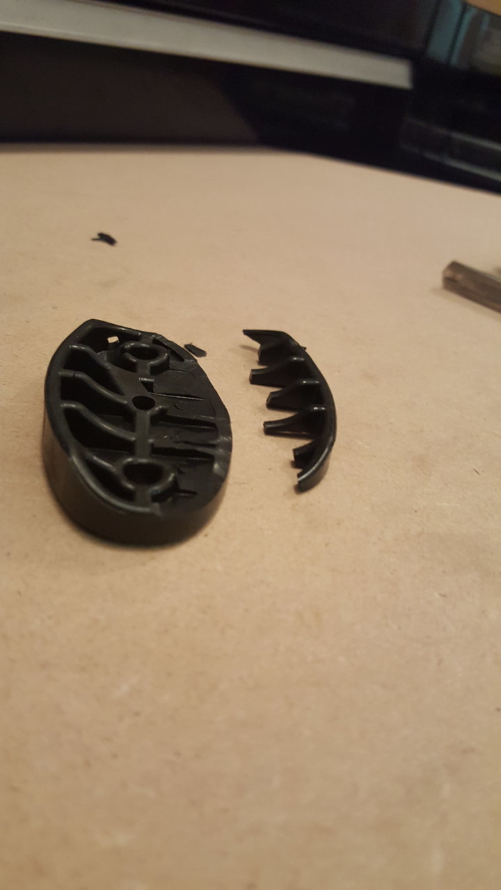

    My inly compliant about the rock lights is they don't cone with a flat mounting pad, just one for a bar. What I did was use this to my advantage and trimmed one side off, turning them into angled mounts.
