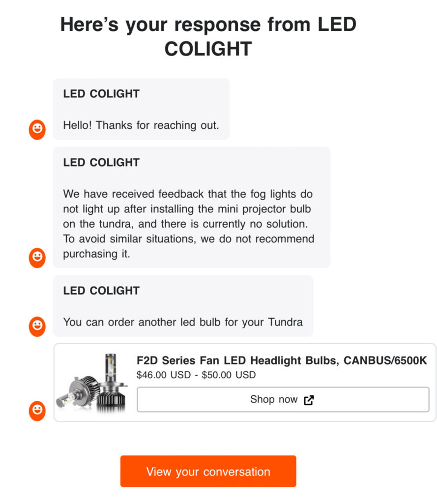

    FYI I did get the following response from them:
    The link goes to this bulb option:
    https://www.led-colight.com/products/f2d-series
    Obviously others here have solved the fog light issue with resistors, so that doesn’t seem insurmountable, but thought I would share since they did reply so promptly.
    edit: wow I had a bear of a time editing that on my phone :rofl:

    I bet if you tell them you read on a Toyota Tundra fanatic forum that installing resistors on the headlights solves the no foglight problem, and ask if they can send you resistors, they may actually do it. Not only to make a happy customer, but also to have a solution to the problem.
    BraveWAY, who was selling the exact same light bulb (came from same factory) was willing to send me resistors when I brought it up with them.
    I wouldn't use the other bulb they linked. It won't and doesn't function like a mini projector. It'll scatter the beam everywhere and blind oncoming traffic. You'll be "that asshole".

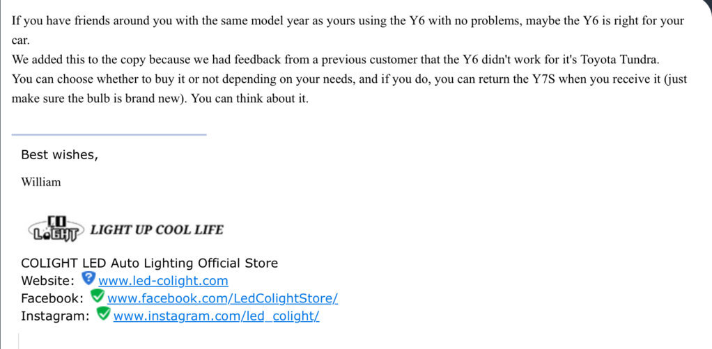

    I've been in conversation with them since receiving the Y7. But it's been an unsatisfying conversation. Here's their last email response, when I asked about the new language, and whether something had recently changed, since I know a lot of Tundra owners run the Y6:
    Pretty much tells us nothing. I'm not sure what I'm going to do. Now that the Y6 has a fan, I might look into their other non-fan options. I would have never considered the fan, except for `shifty's hesitation on them.

    Yeah. In their last response they gave a little more leeway, but basically said every little thing would reduce the refund amount. Signs of use? Original packaging? Etc.
    Alright that conversation with the company in Auburn's post wasn't there when I posted my last response. Someone not on this site complained about the fogs, so they changed the website to say it doesn't fit out trucks. That makes it pretty clear. Nothing changed, so they'll still fit.

    So from what I see . . . no Y6 'classics' (fanless) available . . . and only the Y7 tri-color mode-cycling versions ?

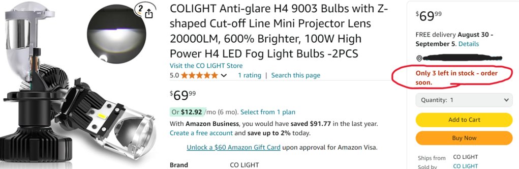

    Well unless I'm looking at it wrong, CO Light does still have some (6 available, allegedly) of the fanless Y6 available from Amazon, but not discounted like they are on their own site. Well, doesn't say Y6 anywhere but sure looks like them:
    https://www.amazon.com/gp/product/B0D9VFRLX4

    The one I linked doesn't show US availability. Better off ordering the ones from Amazon with some semblance of a return policy.

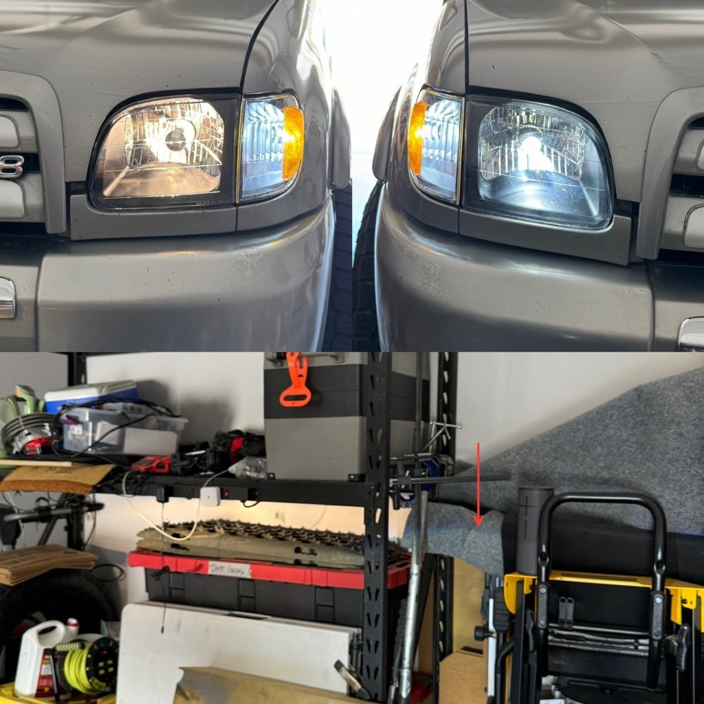

    So I just threw in the halogens in my spare housings for fun. The lighting temperature difference in the turn signal will not let my OCD off the hook so I put the colights back in and left it alone. ISO is locked on all 3 pictures.
    Philips racing vision gt200 halogen bulbs
    colight mini projectors
    It’s pretty obvious that the halogens are brighter. The red arrow shows the cutoff on the colight bulb. Yeah it’s not that nice white LED but it’s definitely superior to the colight in spread and output. I know I am suffering on output with the black housing, but it’s apparent who’s the winner here. I’ve got the harness upgrade for more output on the way just to test see if the output is enough to overcome my ocd.
    G_unit3000 likes this.

    Dang how'd you get your trucks parked so close together?? :D
    Generally, I don't prefer LED lights anywhere. But the light output vs power draw is hard to argue with.
    Yeah that halogen light looks way better.

    Going, going...:rofl:

    They owe me some commission!
    @CO LIGHT - eh, was worth a shot!
    Update: ha, now the Amazon page says 10 left in stock.
