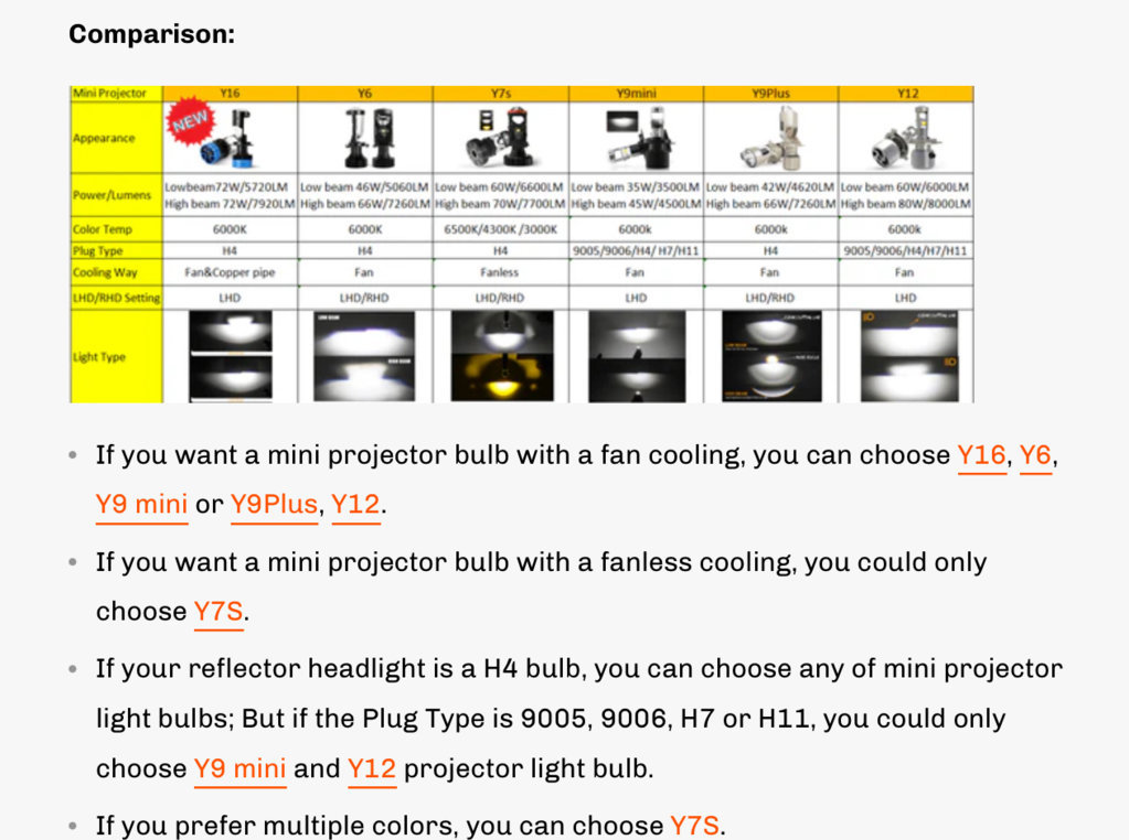

    I'd be interested to hear from a larger sample size about people's experience with the fans on these. How common is it for them to fail? Obviously `shifty knows his stuff, and if it wasn't for his warning about fans, I would have never considered avoiding them. It's possible the newer model Y6 with a fan is a perfectly good, long lasting headlight. I don't know...
    Looks like the Y7 is the only fanless model, currently. I kept mine as backups. I love the idea. But the fact that they cycled through the different colors just from turning my high beams on & off was a deal-breaker for me. I can make them work if I had to, but they annoyed me. Otherwise they were great. It was just that they cycled through the different colors when I didn't want them to (using high beams) that annoyed me.

    I'm not sure what people have been buying recently, but the bulbs that I bought look identical to the CO Light Y1 series. These: https://www.led-colight.com/product...ightest-h4-9003-lhd-projector-headlight-bulbs
    I've had mine in my truck for more than a year and a half now, and they still work great. I purchased mine off of Amazon, sold under the BraveWay name, but as far as I can tell they are identical to the CO Light Y1's. They're likely from the same manufacturer in china.
    I believe the Y6's work fine but they have small cooling fans instead of large heatsinks, which is another failure point.

    Here's their comparison chart, grabbed from this page, which is the best explanation you'll find of the differences. Better than nothing...
    Neo[OP] likes this.

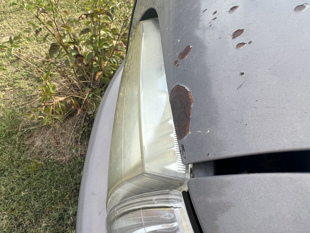

    This is a good picture to highlight one big difference between the earlier-year trucks with metal bumpers and the later year trucks with plastic bumpers: In earlier years, the entire housing pivots up/down. In the later years, the housing stays stationary, there's apparently something mechanical inside the housing that pitches the seat for adjustments.
    G_unit3000 likes this.
