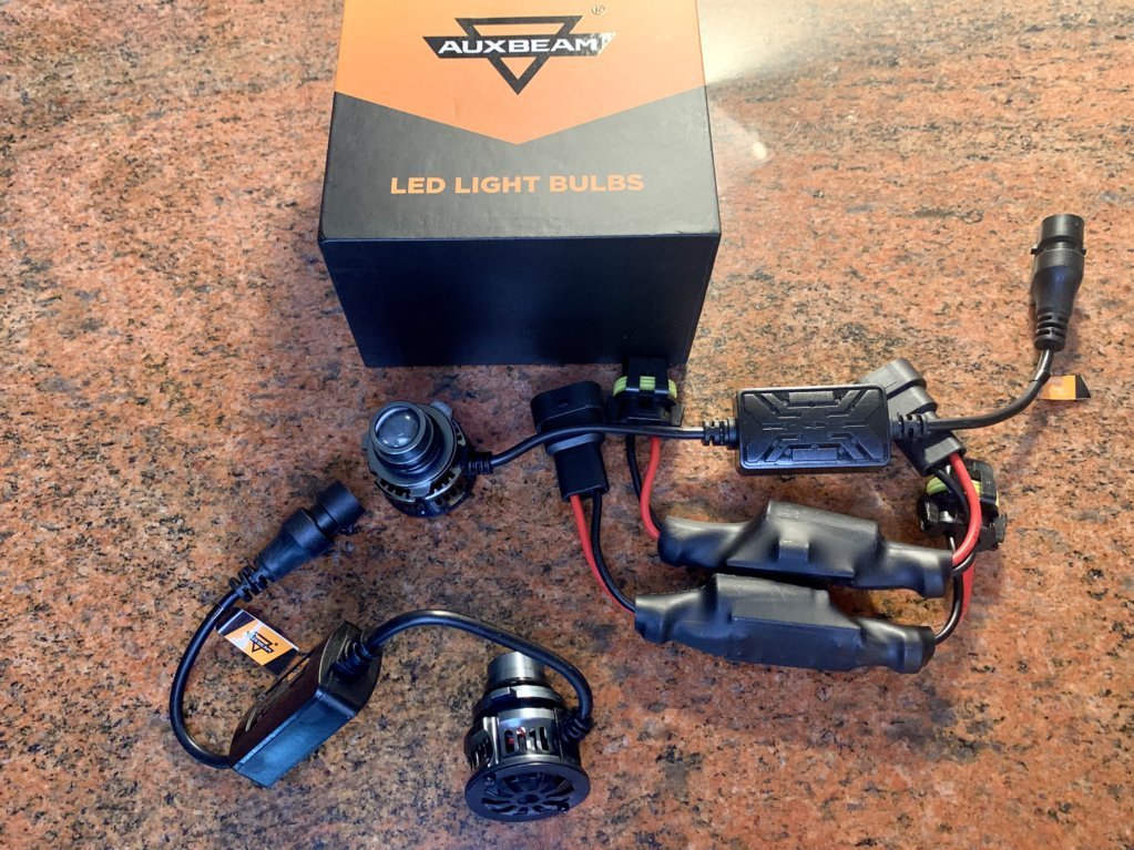

    I ordered the Auxbeam mini-projector LED fog light bulbs and the resistors that @shifty` posted earlier in this thread.
    They arrived yesterday. They seem built well enough for $50. I'm not crazy about the 'cooling fans' , but what are you gonna do?
    The included instruction pamphlet doesn't seem specific to these bulbs and is very generic.
    I'm very much a newbie to LED, or any tech for that matter . . . a question I have before I climb under the truck is that I don't see a 'top' or 'bottom' for these bulbs. Other models of this brand include an allen wrench to loosen a set screw for clocking adjustments . . . but these don't have that.
    Does anyone know if these are these just a 'spray pattern' with no top or bottom ?
    Looking closely at the lens and body, I can't see anything that would give me any orientation.

    Projectors are normally for driving and not fog light patterns, interested to see the light pattern for these

    Maybe they aren't a traditional 'Projector' and more of just a spreader beam through a lens.
    I tried calling their customer service to ask a couple questions with no answer 'shocking' . . . so I sent an email.
    I'll report back more findings here if anyone cares.

    Well, I got a brief reply email from Auxbeam… they’ve been discontinued. Wonder if I should even install them …. Hmmmmm

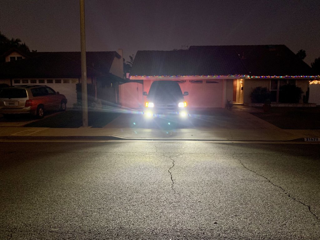

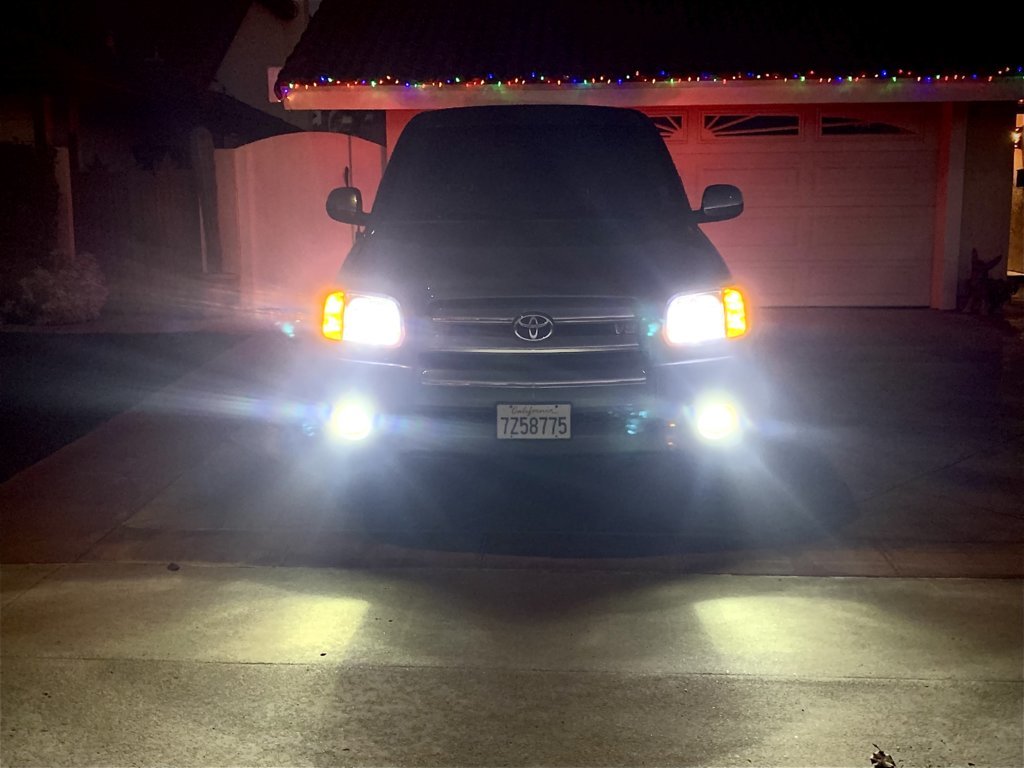

    Well I finally got those Auxbeam mini-projector headlight bulbs installed.
    I had purchased the resistors with them as well . . . but when I plugged everything together . . . no dice.
    I took out the resistors and plugged the bulbs straight to the factory plug and everything works as should.
    Just a guess, but 'maybe' since I already had put in resistors at the headlights, and the DD LED Flasher relay as well, there was no need for relays at the fogs . . but who knows.
    I'll update with a picture tonight . . . but so far in the garage they appear much brighter then the halogen, and the color match is much much closer. 6500 headlights, & 6000 fogs.
    Still not crazy about the 'cooling fans', but we'll see . . . with the truck off you can just barely hear them running if you're standing at the hood.

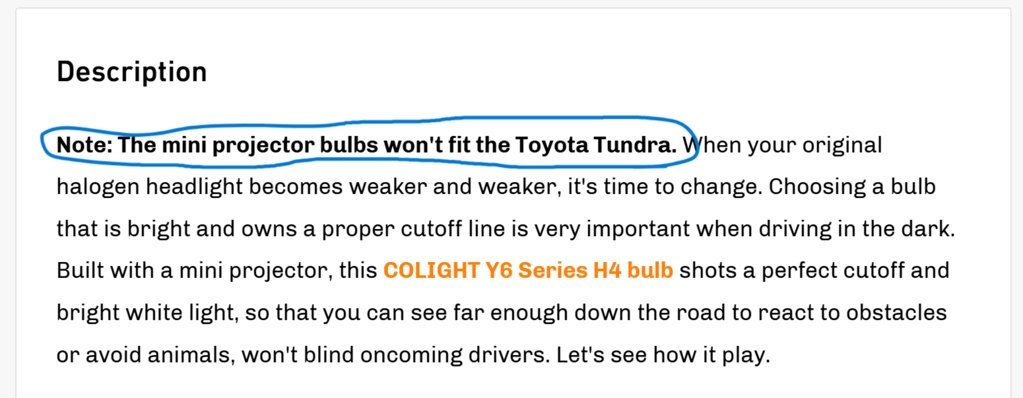

    So I took a look at COLight's website just because I was curious. Check out what I found, this is the description for the Y6 bulbs:
    Maybe that's why you're having issues. The bulbs that I got look the same as the Y1 series.

    We discussed this one quite a while ago. Maybe even in this thread? It's when we were talking about the Y7. The info from CO is wrong.

    Ah. That makes sense. Maybe I need to be refreshed- but there is a reason that the Y7 or Y9 is better than the Y1, which is what I have on my truck? My Y1s have been flawless so far.

    Yes we talked about that statement on their website, in this thread. I asked them about it. Someone (maybe multiple people) reached out to them with issues, likely some of the same issues people here have had, so they added that language. But as we've found here, these headlights are more or less plug & play for some, but not others. Others have definitely needed to make other modifications. They installed and worked with no issues for me.
