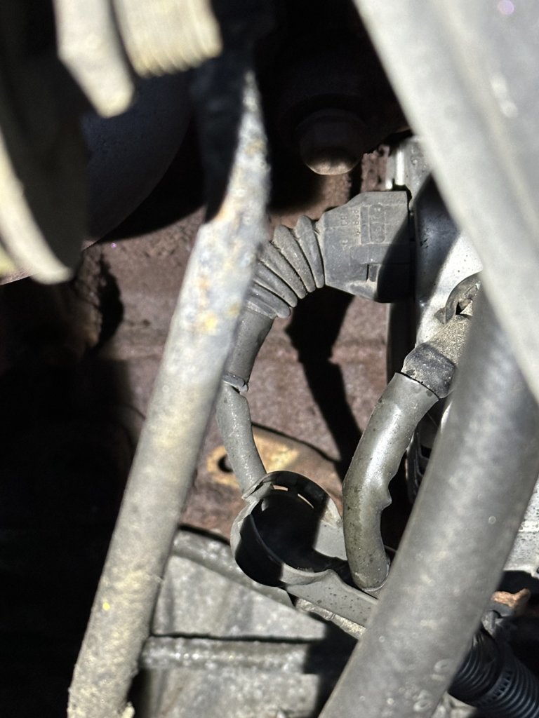

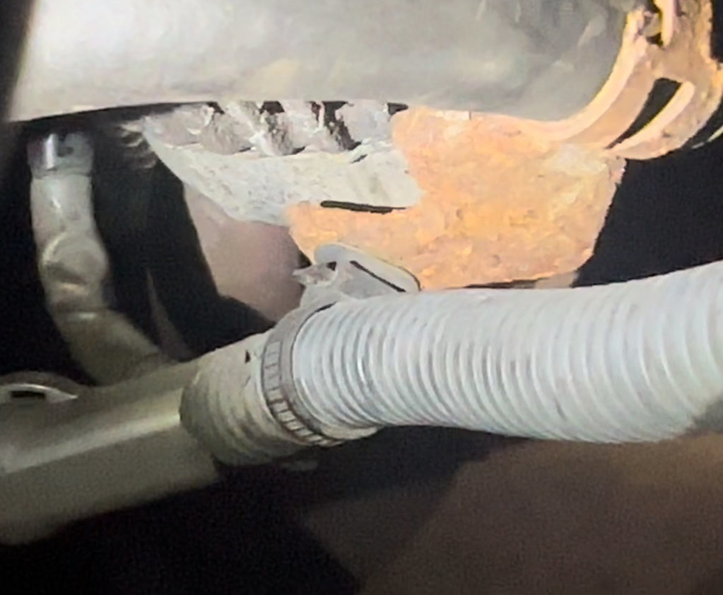

  16. Dec 6, 2024 at 12:42 PM
    #46
    Jack McCarthy
    Jack McCarthy [OP] It’s always the fuel filter
    Nov 2, 2020
    #54409
    10,971
    Bill
    North of Boston
    02 Tundra AC SR5 V8 4x4
    Well, the good news is all the bolts move freely to take off the PS pump and old alternator. The tricky part is trying to figure out the best way to get that positive connector off the old alternator without breaking it.
    Suggestions?
  17. Dec 6, 2024 at 12:49 PM
    #47
    shifty`
    Jun 20, 2020
    #48239
    31,487
    ATL
    '06 AC Limited V8/4WD
    I prefer to come in from the wheel well. You need to pop off the apron in front of the strut, and potentially kick the wheel full lock, but ... it really opens things up.
  18. Dec 6, 2024 at 12:50 PM
    #48
    Jack McCarthy
    Nov 2, 2020
    #54409
    10,971
    Bill
    North of Boston
    That’s what you’re seeing when I took the picture through the apron hole. Already did that.
  19. Dec 6, 2024 at 12:51 PM
    #49
    shifty`
    Jun 20, 2020
    #48239
    31,487
    ATL
    Dunno then, I just pinched and popped it off, IIRC. I swapped in/out my alternator twice. And will probably do it a 3rd if I end up getting the Sequoia alternator.
  20. Dec 6, 2024 at 1:38 PM
    #50
    Jack McCarthy
    Nov 2, 2020
    #54409
    10,971
    Bill
    North of Boston
    Well hopefully I can push the rubber boot back to access the pinch tabs. I need to use both hands to put enough pressure on the tabs.
    To get the wire hose (loom) clamp off, did you just blindly use needle nose pliers to pinch and pop it out from the underside of the metal tab hole?
    Edit: I guess I’ll try this method to see if it works.
    https://youtu.be/gpZLU2ftDXo?feature=shared

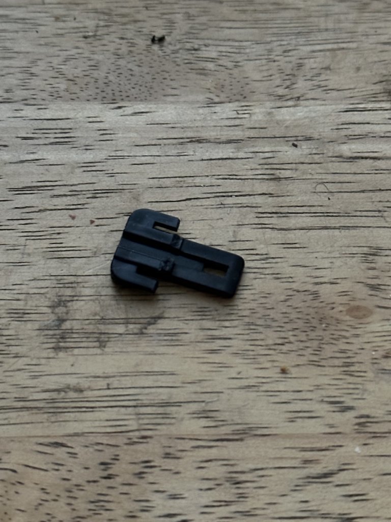

  22. Dec 7, 2024 at 11:08 AM
    #52
    Jack McCarthy
    Nov 2, 2020
    #54409
    10,971
    Bill
    North of Boston
    :( Talk about brittle. That was just pushing it down when it broke off. Still took a good yank to pull the connector out after it broke.
  23. Dec 7, 2024 at 12:57 PM
    #53
    bfunke
    bfunke Tundra Curmudgeon
    Oct 13, 2019
    #37321
    2,721
    South Carolina
    2018 SR-5 CM 5.7, 2000 SR-5 AC 4.7L
    I’ve had several connectors get brittle and break. Toyota does sell them so you can repin your wire into the new connector. The trick is finding the right part number. Some of them are stamped with the Toyota part number in tiny letters. @daveeasa I think has some alternate sources for Toyota connectors IIRC.
  24. Dec 7, 2024 at 1:09 PM
    #54
    daveeasa
    Dec 2, 2020
    #55605
    4,209
    David
    The alternator 3 way is a Sumitomo. Corsa has it. I think the 4 way too. Males are the harder ones to find. Terminals should be ok even if the plastic connector is cooked.
    G_unit3000 and Jack McCarthy[OP] like this.

    Dave - I always have trouble figuring which color (size) seals to get for the wires on our trucks. Any rule of thumb there?
  27. Dec 7, 2024 at 1:21 PM
    #57
    Desert Dog
    Desert Dog Nobody rides for free
    May 29, 2021
    #63643
    1,338
    2001 SR5 AC 2WD 4.7l
    Bilstein 5100's, SPC UCA's, ATS HD leaves
    @daveeasa
    Another BestGen forum legend worthy of recognition, imho.
  28. Dec 7, 2024 at 1:22 PM
    #58
    daveeasa
    Dec 2, 2020
    #55605
    4,209
    David
    You wouldn’t need seals if terminals are ok but a micrometer on the wire will help.
    sumi and yazaki make compatible 090II seals, one has 4 sizes and one 3. The second to biggest is 16-18 gauge and the biggest is 14 gauge. 20 would be best with middle (for the 3 size) or 2nd to smallest (for the 4 size) and 22 is the smallest seal. The small blue ones are fine with 20 gauge too. It’s not super critical to be perfect w seal size but it’s harder to stuff a too-small seal on.
    @Jack McCarthy I had my stock alternator rebuilt and could send it to you but I’m out of town through Wednesday. But I did that preventatively for something exactly like this. Wish I had seen your post earlier last week.
    Jack McCarthy[OP] likes this.
