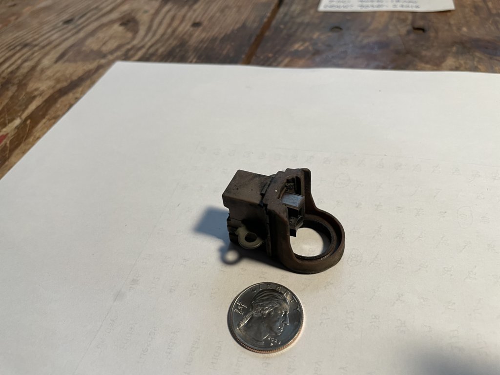

    There's a pretty good chance that all your alternator needs is new brushes. A $20.00 part. And an easy swap out. It does require that you pull the alternator and put it on the workbench. But you're gonna do that anyhow which every way you go.
    I'm on the original factory OEM alternator in my 1997 T-100. I bought it new in 1997 and it has about 275,000 miles on it. I just recently (preventatively) put in a 2nd replacement set (so 3rd overall counting the original) of alternator brushes.
    Here's what the brushes look like for my 1997. Yours would be similar.

    Agree. I had a Surf (4R) in Japan and that’s all my alternator needed. Brushes were really easy to replace.
