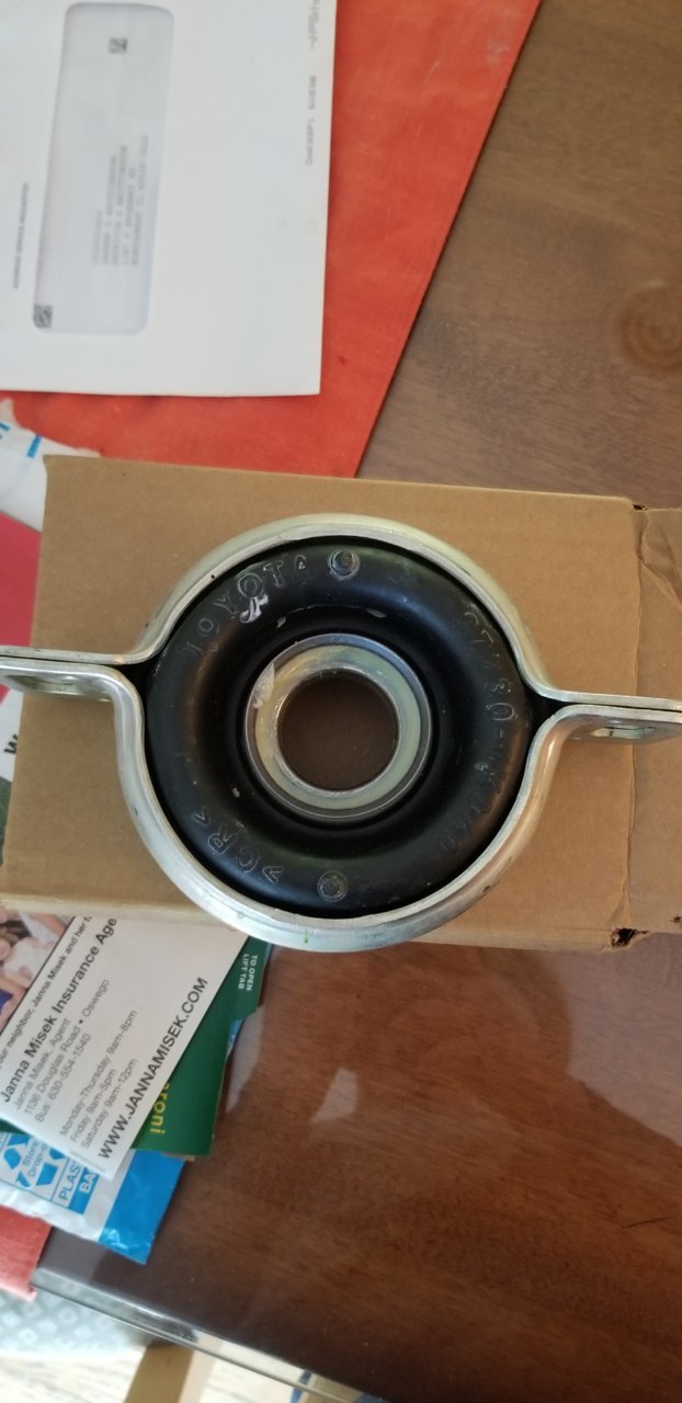

    Just wanted to be able to use my new torque wrench and torque it down to 134, back it off one turn, then to 64 like the book says. Guess i wont then. How do u tighten/loosen the nut when its not all removed?

    With it hooked up still on the Transfer Case. The torque forces from the Transfer Shaft with engine power are far greater than the torque wrench so you should be good? Thats how I did mine. So far so good. Crimp that castle nut after torquing.

    Alright sweet. Yea do u crimp it with pliers? And i notice the threads for the nut has a big "gash" in it on the bottom, do i need to do anything special cause of that? And how do i know which way to put the new bearing on? Thanks for all your help pro hand model

    Nvrm, the bearing has arrows on it. I'm assuming you put it on so the arrows face forward

    The nut is a shield nut and you kink it with a small chisel or flat head screw driver. It keeps the underlying nut from turning. Put it back on like you took it off. Study your pics. The single hole should face down.
