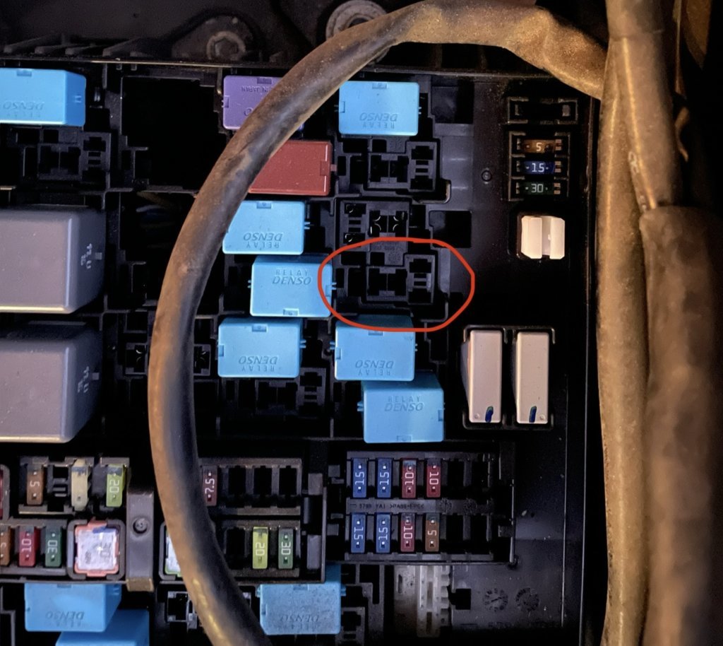

  8. Dec 30, 2024 at 5:38 PM
    #38
    mgates32
    mgates32 New Member
    Nov 26, 2018
    #22245
    50
    Mitch
    2018 Toyota Tundra
    I was getting ready to do this but it appears the slot where the relay goes doesn’t have any metal contacts in it? The relay just sits and and pulls out. Ran out of sunlight so didn’t get to look at it in depth, but am I missing something here to complete this?
  9. Dec 31, 2024 at 7:26 AM
    #39
    Bowzer
    Bowzer New Member
    May 16, 2022
    #78447
    76
    I bypassed the fuse box and just direct wired an external relay when adding the Fogs to my SR. Certainly would've been nice to use the wiring already in place but have not taken time to go back and look further as I also noted the contacts are not included to the SR fuse box.
