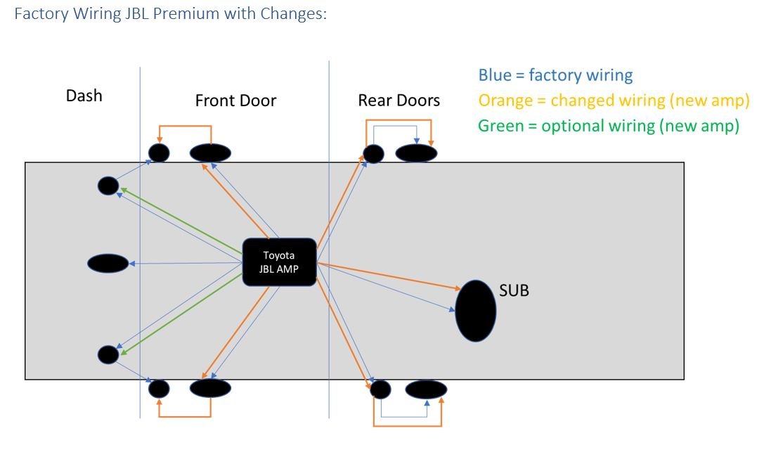

    Here's what I have:
    Screen Shot 2022-09-02 at 12.53.04 PM.jpg Screen Shot 2022-09-02 at 12.53.22 PM.jpg
    Screen Shot 2022-09-02 at 12.53.13 PM.jpg Screen Shot 2022-09-02 at 12.52.53 PM.jpg
    My plan was to connect the corner dash & front doors to front L&R, back doors to rear.
    My confusion is which way is out & in as it seems counterintuitive.
    Thanks

    Ok, don't over think. I believe the TO3 kit comes with harnesses for other car applications. Toyota harness to DSR harness, then RCA to AMP and then speaker wire to stock wires.

    JBL Wiring:

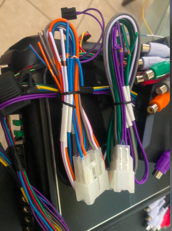

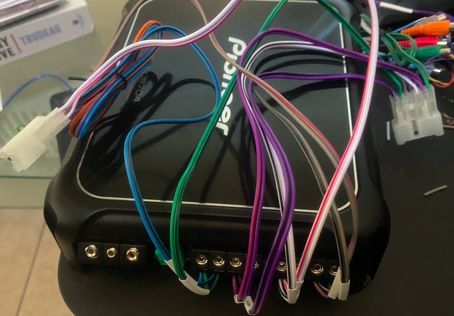

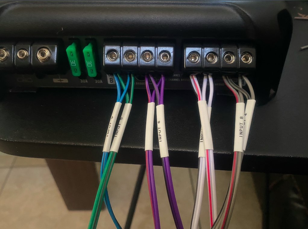

    I have this, TO2 connected to the Pioneer.
    Now these go to the corresponding factory amp harness under the seat, RCAs power, remote power on & ground to the Pioneer & I'm done? Wish it were not 111 now.
