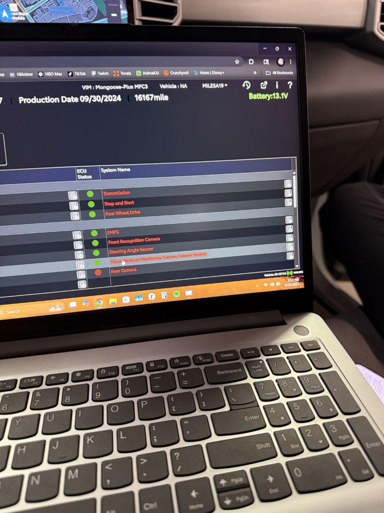

    So i did some digging on GTS+(formerly techstream) today. Figured out how to turn on the MTM camera views, but I was unable to find the combination switch( what Toyota calls the MTS/DAC knob/switch ) in the systems menu.
    Is DAC/Crawl only an option on hybrid trucks? If so, it would make sense that the data for this module would be accessed through the hybrid system menu. But I’m stumped. I couldn’t find this module in any other system menu, inducing 4WD, Transmission, EPB/BRAKE, nothing.
    If only i knew what sub system it was in, I’d be able to modify its settings just like the pano camera.

    It’s an option on both hybrid and non-hybrid truck, but it’s specific to TRD OR and Pro models. The TRD rally and the 1500 limited edition also have it, but they are special editions.
