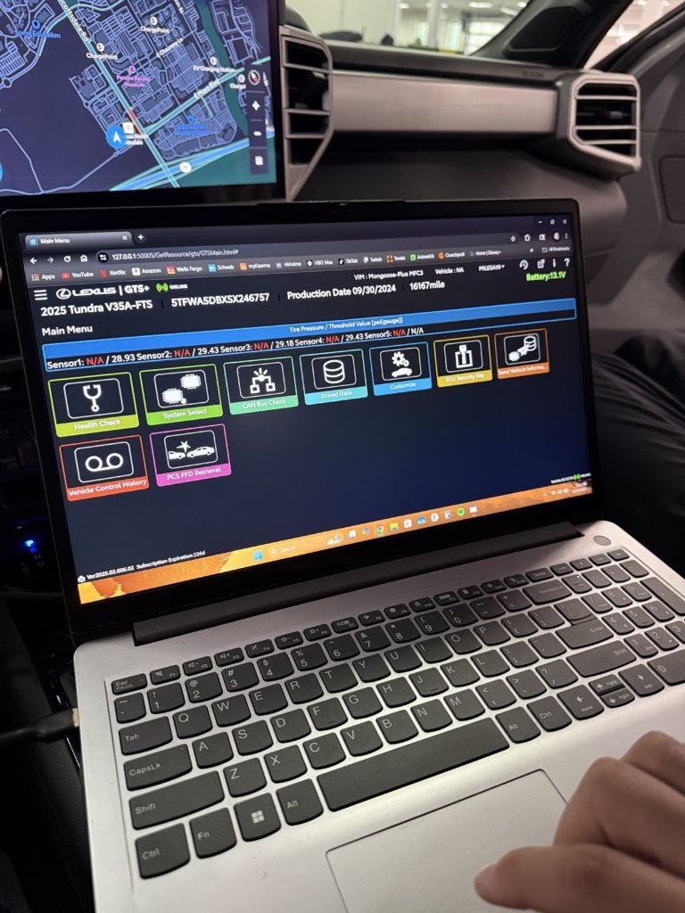

    I have a 2025 limited, with panoramic view monitor, but no multi terrain monitor. Everyone here has been saying that it’s impossible to enable it.
    So, I believed them.
    Until one day, I read a thread about someone having their trailer brake controller replaced, and then magically losing their MTM. This made me curious. So I hit up my homies at the Lexus dealer, and they let me play around on GTS+ (formerly techstream) and after about 2 hours of fiddling around, I finally discovered how to do it!
    To be clear, your vehicle needs to have the panoramic view monitor(the 360 top down camera) to enable this function if it didn’t come with it from the factory.

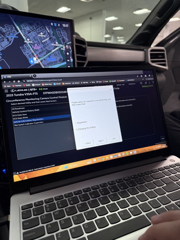

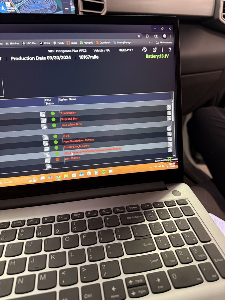

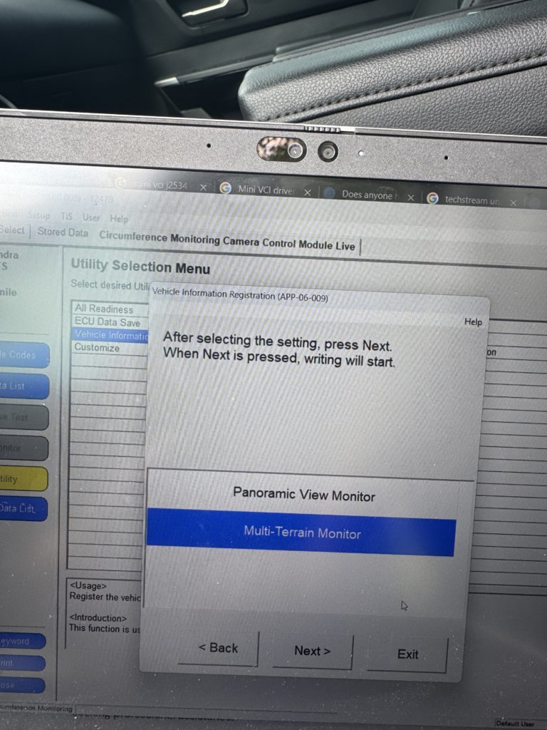

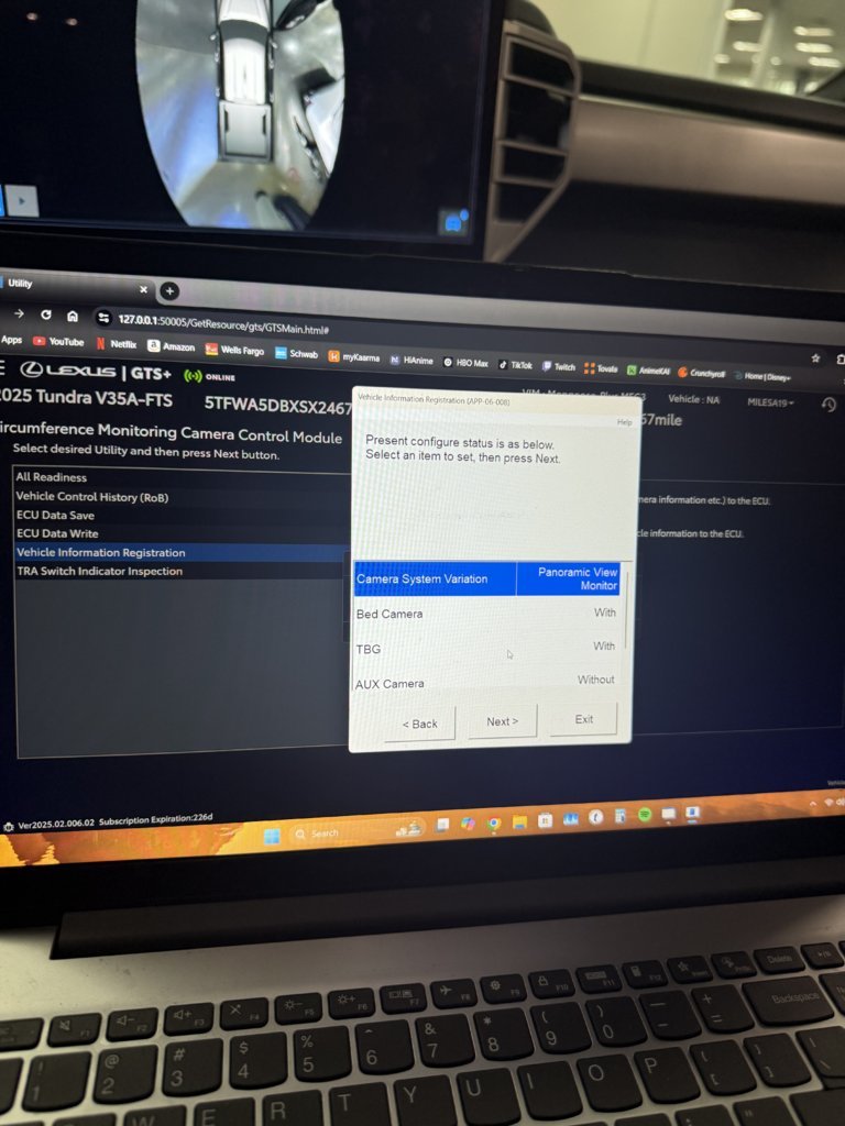

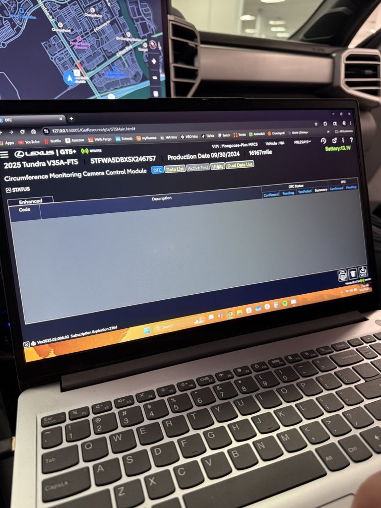

    Step One: Get your vehicle connected to GTS and get to the main menu and click on system select.
    Step Two: Click on Circumference Monitoring Camera Control Module

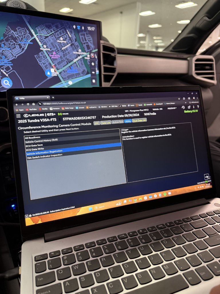

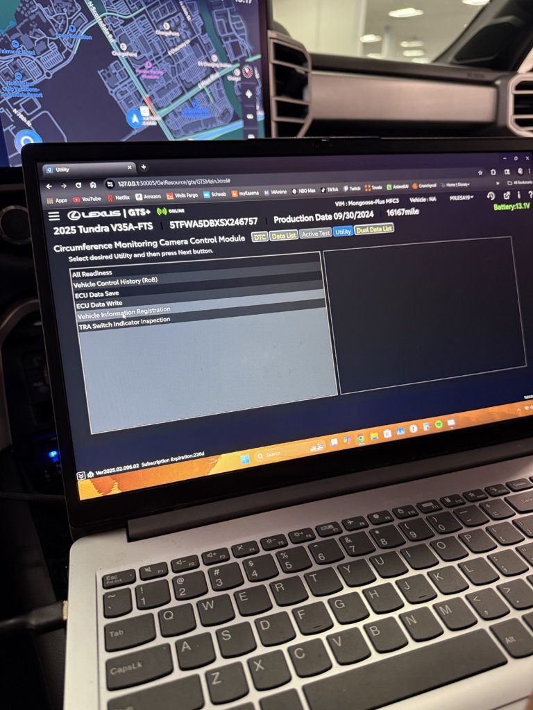

    Step 3: Click on Utility
    Step 4: Click Vehicle Information Registration, then click the “Go” arrow in the bottom right hand corner

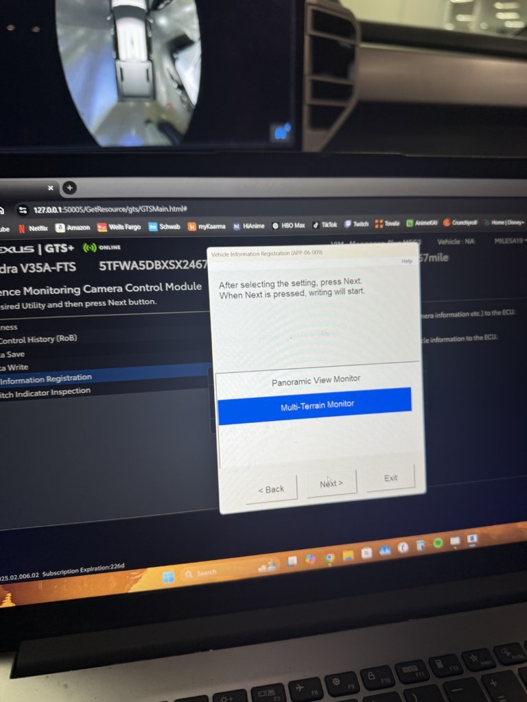

    Step 5: Click Next on the first pop up prompt box, then click on Changing the Setting

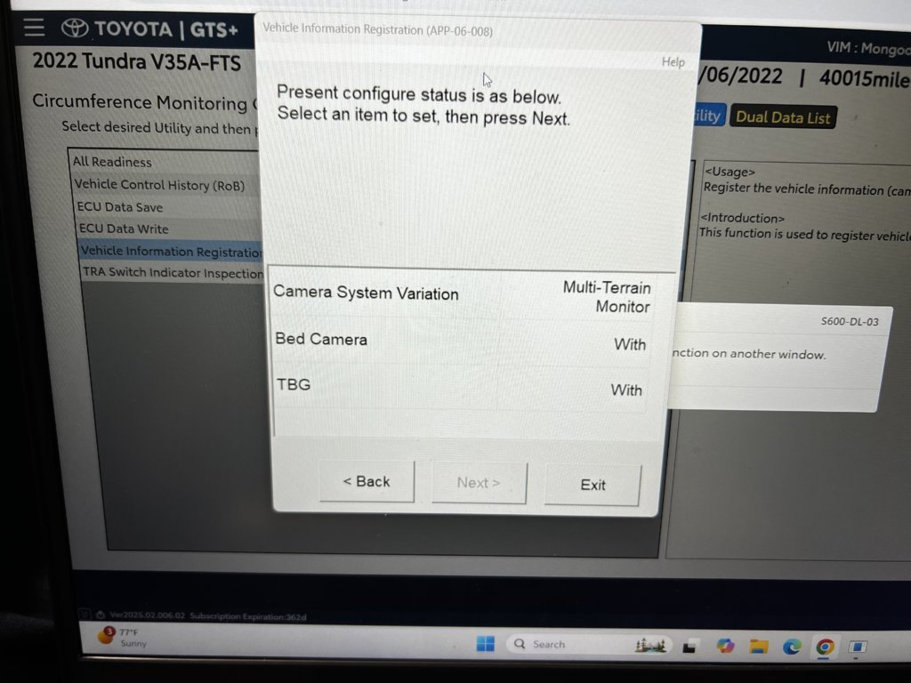

    Step 6: Click on Camera System Variation, where it says Panoramic View Monitor, and you should be given the option to switch it over to Multi Terrain Monitor. Then press next and continue to save your entries.
    Step 7: Click exit! You’re all done!
    Enjoy your new Offroad camera mode!!

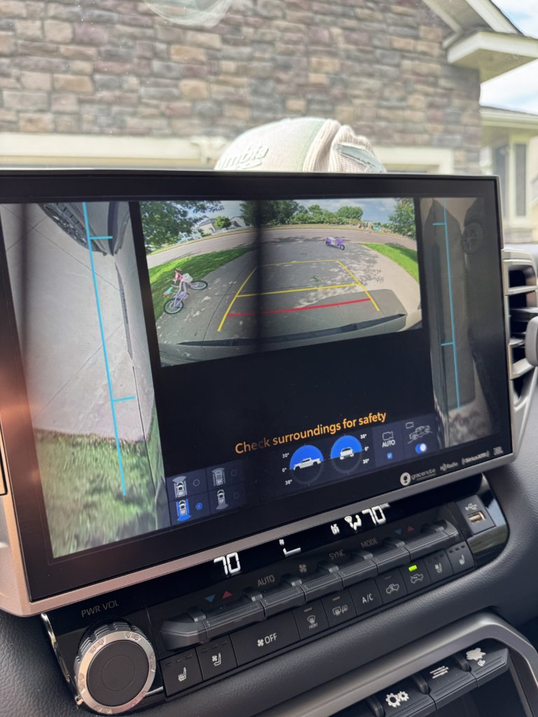

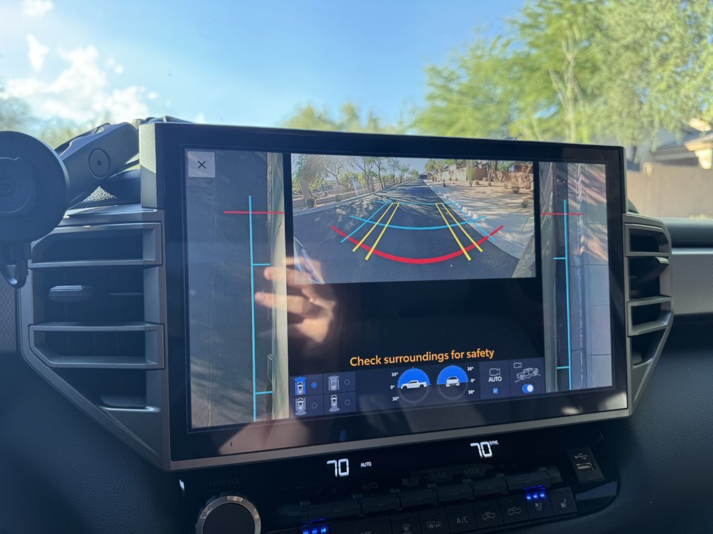

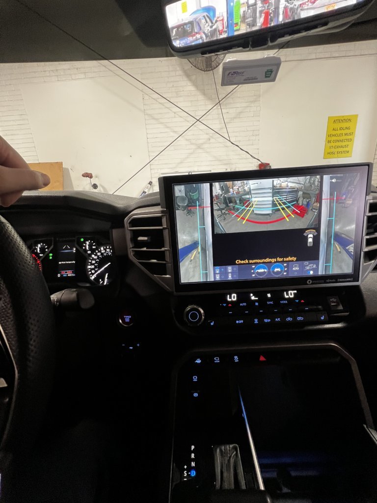

    MTM is able to be toggled on and off once enabled with GTS+, so it’s super easy to switch between the two after it’s done.

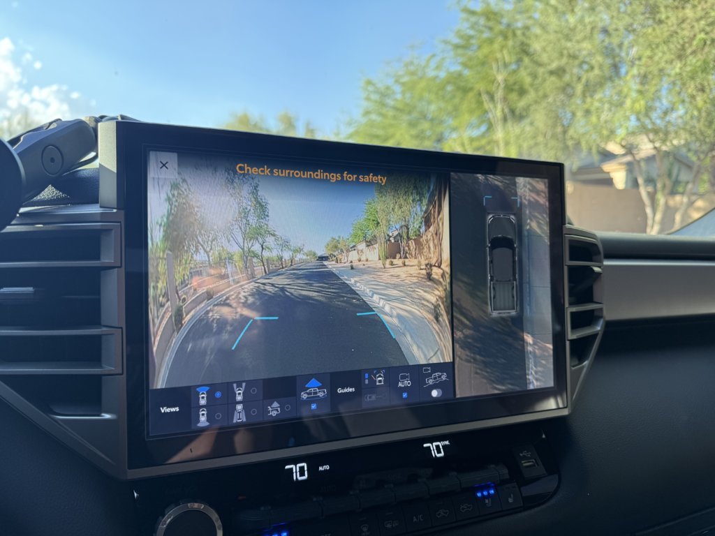

    PVM allows for a basic 360 view while your parked, and while you’re in drive or reverse, it will provide a top down Birds Eye view of the vehicle along with the forward or reverse camera, to aid in parking while below 7mph.
    MTM, when selected on, will give you a top down view on the entire screen, with enlarged side view areas, primarily to be used when rock crawling or on a technical patch of a trail. It allows you to see rocks and such underneath of the vehicle

    There’s an on off switch for it once the camera mode activates. See the pics I posted below the original.
