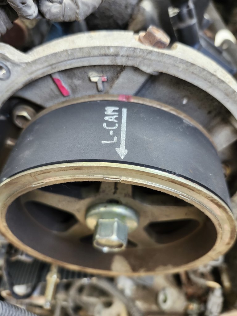

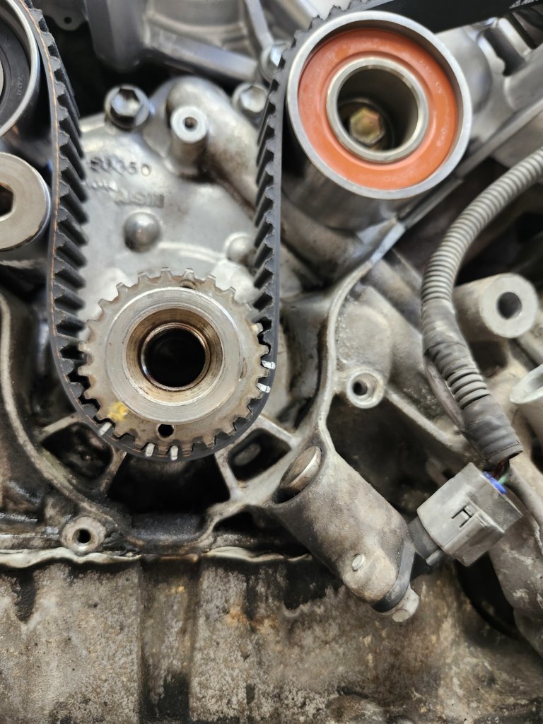

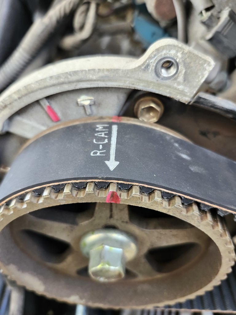

    I'm over the hump on this and very glad I'm learning to do it. I had to order the tool so that I can properly torque the crank pulley bolt but other than that things are going good and I should finish up in a couple more hours of work. I really like how they put the marks on the timing belt so that you ensure the timing is not messed up when you reinstall.

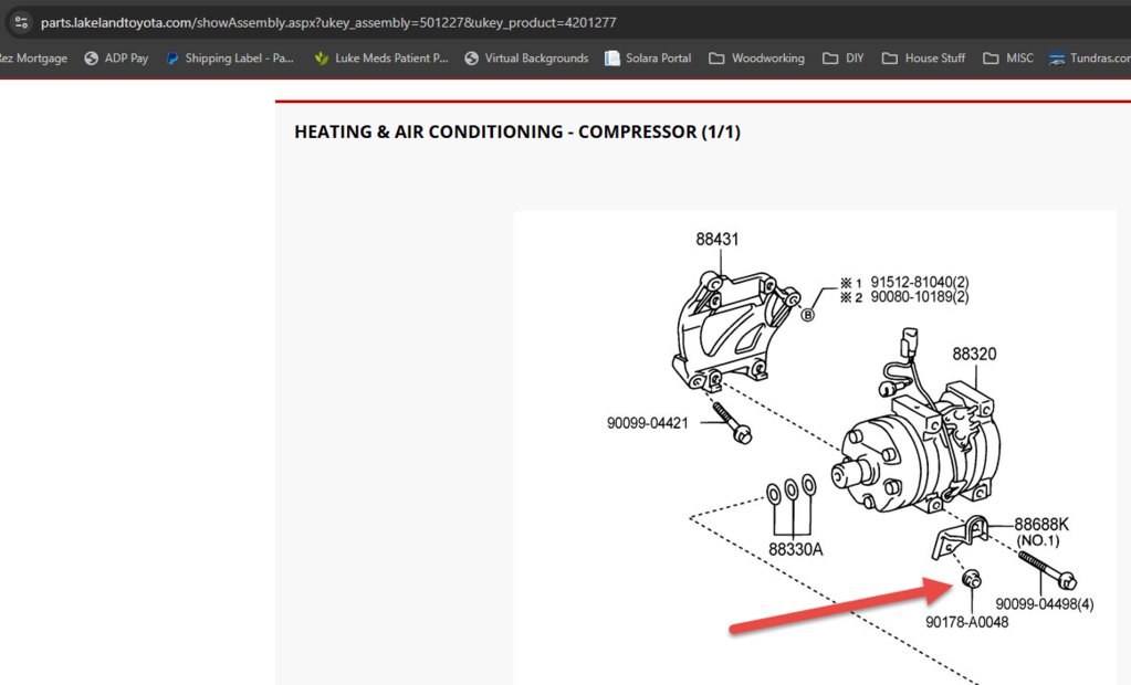

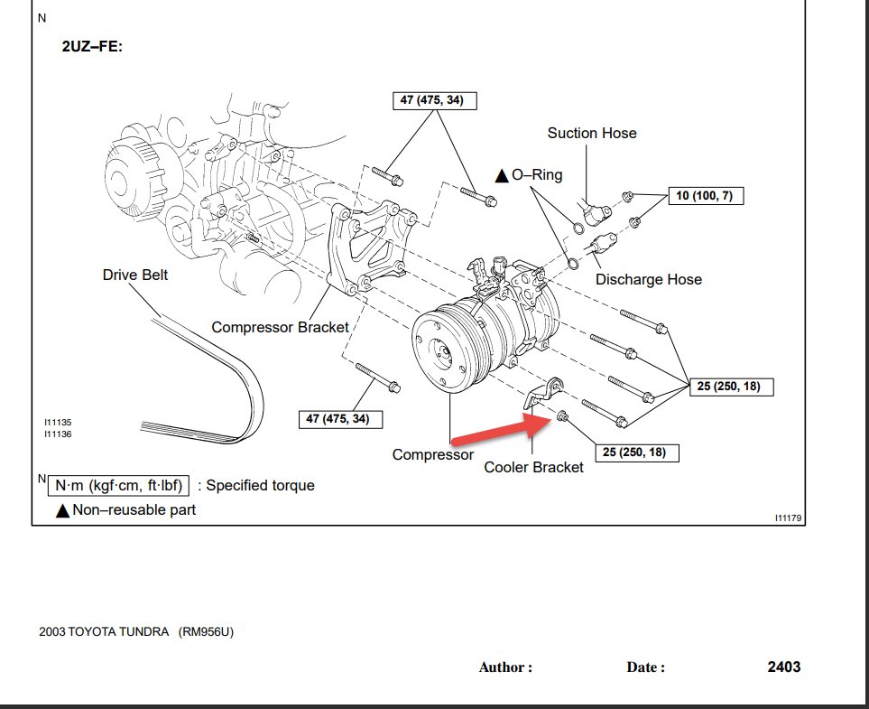

    During disassembly, there is a nut I misplaced on a bracket under the AC compressor. I'm not having much luck on the Toyota parts diagrams. If anyone can suggest a better way to find this let me know. I think its a M12 nut. Red arrow pointing at the item I'm looking for. @shifty`

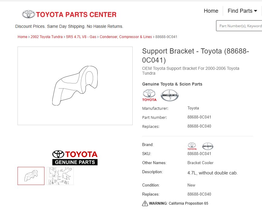

    here's a pic of just the bracket, but can't find the nut. I guess I could call a Toyota parts place and give them this part number and see if they can find the nut?

    nevermind. I guess all parts websites are not created equal. see below

    yeah, I was in there first, but its not entirely clear either. I will keep digging though...
