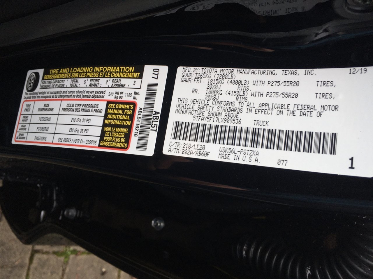

    These are all 2020s and 4x4s. Got these pics while shopping.
    2. SR5 double cab, TRD sport package, TRD sport convenience package, Sr5 upgrade package 7100
    4. SR5 crewmax, TRD sport package, TRD sport convenience package, Sr5 upgrade package 7200
    1. Platinum, w moon roof, 7200
    3. Limited, double cab, limited premium package w TRD offroad package, 7100
    F772FBA0-ABB3-42C1-9DD7-E49BB3CA2AE2.jpg2497C904-F69B-494D-98B4-7E7524303663.jpgF6D0B607-B3BC-47C8-B5CF-FF2843FC97DD.jpg ATTACH=full]385405[/ATTACH]

    My 2016 Limited Crewmax 4x4 has a GVWR of 7200lbs per the door sticker.

    Ok so my 2020 SX double cab 4X4 has a GVWR of 7100lbs. My truck weighs 5340lbs so I should have a payload of 1760lbs. The decal on the door jam says the max payload is 1300lbs. Why a 450lb difference?

    My weight was a quoted 5170 based upon website but at the scales with a full tank of gas, myself carseats and a few oddball kids toys I was at 5740. I weigh about 190 so definitely more than what was posted. Spray in liner is my only added weight from the dealer. No side steps, or anything else.

    I am about 95% sure the specs listed on Toyota's website are without fluids. So a 38 gallon gas tank full is about 310 lbs. I imagine the oil and coolant is probably 40 lbs. or so and that is a guess. So a truck that is listed at 5,200 is probably 5,550 before absolutely any add ons or passengers.
    tractors are like this also. From what I can tell, all are listed without fluids. Anything from sub-compact tractors up to large farm implements.

    I weighed my 2019 Platinum on a certified scale at work about a month ago. It was just calibrated and is certified with in 20 lbs.
    Only thing I added to my truck is line-x premium bedliner, bed mat, and soft tonneau cover. I had 3/4 of a tank. It was 6,120 lbs. without me in it. It was a pretty close representation to a completely stock truck.
    my truck is listed at 5,670 lbs. on Toyota's site. Somehow it magically picked up 450 lbs.
    I also took it across a cat scale and 6,120 is a dead red accurate number.
    I really think they are listed as dry weight.

    The GVWR is 7,200. With me in it it is 6,440 total weight. I only have 760 lbs of weight left with no passengers. If I buy a 3k travel trailer With tongue weight of. 500 lbs. I literally barely have enough room for my wife and 2 small kids.
    This is not just Toyota, but this why the tow ratings are absolutely dang near pointless on a 1/2 ton. You will run out of cargo weight and be over your GVWR long before you hit the 10k towing capacity..... I do not care the make or model the big 3 are similar to this also.
