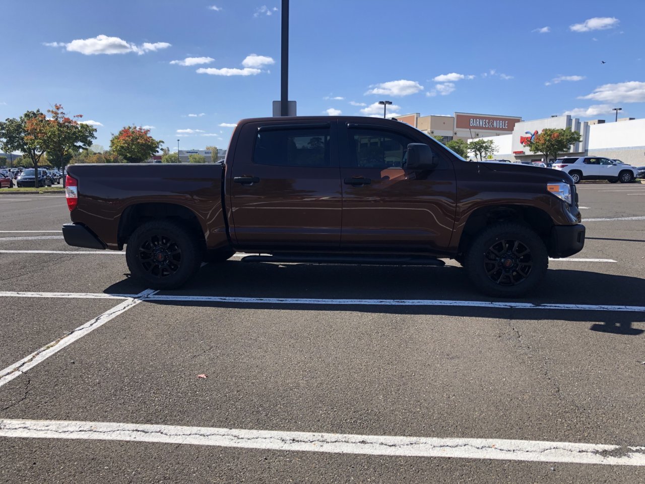

    Trucks looks great. What size wheels are you running?

    King's all around, Dirt Deeds 10" exhaust, 18x9 Method 305 NV, Falken Wildpeak A/T3W 305/65/18 tires, tinted windows (shhhhh)
    I’m running 305/65/18. At the last minute I changed from the 275 tires I ordered. Happy I did!!
