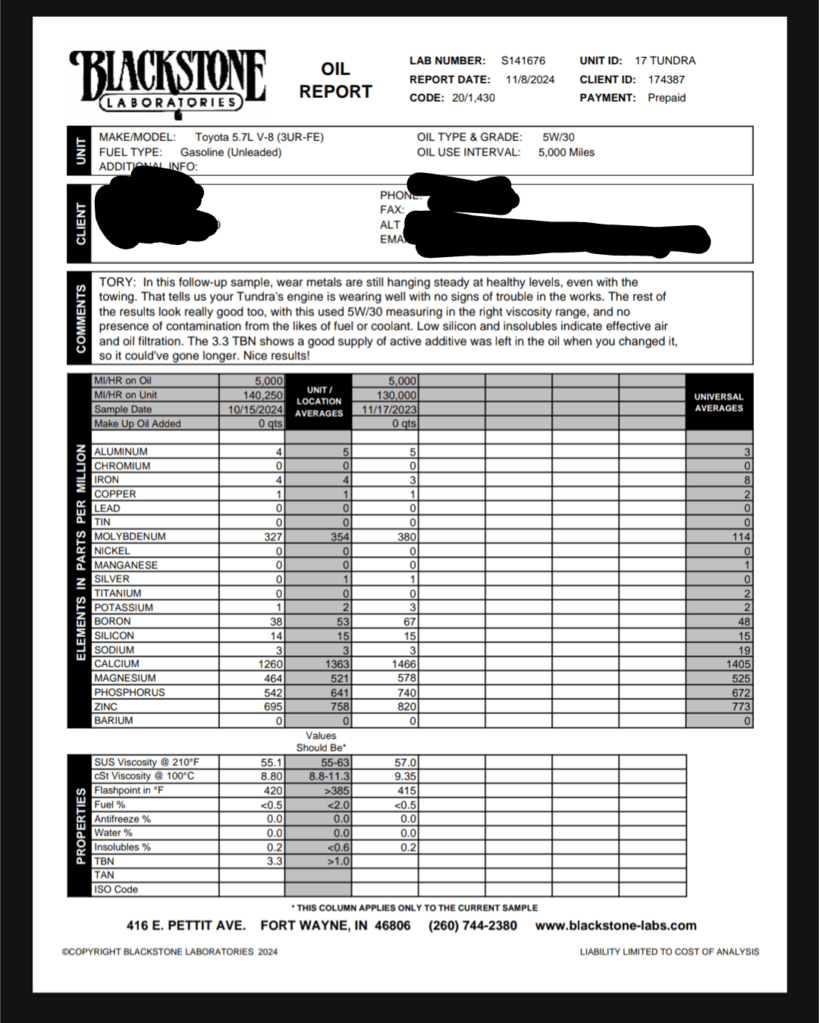

    8qts puts you in-between the low and high marks. 8.5qts puts you right at the high mark.
    2017 manual states 7.9 with filter. So maybe 18 is when they changed the manual? Post a picture of the page!
    ___________________________________________________
    Just to add some info here. I've had my 17 for just under two years now. Always used 5w-30 and 5k changes for 20k miles.
    Below is my last report. 3k of that 5k was towing various weights. Pennzoil High-Milage 5w-30 because it was on sale for $23/5qt and I happened to be at Walmart.
    I could easily extend to 7-10k changes with those TBN numbers.
    ***Note: The engine model is wrong, I have a 3UR-FBE (Flex-Fuel).
