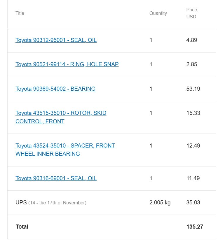

    Hey! My front left wheel bearing recently went out in my 4WD truck. I found Koyo to be OEM and went to buy them and realized I also needed an inner seal and bearing seal. I can’t find where Koyo makes any bearing seals, only the bearing it self. Do all bearing seals that fit my truck work with any type of bearing or do I need a specific kind? TIA

    If you've got time you can go to amayama.com. to save a fortune (although these are pre-tarriff prices - check it first). Regardless, there are the p/n's for my 2004 4WD AC V8

    Ok cool thank you! May I ask what the seal oil and skid control is and if there needed?

    I believe that is referring to the outer wheel seals for the front axle hub (commonly referred to as a Type D wheel seal) while the rotor is designed for Tundras equipped with anti-lock brake system or ABS.
