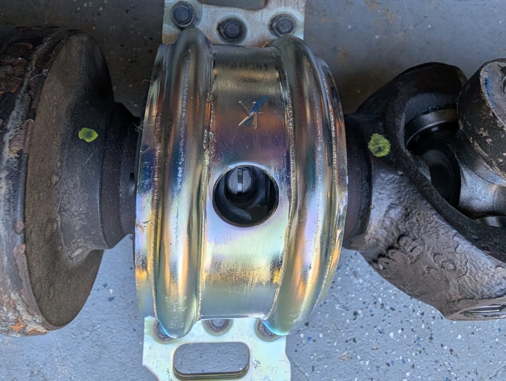

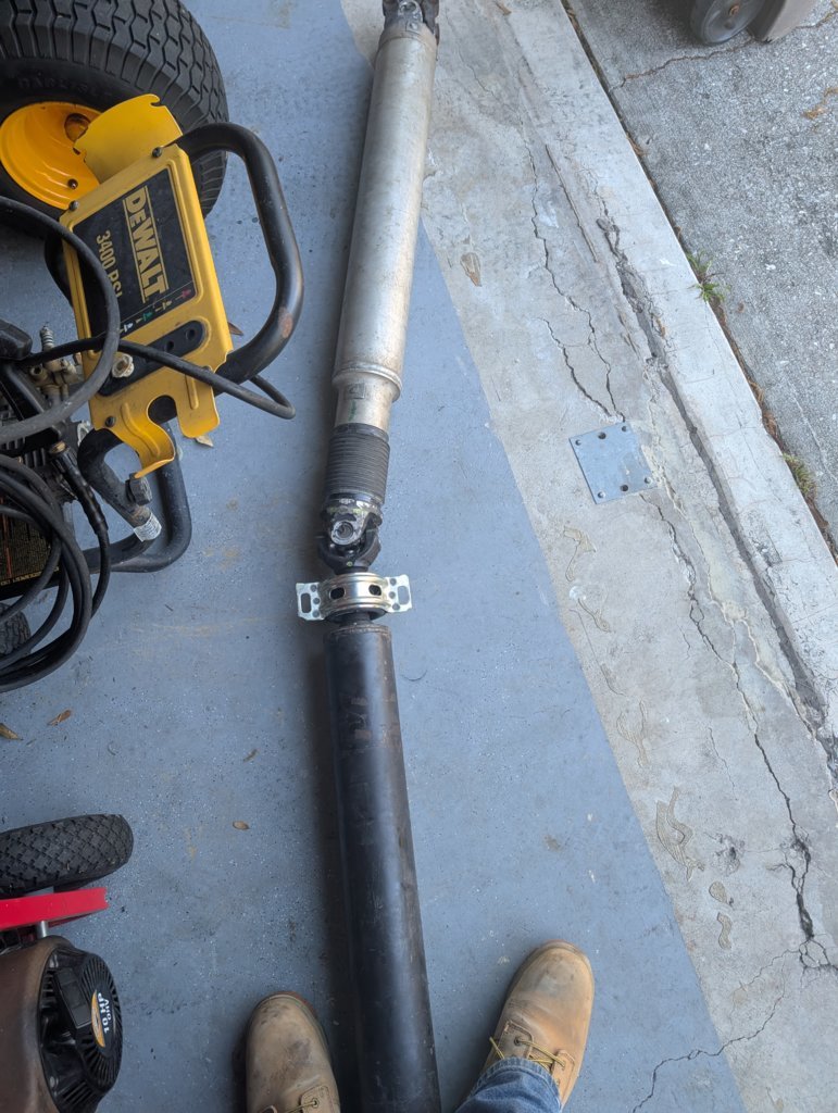

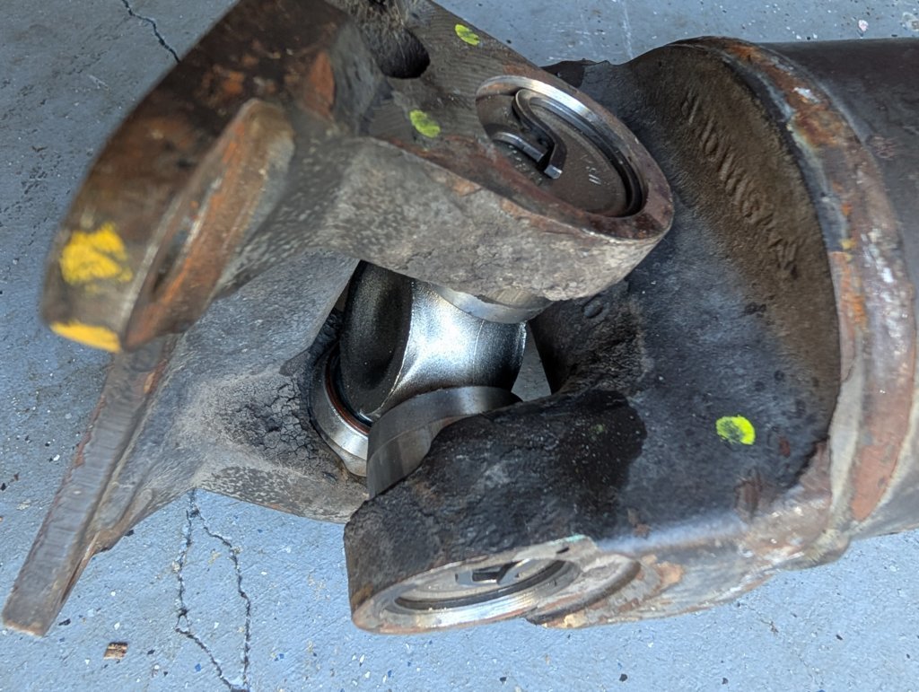

    Pics of driveshaft.

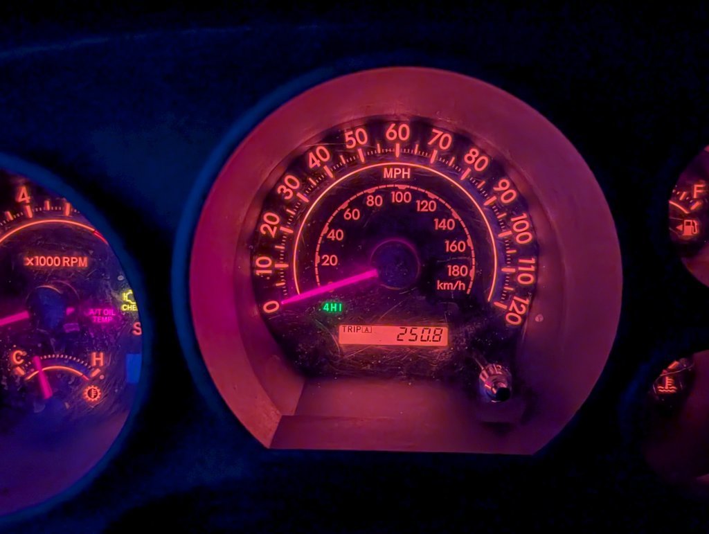

    Holy mackerel, 2yrs with no 4wd and I got it working tonight. Got the 4hi actuator lined up right with the tab to actuate the front. I had made a post earlier with photos where I had switched the gears around and I ended up finding out the gears are different sizes so I deleted to not cause confusion. This caused an issue with the 4lo not to fit down right as there was too much tension from gear to actuator rod. I have not tried 4lo. Was too happy that 4hi works. Found out my newly replaced driver's side CV axle is grinding when turn. It's a cheap one so will get an OEM. Passenger side boot blew out so will do the same on that one. It was all about getting the hi gear in the right position. 2yrs and multiple attempts at aligning. Smh. Toyota couldn't figure out a darn thing with my truck. They definitely don't work on the motors, just replace the whole unit.
