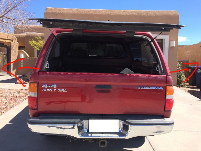

    Alright so an update on my topper situation. The topper has been off the truck for so long (either from me or PO) that sides down by the bottom of the lift glass are bowed out to the sides therefore not allowing the lock to latch properly. I either need to pull the sides back in towards each other somehow or find a way to make the rods longer. Any ideas would be appreciated and I didn't have the time today to snap pics but I'll try to tomorrow.
    Generic pic for reference with arrows showing where my issue is.
    My alternate plan of making the tailgate the primary lock won't work too well either because the lip on the lift glass sticks down too far on the gate to get it to sit behind it.

    Flip her on her back and squeeze her legs together.
    But for real, if you have time, turn it on its side and run a ratchet strap around the shell to shrink the long end of the trapezoid. Sit it in the sun and hope for the best. Although, fatigue might have taken its toll on that old fiberglass.

    Really trying to keep from taking it off now that it's on unless absolutely necessary. Might be able to still wrap a strap around the whole thing and pull those sides in with it on the truck. Good idea.

    If you think they're solid enough to do it, I'd consider flipping it over in the gras, getting a ratchet strap, lock onto the hoops at the bottom corners, and pull them together. Then put it on the truck, and clamp it into place. The clamps holding it in place will do the rest.
    If there's similar hooks or latch points toward the middle, I'd get a tape measure, get the middle to the same width as the part up against the cab, then go to the back window.
    Just keep in mind, you're dealing with fiberglass, so you'll want to work slowly, carefully, and don't go overboard or you can crack it. Proceed at your own risk, use your best judgment, I'm not responsible if you dick something up.

    Gonna try and do what I can with it on the truck later on today. Pulling it together and then clamping it may do some good. I'll give that a shot.
    May have to find some way to keep in strapped together on the trip if nothing else works out. I'll do what I have to.

    I mean, one other option could be, if there's any space for a 2x4 to fit into a groove along the base of the shell and stay in place, you could put one on each side and pull them together But then they'll be in the way of clamping it down once on the truck.

    Thought for sure I updated this thread more recently but I guess not. Put the topper on a while ago and ended up putting a ratchet strap around it while it was on the truck and pulling the sides together in order to get it to latch right. Used the topper clamps and a c-clamp on each side as well just to be safe and its staying perfectly in position.
    Was working great till the rivets that hold the bottom metal part to the glass gave out. Ended up running bolts all the way through it for strength and since I don't have a rivet gun. (I need to take more pics)

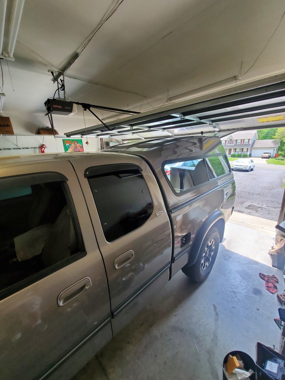

    Truck is in the garage almost loaded up all the way.
    Forgot to mention as well that after leveling the front of the truck the topper now clears the garage door by a couple inches. Topper will probably be staying on for good now.
    Would show where the rivets broke if the picture would ever upload from work.

    Something about no gas door is unsettling to me. Like walking out of the house with no pants on.

    I've got one. Waiting for girlfriends dads 1st gen to get painted (same color truck) and getting my fuel door painted as well. Need to get a lock for it. It's got a locking fuel cap on it at the moment.

    thats a neat cap.

    I think it's pretty ugly. Works good though. If I ever found a regular height paint matched topper I'd be all over it.
