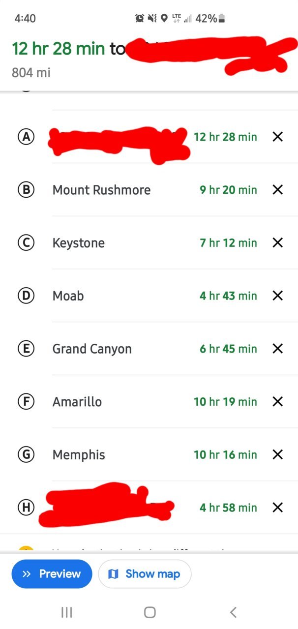

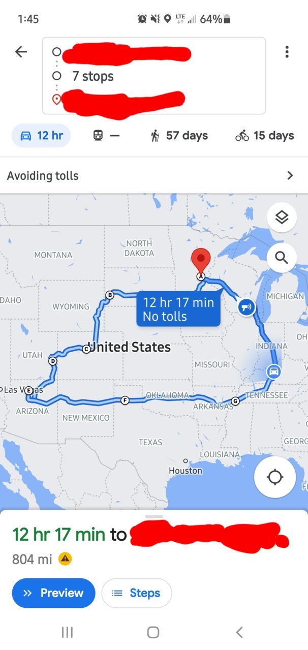

    Maybe this is crazy, maybe stupid but I'm gonna give it a shot. My girlfriend and I are planning a week and a half long 4500 mile trip in May to see some stuff before we get married and have kids and such. Planning to go from KY to see my grandparents in MN then quite a few stops from there. Here's the list.
    And the route

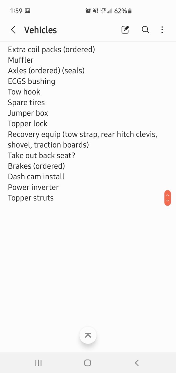

    Trying to make sure I have everything in tip top shape. Timing belt, water pump, radiator, O2 sensors, lower and upper ball joints, and frame (among other things) have been replaced in the last 8 months or so.
    Planning to bring almost everything possible with me to work on anything that may break within reason.
    Current list of things to do with the truck.
    The thing I'm most worried about doing myself is the ECGS bushing but mostly the front axle seals as I'm worried about getting them at the correct depth and making sure the c-clips are set correctly. Any pointers from anyone would be great. Still need to order the bushing and remover/installer (don't really want to rent the on here as I'm not sure when I will be doing the work) and seals. Don't really have any super reputable places around that I know of that I'd want to do this work. Plus I'm gonna be in about $1000 worth of parts just for this trip.

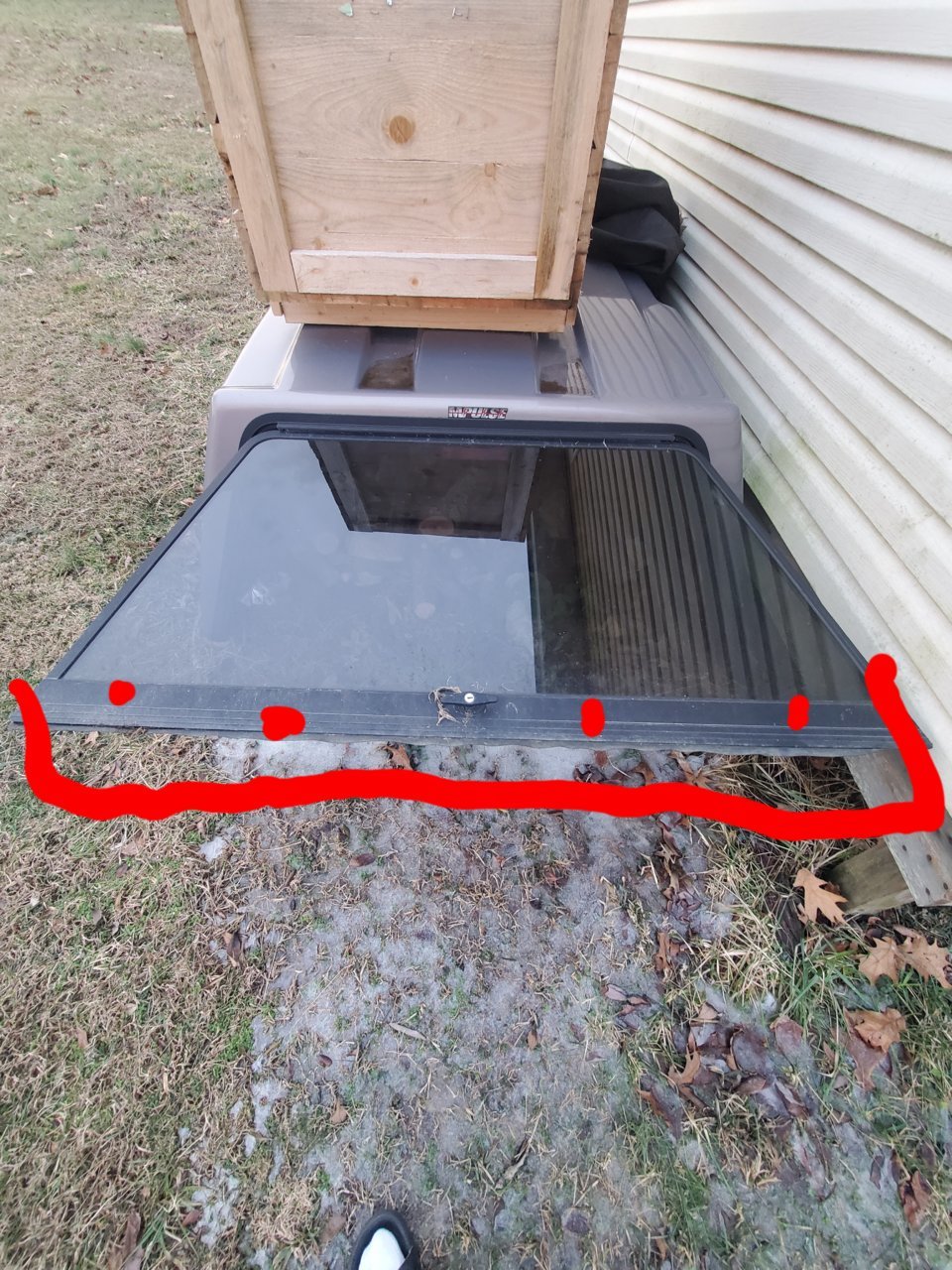

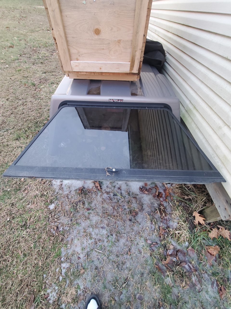

    Other thing I have to figure out is a really good way to lock the rear topper glass even if that means drilling a hole or two in the topper (not the truck). Don't have the key for it and lock doesn't seem great anyway. Wanting some sort of blocking plate that would require the tailgate to be open before the topper can open since I can lock the tailgate.

    Sounds like a lot of fun, hope it goes well! One thing I've come to realize with a topper, and I'm sure you have too, is no matter the work we do to secure them, someone who is dedicated to get in will still get in. The keys are so generic and easy to duplicate.
    I think your idea of blocking the window somehow with the tailgate will make it where it's too much effort to get in and people will leave it alone. Interested to see how you'll accomplish that.

    I had the topper on for about 2 weeks after I bought the truck and that's it. It's pretty ugly although functional but if I have to work on the truck with it on it won't fit in my garage (rear half is extra tall).
    I'm interested to see how I accomplish it myself lol. Thinking maybe pull out the screw inserts for the tailgate metal cover and using bolts to hold in a piece of sheet steel that's bent to fit but that's just a rough idea at the moment. Would only be temporary.

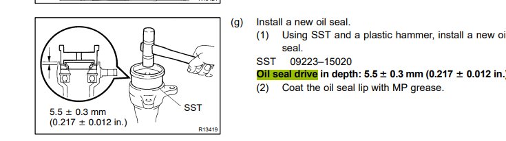

    Don't overthink it. I eyeballed mine and it was fine. It wept oil for about 10 days and then never did it again. I hade a typo above and meant to say it's impossible to mess up the driver side
    See pic, you just tap in until you it won't go any further.
    I believe this is the instruction for the passenger side tube.

    I will just chime in about the Cap though,you can easily get a key for that thing and if it works just do that.
    You can also easily get 2 Cam Locks for each side and drill 2 holes and mount them near the edges instead of in the middle and you can do both and have 3 points locked along the tailgate if you want!
    I also carry Walmart baby blue foam pads that are $7 each and tape them inside the cap in front of the glass so that no one can see inside there. They are also great for working off the ground if you need to and all sorts of other uses and even as sleeping pads which is what they are sold as.

    Oh and @NickB_01TRD fill me in on this cap situation.
    Some things to share:
    The lock barrels are swappable, you can get a replacement barrel with its own key.
    A lot of times the barrel will have a number stamped in the face, and you can get a replacement key based on that number (which is also why they're not as secure.
    You can probably find a more stout barrel, also. Your local camper/shell supply place may know if there's one nearby.

    Sounds like an awesome trip! On the passenger side axle seal, just follow the directions above and it's actually pretty easy. I bought a 2" PVC cap as suggested and then made a sharpie mark at 5.5mm depth. It's been a year with no leaks.

    Well to fill you in it's a cap that fits my truck and is the same color. Ugly and I took it off right after I bought the truck but it came with the truck so I keep it around since I know I'd never find another. It has a number on the key barrel and I'm sure I could get one but it just doesn't seem very secure to me especially when I'm planning to have so much stuff back there which is why I'm trying to figure out a more secure situation hopefully using the tailgate to lock it. I couldn't even tell you if we have any kind of local camper shell place here either. Haven't looked.

    So with the 5.5mm part that means that the back part of the seal should be set in 5.5mm correct? Or does it mean the very front lip of the seal should be 5.5mm back? Also is it a piece of 2 inch PVC or a PVC cap that fits a 2 inch PVC pipe?

    It's measured from the front of the seal because the PVC cap goes around the lip, not on it. (hope that makes sense). I measured from the edge of the PV cap back 5.5mm. I can't take credit though, I think that was @FrenchToasty suggestion.
    https://www.homedepot.com/p/Charlotte-Pipe-2-in-PVC-Schedule-40-Socket-Cap-PVC021161600HD/203811678

    No we will not be camping in the truck. Hotels or air BNBs and such. I tossed around the idea of it but it's not her thing and I respect that of course.
    Tailgate has lock from factory yes. Thinking of just mounting some sort of metal bar to the topper bottom that will hang down low enough that the tailgate will have to be open first. I just have to wait till closer to time to leave since I can't fit the truck in the garage for maintenance stuff with the topper on.
    Half ass quick drawing but the metal bar would mount to this bottom plate with bolts at the dotted spots and be on the inside of the topper.

    Well now you have my attention at least.
    The topper rear window closes against the outside of the tailgate and your bars will need to close inside the tailgate if I am following you?
    So how are you going to close the whole thing and have the tailgate end up between the bar inside and the glass outside of the gate exactly?
    You could just drill and install these on the back window and keep it simple.

    Close topper glass and bar will hang below where tailgate will go then once tailgate is closed that bar will be pushed right behind it not allowing topper to be open. Like I said very rough idea and only has to work for a week and a half.
    Could also just use 4 or so smaller pieces instead of trying to get one big piece of metal.
    Really just trying to go with one key easy locking if possible but I'll keep those lock latches you linked in mind.
