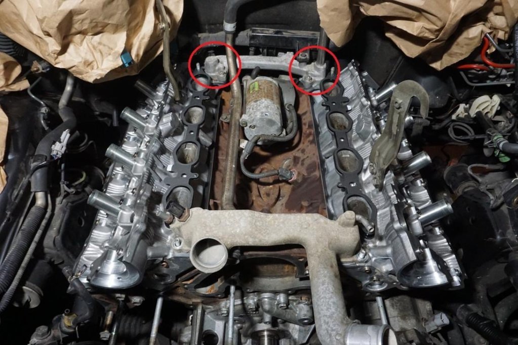

    If these people don't specifically deal with Toyota, the 2UZ-FE is a very well known engine. Over here in this "everyone should read this" megathread, we cover the most common leaks, in the event you want to look yourself. I'll paste this here, but just know: It's 100% normal to find crusty (usually pink crusties, if the correct coolant is being used) buildup around some joints. Less-scrupulous shops could/will use that as "evidence of leakage". It's 100% not-normal for the "heads to leak" on these trucks, much less blow a gasket, even after an overheat. And, as your keen deductive skills have already detected, you're not losing coolant, so you properly spotted the con. Anyway, poke around, and see if you can find leaks in any of these spots. Most are a very cheap fix.
    • Coolant leaks: Common sources here...
      • At/around the thermostat housing. Check this out, and alternately see this post is for leaks at t-stat housing/inlet neck.
      • The rear-to-front coolant bypass tube along bank 2 under the intake (video fix).
      • The coolant bypass housing between banks at the rear of the block (pics/info).
      • This reply contains links to three other off-brand/odbball leak cases.
      • For radiator leaks, this is one example of a tiny one - always replace with Denso brand radiator, and know different cab types use different sizes, careful where you order, scAmazon especially tends to deliver damaged products often (RockAuto has a spotless record with forum members). Proactive radiator replacement is wise. The transmission line routes through the bottom of the radiator ... go look up "pink milkshake", it happens in these trucks.
      • Here's a list of all things to check if you're losing coolant mysteriously, but you're not seeing white smoke/smelling sweet exhaust out of the tail pipe.
    PS - find a new shop. Toyota specialty shop is best. But go in prepared. We have a lot of the info you need to arm yourself with right here in this forum and can provide a sanity check if you upload pics using the 'upload a file' button.
    PPS - If timing belt was done that recently, it's worthwhile to verify the crank position sensor wire harness was routed correctly, behind the bracket, this is a common mistake to leave it in front of the bracket, where it gets nicked by pulley/belt. Sometimes the camshaft position sensor under the driver timing cover gets pinched by the water pump too.
    PPPS - on the leaky steering rack, can you get a visual on where it's leaking? Sometimes using a seal conditioner like AT-205 in the rack (add 3-4oz max) and driving around will refresh the old seals and quell leaks. It's not a "magic in a bottle" product, it just contains the same additives most oils already have when new, additives your fluid has likely exhausted a loooong time ago.
