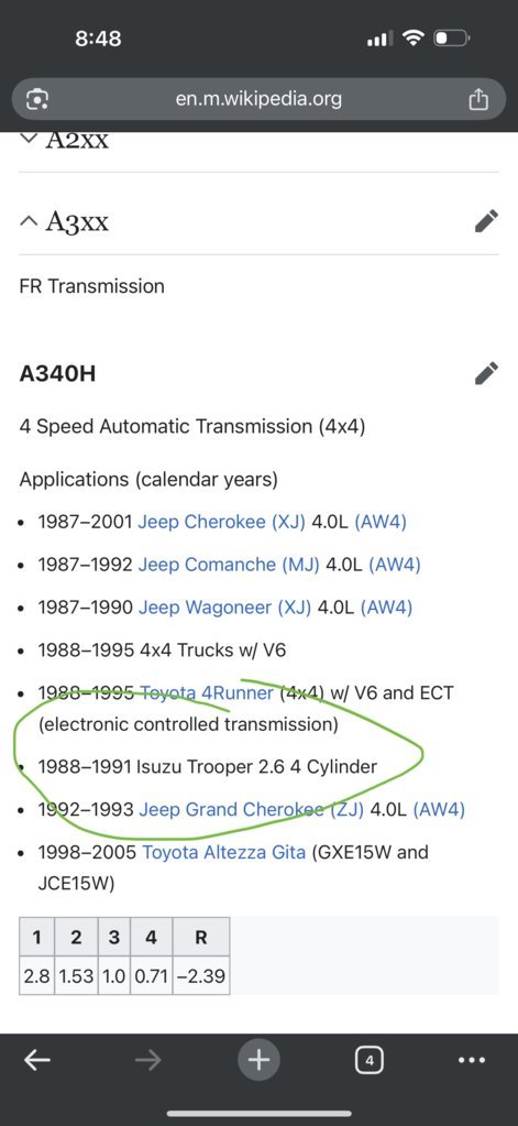

    This. I had a 2001 Isuzu Trooper that made an identical noise. It turned out to be a spacer that was missing in the TC/flex plate area. It eventually took out the transmission. Different beasts, I know. But, damn, I recognize that whine.
