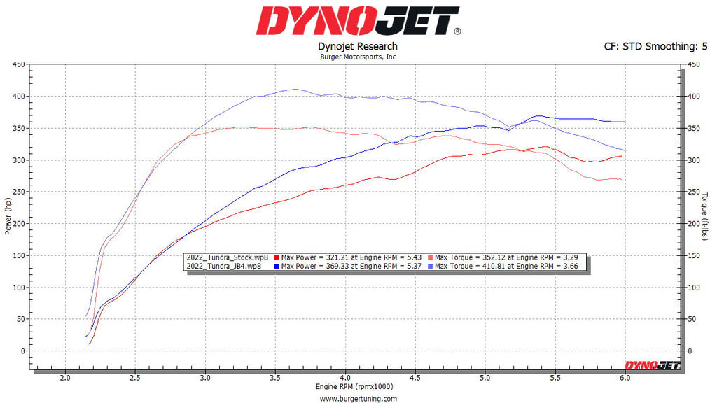

    Any dragy results with 0-60 or 40-90? Dyno info with a JB4's added boost?

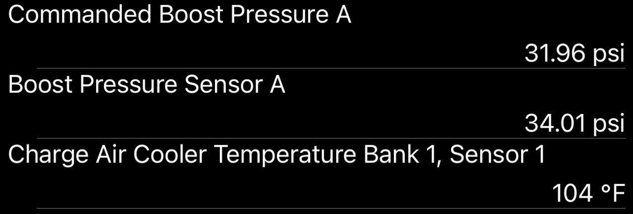

    Their lowest boost is 3.5 psi higher over stock. Stock boost is 20psi already (see below), which is really high for a stock truck. I think Ford Raptor Ecoboost has 18 psi stock.
    This company advertises boost of 6.5 above stock, which will put the value at 26.5 psi at least. That is nuts! Even 23.5psi will be pushing reliability, unless this engine proves to be a sibling to the 2JZ, which I doubt.
    This is my recent acceleration in sport mode. Absolute boost is 34psi with 14psi barometric pressure. Final boost from turbos is at least 20psi.

    What are you using to measure boost? Looks like an app correct?

    Isn't that boost reading also including ambient pressure? I haven't see anything above 16psi

    I’m at sea level here, “ambient pressure” is about 14psi. 34-14 is 20psi of turbo boost

    Obd2 reader.

    Idk what to tell you, im also at sea level...I don't see 20psi in my data logs at all... not even spikes. I'm running one of their higher boost tunes and I'm not getting those numbers from their data logs. I'll try hooking up my torque app and will compare numbers because something isn't making sense here

    Is Boost Sensor A the manifold sensor or a sensor prior to the throttle body? The Ecoboosts have a TIP sensor just before the throttle and a MAP sensor on the manifold. Its not weird to see significantly higher boost at the tip sensor.
    I’d be kind surprised if they were really hitting 20 psi.
    You wont see the actual boost the JB4 is making since its spoofing it. As far as the PCM is concerned, your only at stock boost levels.

    Just got confirmation from BMS that Boost and Boost 2 are actual psi readings and ECU Psi is what the truck thinks it's making. Ive been reporting "Boost" figures from the JB4. So having cleared that up, my statement still stands. I am not seeing anything close to or over 20psi.

    Do we know what Boost Pressure Sensor A is from the post above? I assume there must be a Sensor B as well.
    Ford has the TIP sensor(Throttle Inlet Pressure) and the MAP sensor(Manifold Absolute Pressure). They look identical and both report absolute pressure. One reads the pressure just before the throttle plate and the other is after the throttle plate. The tuning in the Ecoboost actually demands a specific pressure delta across the throttle pretty much all the time. During throttle tip-in, there is usually a pretty decent boost spike as the turbos spool up super quick. To compensate for that the PCM closes the throttle plate to limit flow and boost into the manifold, this results in a decent sized pressure delta between MAP and TIP and im sure it could get up into that 20 psi range.
    Just thinking out loud that Boost Sensor A might be the Toyota version of the TIP.

    Can you take a look at the PID code for "Boost Pressure Sensor A?" Since you're using a 3rd party app, we might not be comparing apples to apples here.
    What app are you using?

    20psi is right at the turbo, it's about 2 psi lower at the intake manifold sensor.

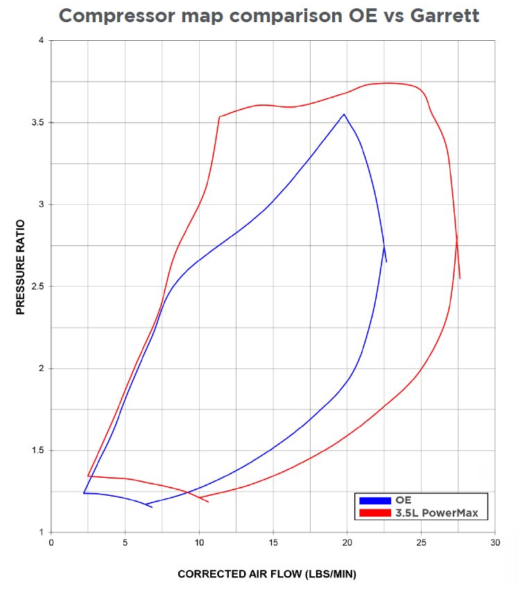

    That I would believe. 18 psi to make 480 ft-lbs. I think my 2014 Ecoboost hits 14-15 to make 420 ft-lbs but it tapers off pretty quickly down to like 10 by 5500 rpm.
    20 psi isnt bad for the turbos. These are the compressor maps for the Stock 11-12 Ecoboost turbos and then Garrett Powermax upgrades. 20 psi is only 2.36:1 pressure ratio. The turbos can hit that no problem. Im sure the Tundra is similar.

    A/B might be bank 1 and bank 2?
