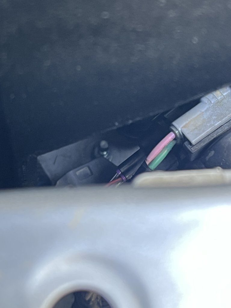

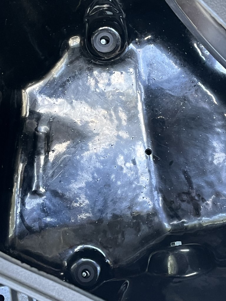

    Took about 2.5 months to receive the S&B kit and another 2-3 weeks until I had time to install. Overall I am not impressed with the fitment of the passenger side.
    The bracket exterior of the box with the grommet to set it in place misses the prong(?) by probably 1.5” so it was either set the box on 2 of 3 or set it on 1 of 3. There is a lot of space between the exterior of the prongs and interior of the grommets.
    The bracket to secure the intake tube doesn’t attach to a damn thing. Once it is secure to to the tube, it just kind of floats and I have no way to lock it down. It’s holding on with thoughts and prayers until I hear something from S&B.

    the bracket probably wasn’t installed correctly and or the tube not rotated all the way to line it up. It definitely could have benefited from a longer bolt for ease of install but it’s likely an alignment problem if he’s saying it bolted to nothing.

    Exactly....if the box wasnt aligned right at the 3 studs, then it's likely that the bracket at the VC was off as well since the intake tube goes into the box, or like you said...its not rotated correctly.

    Bracket was installed as directed by S&B instructions. I probably won't have much time to get back under the hood until the weekend, I'll just be checking periodically throughout the week to make sure everything is still secure on the passenger side.
