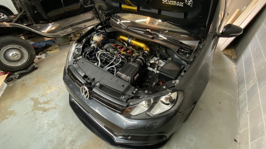

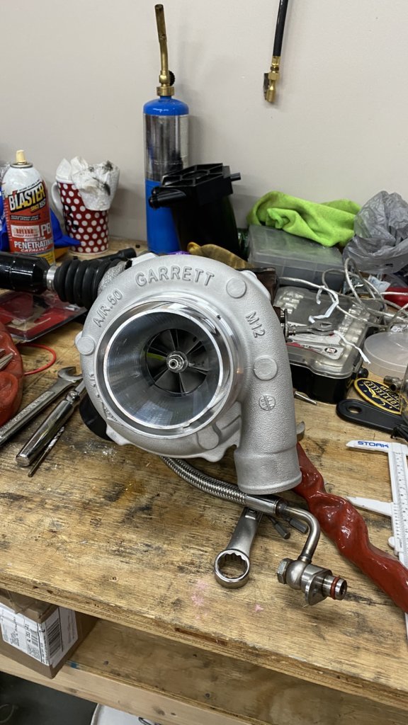

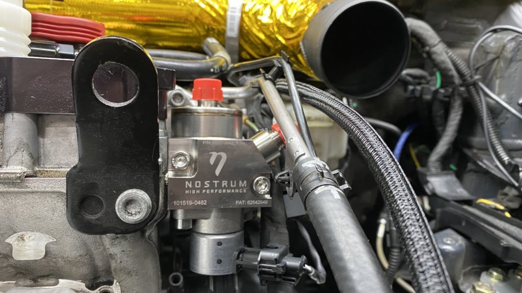

    Just so you guys don't think I'm talking out of no experience.
    I spent the better part of 10 years building my 2012 GTI into something ridiculous.
    This was all done through Cobb AccessPort and Eurodyne software (two different iterations).
    Car made 403whp on 93 pump and 440whp on E30.
    GT3071 and all supporting modifications. Ran methanol injection for a while, then upgraded to a whole Direct Injection setup that replaced the OEM stuff.
    datazap.me | Abowers2887 | E30 V1.1
    You can check out pretty much all my data logs that I used to tune with on DataZap.
    Just some context on this.

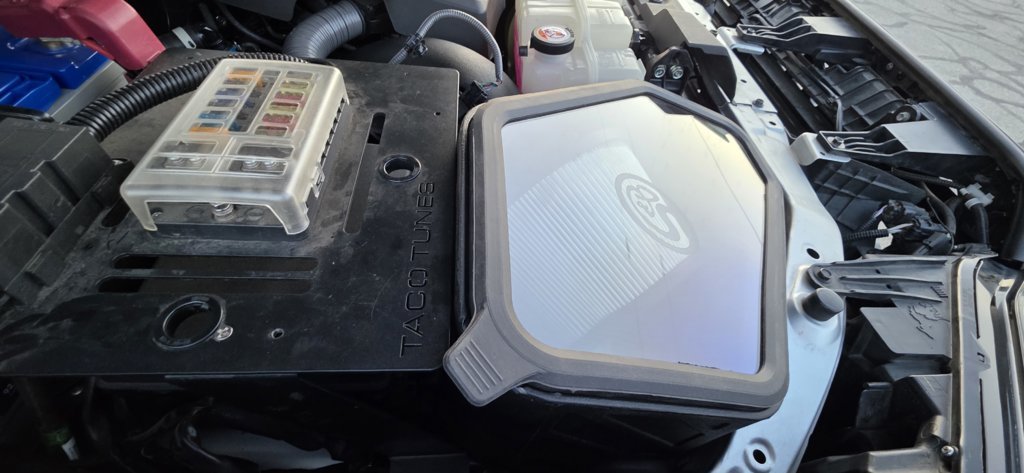

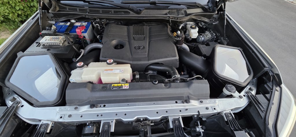

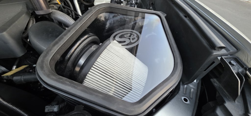

    S&B owner synopsis:
    Install difficulty: 5/10 due to small/short bolts for brackets to mount the intake tubes. Not really needed though so you could probably omit. Total install time maybe 2 hours
    Sound: mild increase over stock, more noticeable in 2k-3k RPM range
    Gas milage: decrease of 0.5 MPG
    Power gain: ??? Butt dyno modest difference in low end but increased responsiveness
    Cons: bulky filter that’s going to be a pain to swap back out, bulky overall box
    Feedback: coulda made the design smaller and used smaller filters if no sacrifice in power
    overall: happy with price, happy with aesthetics and overall fit (minus the brackets) and would say some power gained just not sure how much. Would recommend to others. Oh and I got oiled filters cause I’m not a believer in running in dry…
    Prior to S&B, I had TRD pro air filters which I don’t think did anything TBH

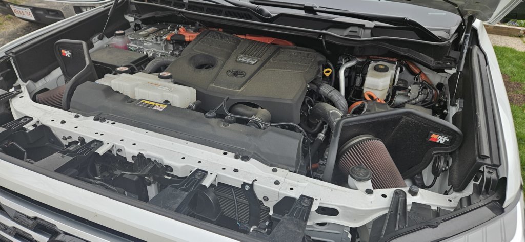

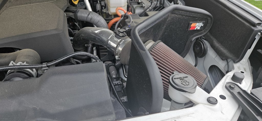

    K&N
    Just over an hour to install, drivers side took the most time due to close quarters,but overall very straight forward.
    The hardware is solid, chrome plated over aluminum with SS hose clamps.
    Sound is night and day you can really hear it spool up,it sounds way better.
    No dyno test so I don't have any proof of HP gains.
    Gas mileage N/A due to bigger tires.
    Pros:
    I absolutely love the sound of it,when getting onto the HWY and you have the roof open back window dropped and you lay into it while driving under a overpass,man there's no better sound than those turbos.
    Cons:
    There's zero box housing just a shield, so deep water puddle bouncing I'm 100% reluctant do so BC to potential water coming in through the hole in the quarter panel, and they are wide open in the engine bay so ambient temps are getting sucked which equals no bueno.
    I do like the newer encased design thou.
    Maybe if I trade her in and get a 25 or 26 I would get the housed ones...

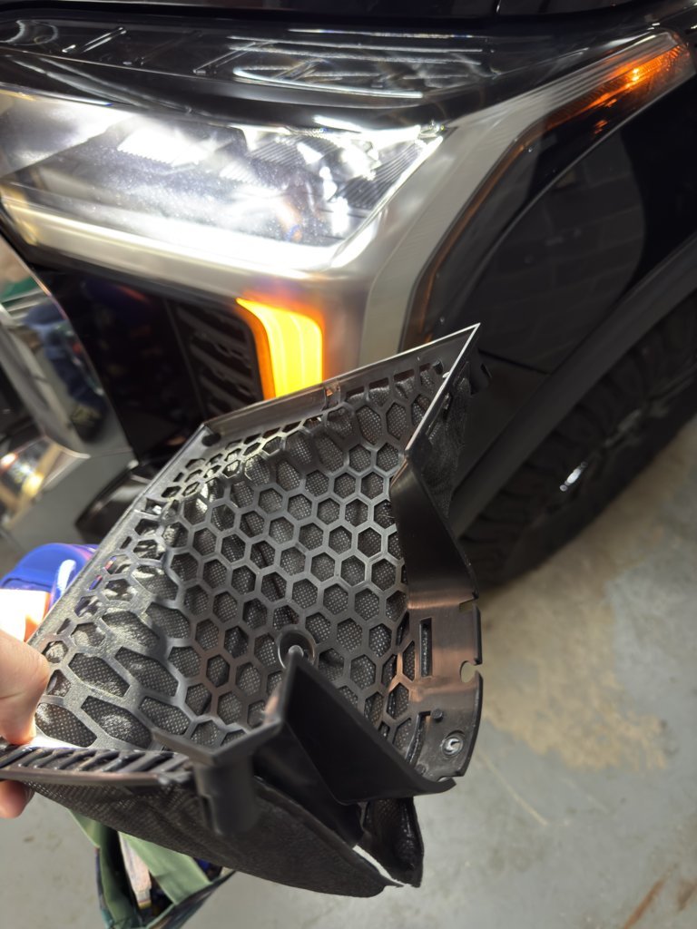

    There is something to be said about overall sound on these intakes. I'm personally running the OEM TRD Pro panel filters, with the snow/water grates removed. These are sound deadeners that they put in the boxes to reduce NVH (noise, vibration and harshness) from the induction tract.
    Wont be anywhere near as loud as the open elements, or even the aftermarket closed ones, but it does allow a bit more spool noise.

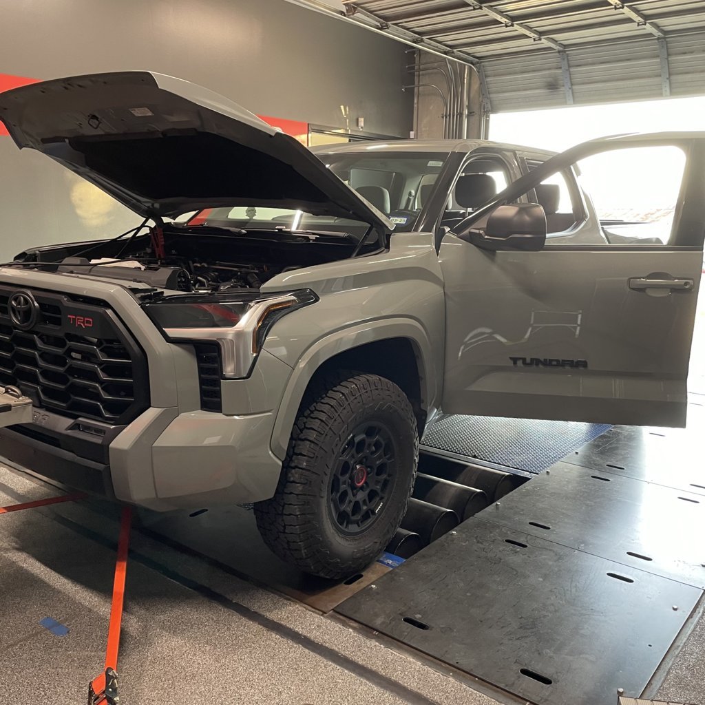

    7th gear is 1:1 and you will hit the speed limiter before 4k RPMs. It’s the same problem I ran into so the graphs/readings were all jacked when I got my truck on the dyno

    When I was dyno tuning the Tundra, 7th would hit the speed limiter too quick, so 4th seemed to be the best gear for dyno runs. I adjusted all the transmission tables. All 18 shift sets with all 10 upshifts and all 10 downshifts so I can lock the trans in gear without downshifting.
