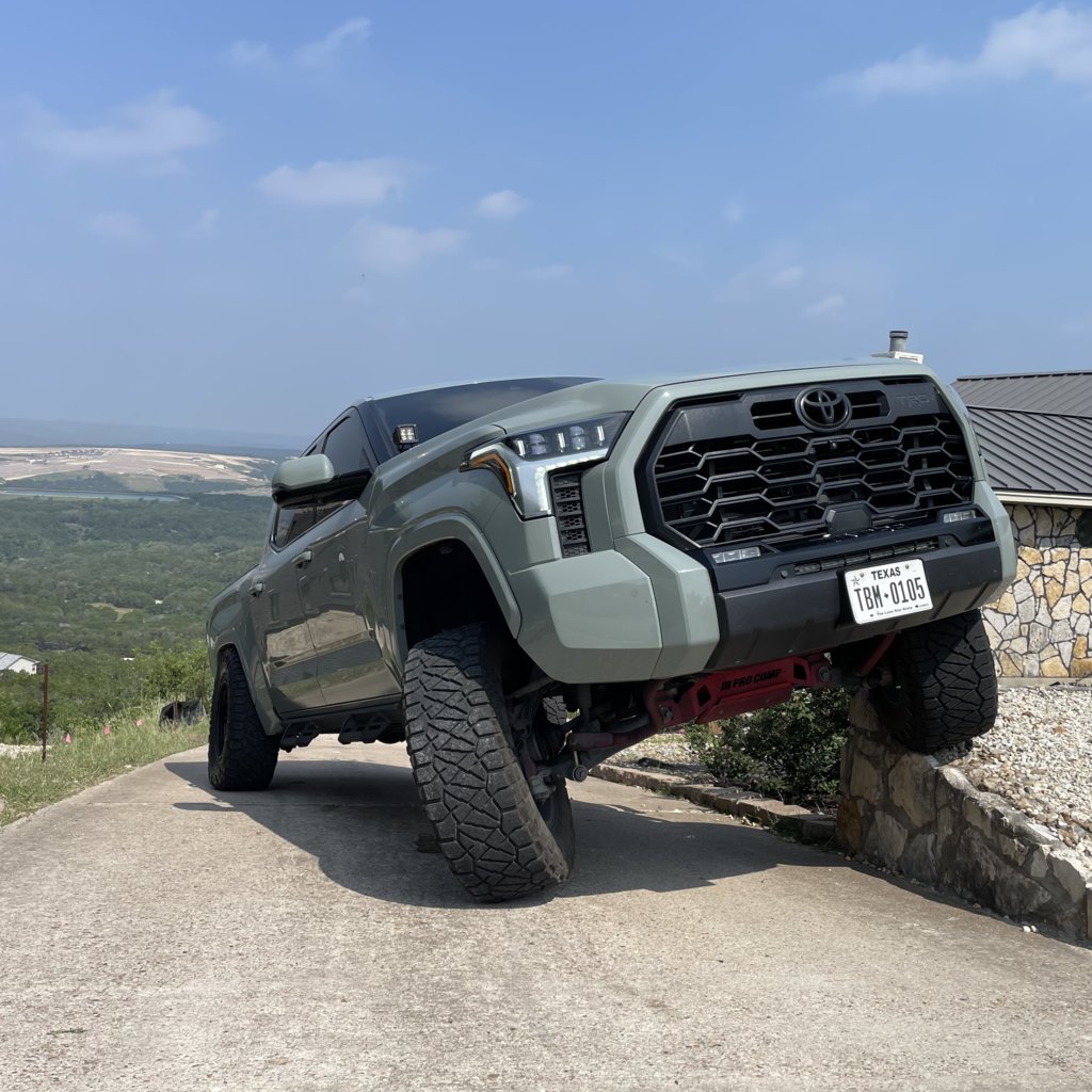

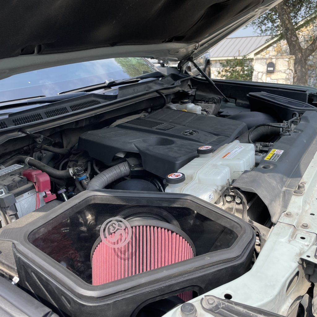

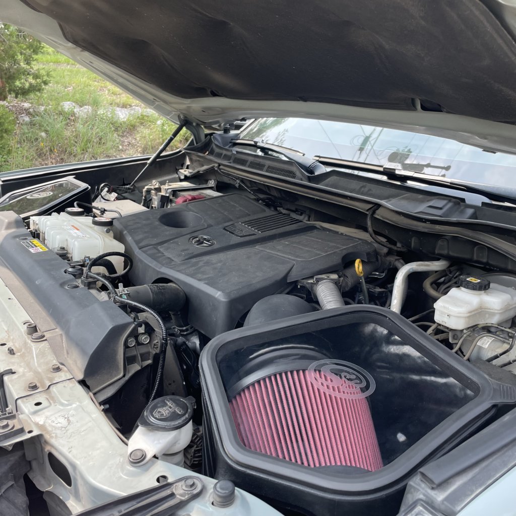

    Man these things are bad ass.

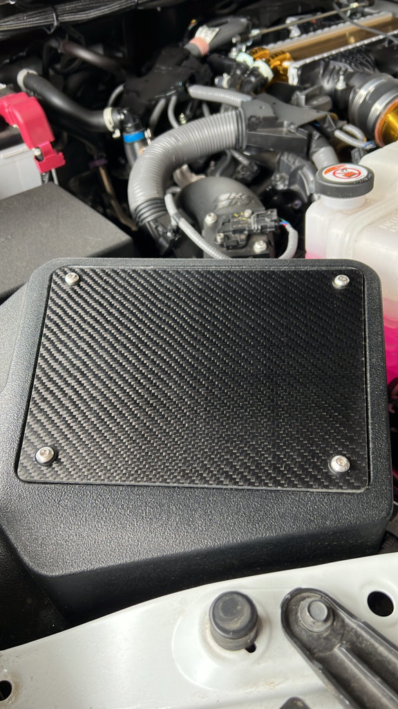

    This isn’t a sealed unit. Theres a foam sheet underneath the honeycomb cover. If you want it sealed you can sandwich something solid between the filter housing and cover.
    I had a carbon fiber cover made, so it only draws air from the fenders.

    Wonder what the airflow change would be with it covered vs uncovered.
    Granted I'm not a fan of engine bay air intakes (at least the suction portion), do the benefits from flow outweigh the downsides of temperature?

    Little to none. There's a large opening on the side that draws in plenty of air through the fender opening to make it a non-issue.

    Your right your right. Just looked at the photo again there is a mesh filter on the top of this one. Which you could do a plexiglass cover.

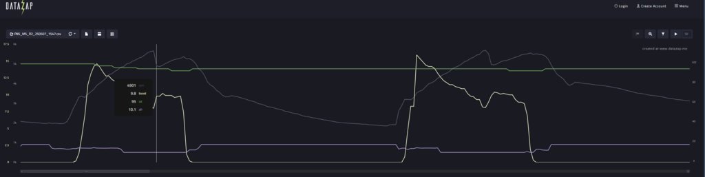

    They are now...AITs stay same or drop a few degrees after some pulls...again, I dont think these really mean anything....I want to know post intercooler temps
    https://datazap.me/u/eddiefromcali/log-1749834793 look at the log ending in 1709

    With them being as stable as they are in that log, and show a decrease in temperature, Im willing to bet that is the post intercooler temperature that is used for load calculations.
    Air to water intercoolers behave (IMO) significantly different than your traditional Air to air bar and plate unit.

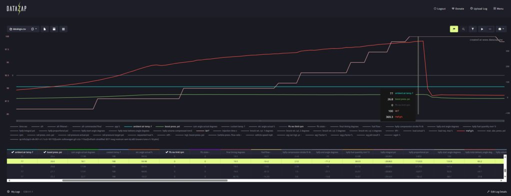

    I saw the same thing with my Cruze...even with a bigger intercooler, my temps kept creeping up and up. We were pushing the turbo a bit too much, imo....even on full E85 it was getting a wee bit too hot and density probably took a dump.
